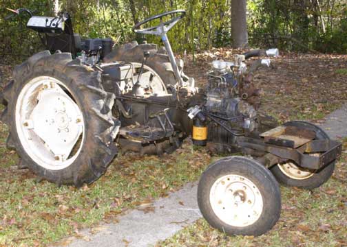

I just found there's a button under the dash - what's it for?
Also, what does the button/switch that the clutch pedal engage do? Mine isn't wired to anything. And what about the three red lights on the dash - I only have one that lights on start-up.
And I didn't know there was a need for a horn on a tractor.
As you might of guessed I've taken the dash off - doing some rewiring and painting everything. Pics soon.

I don't know about the button under the dash, but the switch at the clutch pedal is a starter safety switch. When properly installed, it prevents the starter from cranking the enigine unless the clutch is depressed.
The dash lights are for oil pressure, engine temp, and charging.
The horn is actually used to call cows. :eek:)

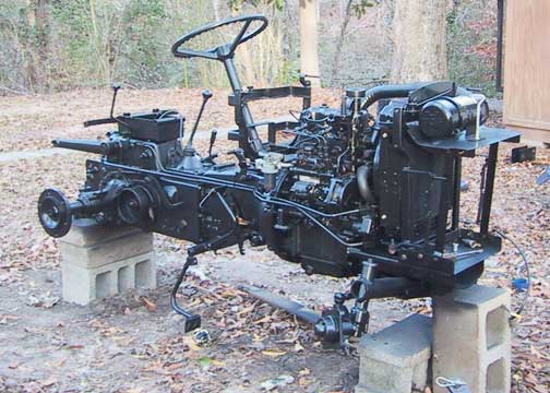

Here are a couple pics stripped before and after paint. The body paint is finished too but don't have pics yet. I went with a darker blue. Today a friend redid the Iseki decals and hope to have it together later this week.
