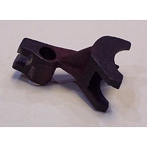

Hi All,
Just broke the 1st/Reverse shifter fork in my Farm Pro 2430 transmission. Very interesting break as it allowed the tractor to be in two gears at once! (By the way, it doesn't budge in this condition) I took the top off the transmission and found the offending piece jammed into the gearbox. After a little rocking and gentle coaxing, I got the broken piece out, but for the life of me, cannot figure out how to remove the remnant on the shift rod and install a new fork. Does anyone know if I have to split the tractor to pull the shift rods (that the fork rides on) or is there an easier way?
By the way, once I got the transmission out of 1st and fourth at the same time, it drove itself very nicely to the barn. For anyone who is interested, the spinning gears sling grease EVERYWHERE if you leave the top off the transmission! /forums/images/graemlins/blush.gif
Thanks in advance for any tips on replacing the shifter fork.

Dont remember on that specific tractor, but usually you can drive the roll pin out then slide the rail forward or rearward until you the the piece out. When you see the forks, you wonder why they don't break/bend more often. Kinda negates the "chinese soft steel" theory, except maybe in your case, since you broke on /forums/images/graemlins/tongue.gif
/ Busted Transmission Shifter Fork #3
The shaft will slide out towards the back if I remember right, we have the replacement forks in stock

Once the shift rail (rod) gets past the detent, it will hold the detent ball in its bore, unless you pull the rail out past that point. But that won't help you find the gear that has a gap in its smile. To change the gear will most likely result in pulling the transmission section.
/ Busted Transmission Shifter Fork #7
Well if I am interpreting the drawings correctly, the ball/spring detents on the shift fork rods are in the rear wall of the transmission Gearbox. Along the top rear edge of the gear case where the top cover bolts on, you should see 3 holes in a row, one above each rod. These holes pass through the holes that the shift rods ride in and down into the rear wall of the gearbox. Into these holes are placed a spring with a ball bearing on top. The spring and ball are compressed from the top with a punch or small rod and the shift rod is inserted over the top of the ball. You would have to completely remove the rod from the rear hole to release the ball and spring. I would think to replace a fork, all you would have to do is drift out the pin holding the shift fork to the rod. Then drive the rod to the rear far enough to remove the shift fork and install the new one.
One trick that might make this easier is before you remove the pin connecting fork to rod, you slide the rod/fork assembly either forward or aft till the rod is out of a detent position(ball and spring fully compressed against shaft of shift rod). Once out of detent, drive out the pin that holds the shift fork to the rod. Once the pin is out, use a pair of vise grips to rotate the shaft 180 degrees so the shaft detent notches are pointing up and away from the ball/spring. You should then be able to slide the shaft in question toward the rear without the shaft wanting to stop every time the spring pushes the ball into one of the detent notches on the shaft.
As for the gear tooth you found in the bottom of the case. That is another matter alltogether. Personally, before I committed to splitting the tractor, I would place the rear axel up on jackstands, depress the clutch and roll over the gears by hand, going tooth to tooth on each and every gear in the box untill I found the owner of the missing tooth.

Many thanks for the info and words of encouragement. It helps knowing I won't make the problem worse by moving the shift rail further aft. The tip about rotating the shift rail sounds do-able as well. I did "walk" through all the gears and did not find a single missing tooth. Seems too good to be true, so I will re-do the search before re-assembling the tractor. There are other indications that this "new" tractor was someone else's retread (worn out ball joints when new, epoxy-fixed fuel bowl when new, major scrathces on body-work, etc) so it wouldn't surprise me if the transmission had previous problems. Keep your fingers crossed!

Do what the smart guys say and it works! Thanks for the advice. The shift rail slid backwards very neatly and rotating the shift rail captured the spring and bearing as advertised. Only downer to the deal is I found the broken gear and no longer have second gear. A small price to pay in order to get the tractor working and my spring chores done. Thanks again,

I tried calling the place in TX, but I guess they dont work Saturdays any more like he was saying! JMparts.com lists the part as 304.37s.121 but then says there are two versions, I will try and pul mine off and see if I can figure out what exactly I need. Looking into the gearbox I was sure I had cracked off a side flange or something, all the other forks line up into grooves. This is an odd looking piece from the photos, with 2 parts that hang down over the gear.

Oh yes we work Saturdays until 1pm Central time.I know which one you need it has the brace on it,we also have a online parts store where you can order 24 hours a day
The correct part number is 304.37S.121 ,the fork without the brace has the same part number without the S.
If you want to order online go to the website,parts center and at the top will be a search box type in Fork you will see it come up,put it in the cart and it will be on it's way to you Monday
