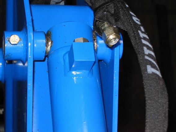

I just scheduled my 50 hr service. The dealer is picking up the tractor Tuesday. I was digging a trench for my barn clean-up sink drain today. Not sure what happened. I was very close to a tree and suddenly got a shower of fluid. The swivel snaped on the top of the bucket hose attachement. I was watching the hole, so didn't see if I hit a branch or the tree. But it was a mess.

Are you sure you didn't just break the fitting that goes into the cylinder? I backed into a tree and did that on my 758c a couple of weeks ago. At first I thought it was the hose too. I bought two just in case, then a couple days later a branch I didn't see snapped the one off the cylinder on the outrigger. Put in the spare, and right back in business. It wouldn't hurt to keep a couple around, as there are 14 on our machines. They are 3/8" JIC37 X 3/8" o-ring.

You were right and saved the weekend! /forums/images/graemlins/smile.gif I took a closer look and you can see the break in the picture. Made a trip to the dealer and he doesn't stock parts, but his supplier was just up the road. I picked up a spare while I was there. Back running in 5 minutes.
Saved by this board again! Sure glad I posted this note.
