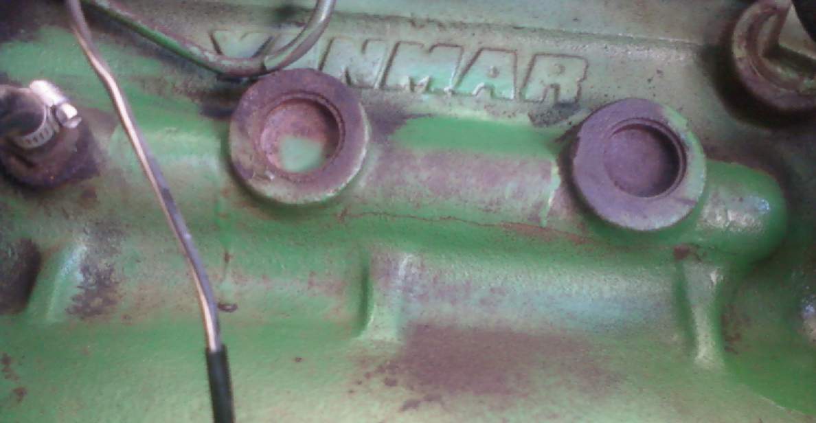

Hey guys,
I have been a reader for a while but just now posting with a big problem. The temperature don`t normally get 9 degrees in south Arkansas, but it did a few weeks back and you can just guess what happen to my 950 John Deere. I now have about a 6 fine hair line crack in the water jacket that is behind the starter just below the two 吐reeze plugs seeping water and also water pouring out of what looks like an inspection plate on the rear of the head. I don`t know what is behind the 3肺3 plate I can`t get it off and see in there due to being too close to the fuel tank. Not really worried about that too much though, I can get a new head if needed. The main concern would be the block. I do think these are the only damage. The tractor runs fine I ran it for 20 minutes the other day with a water hose keeping the radiator full, there was no water in the oil . I have read a lot here on the Lock and Stitch method having good success. I guess my questions would be. How thick is the water jacket on the 950 John Deere? And would this be thick enough for the tapping and plugging to hold up. And would Lock and stitch work on the water jacket?
Thanks in advance for your help. :eek::eek:

I would try JB weld, have done it many times. If the engine ever over heats again you well have to redo it.
Just put a little grove along with the crack to give the JB weld more to hang onto. Hold the JB weld in place while it's setting up just cover with duct tape.
/ Busted block on 950 John Deere #3
You'll be VERY LUCKY if the block isn't cracked between the liners and if it is cracked between the liners it will take a lot more than JB weld to keep the H2O out of crankcase.

We were taught in school that a 5% mixture of antifreeze was enough to keep the block from freezing. I tried it on a pumping unit that I had rebuilt and the frost plugs were on the ground come spring. The block was ok I just had to replace the frost plugs. I was lucky and decided that I needed to up the percentage. I would go along with Leejohn. JB weld does amazing things. You could also try a rad sealer though they do tend to plug up the rad if your coolant is full of junk and rust etc. As far as the inspection plate goes it's probably just bent. Just take it off and straighten it and make a new gasket out of some thick gasket paper and put it back together. Don't use any sealant on the gasket. They are designed to absorb water and swell and then seal. If you use silicone you don't let the paper absorb water. Good luck and let us know how your experiment turns out.

The tractor had anitfreeze in it just not enough ,The meter I had that I checked the water drainning in a bucket after it thawed out said it was good to 20 deg. There was a 50 /50 mix after a radiator flushing back in June but adding a little water now and then through the summer deluted it. This was a bone head mistake on my part, but most of the time a little anitfreeze goes a long way here in the south. Just my luck though this crack went buy 2 freeze plugs
/ Busted block on 950 John Deere #10
jeepingjason
I know everyone calls them freeze plugs, but they are casting plugs and do every little to save a block. By looking at the crack, you might of lucked out.

Up date on the little John deere With the busted block ..The leak on the head was just a bent cover . I pulled it off beat it back flat reinstall with new gasket this fixed the head leak on the block ..After much debate... Calls And E-mails... I found a man In Tyler ,TX who owns a small company called Cast and Repair. His web site said that "God mends brokend hearts ,,we mend cast Iron" though this was a nice saying,, He "pinned" the crack in the block then JB welded over the pins .Also pulled out the freeze plugs and install a polemier coating over the crack on the inside of the water jacket. and done this with the engine still in the tractor . I was only out $325 and 42 gallons of Diesel for 2 round trips to Tyler ... I was very lucky ....
