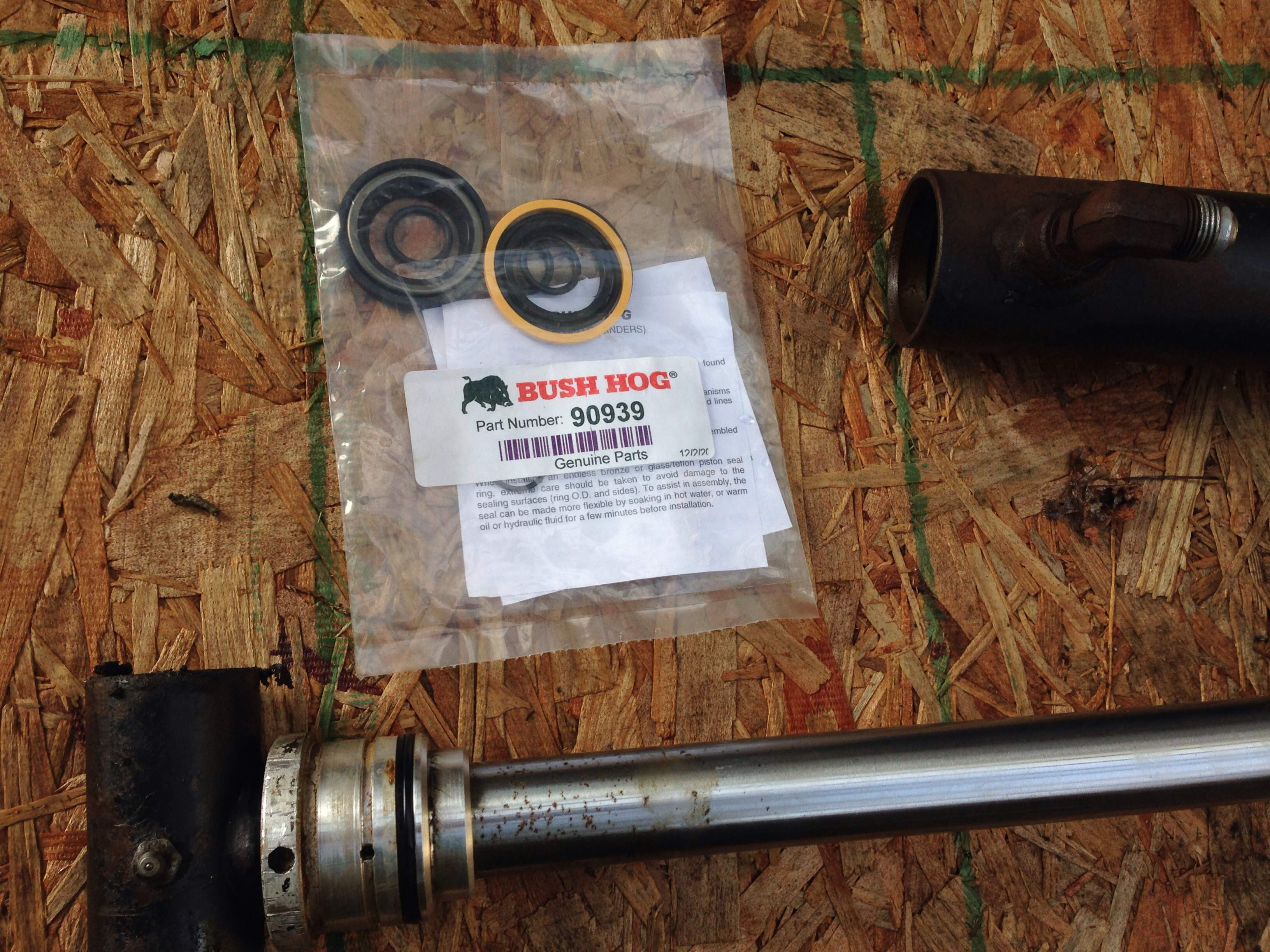

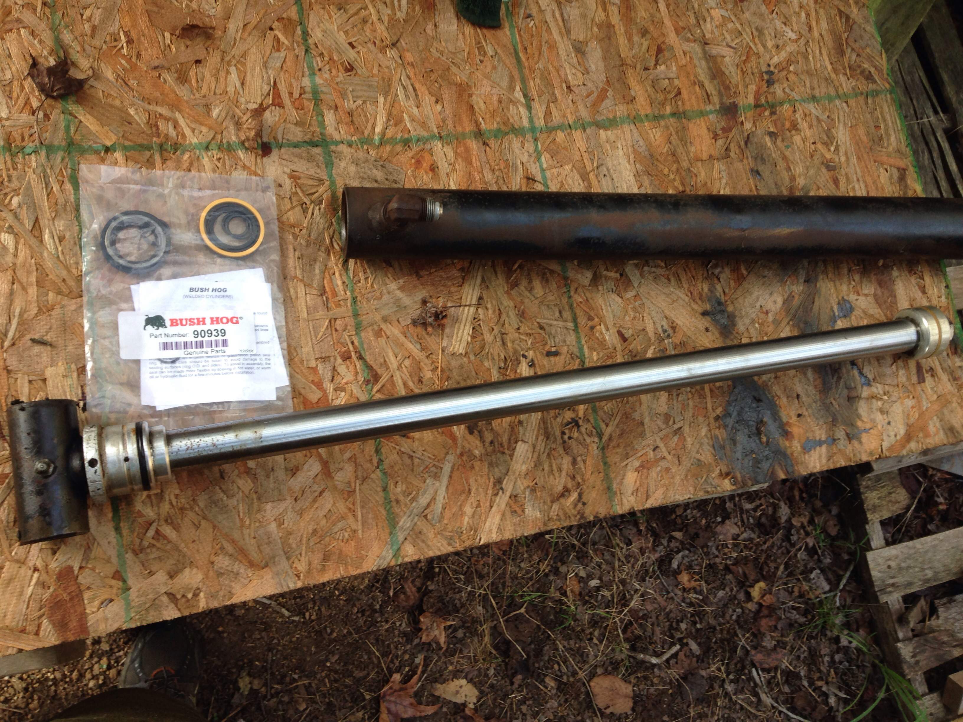

I ordered the seal kit from Bush hog to rebuild the cylinder and the larger O-rings are obvious where they go. But I am perplexed on where the smaller O-rings are to be installed. I just now started to disassemble the cylinder any guidance would be appreciated.

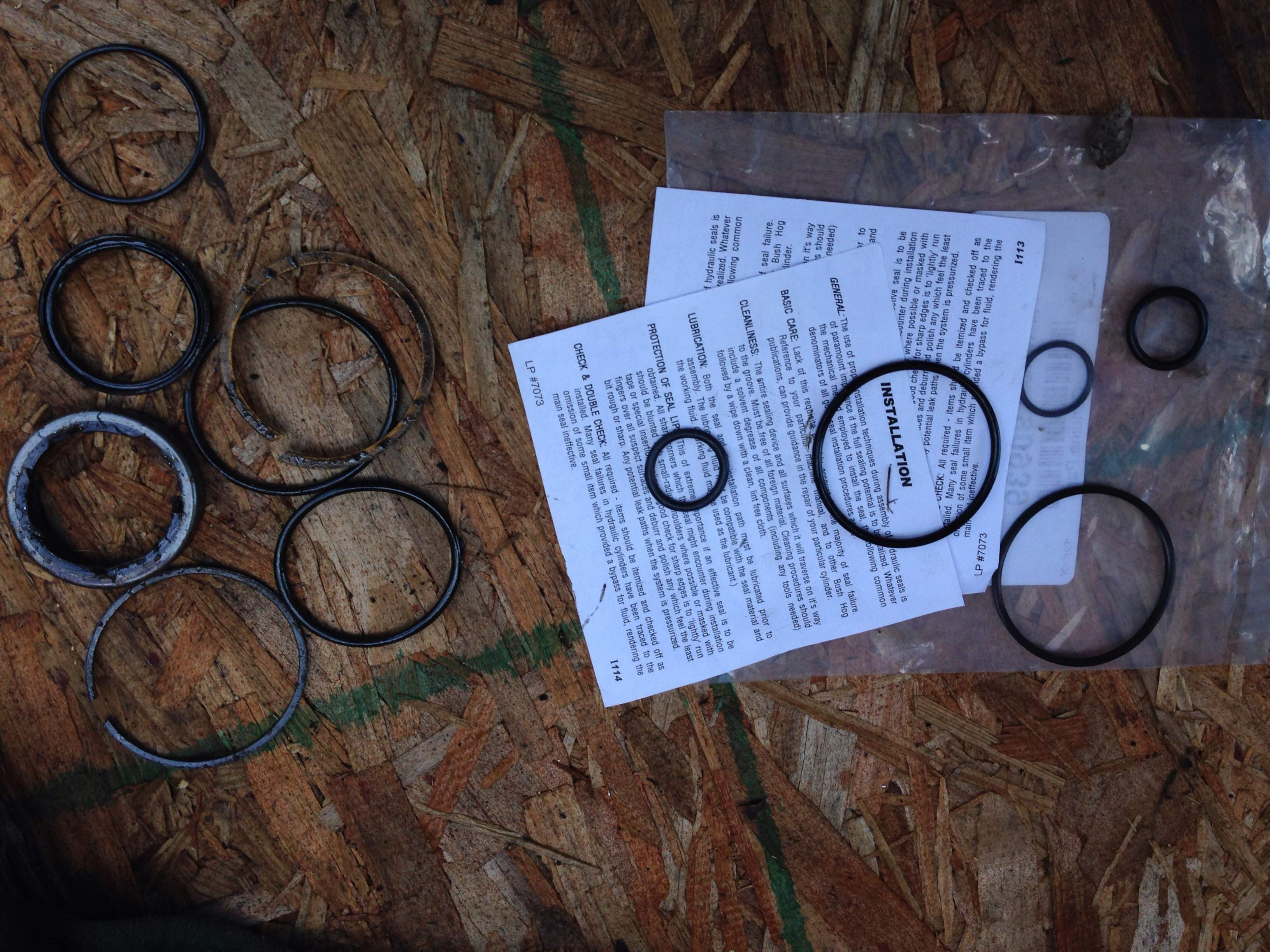

where the hoses hook in?
I thought the same thing But there are no O-rings in the existing hose connections. Basically what I have done is replaced every a ring that I have pulled out but I still have several left over. So I can only assume the kid has some extras in case there are different cylinder options.
In the picture the O-rings that are on the wood are the ones that were pulled from the cylinder, the O-rings on the paper is what is left over from the kit.
I am putting it back together now Hopefully it will work out. :)

Well.... It is back together, functional and no leaks.

I think I have the same kit as yours and I think maybe this kit is used for more than the cylinder you have. I haven't taken mine apart yet. Is there any kind of locks on the end cap of the cylinder or does it just screw off?

Well it didn't stay that way... ;)
The same cylinder started leaking this fall. Not as bad as originally but bad enough that I have to take it apart again. Not sure what I did wrong the first time, if I did anything wrong at all.....

SAE fittings use O rings- maybe that was why they were included, if they had been used at some point?
