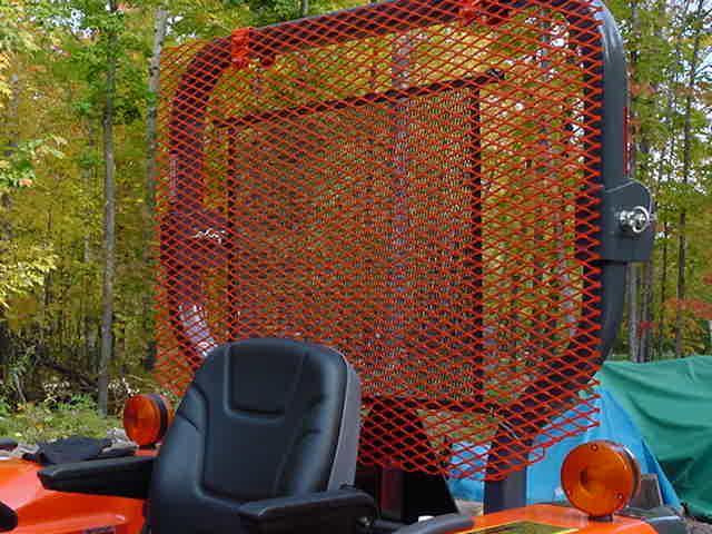

Travis - I cut more brush than grass/weeds, so run at recommended RPM,s. Chunks of wood are flying around pretty good at times and have been hit on occasion, so made a rear cab guard for protection - it does the job. Pic attached.
penokee /forums/images/graemlins/smile.gif
