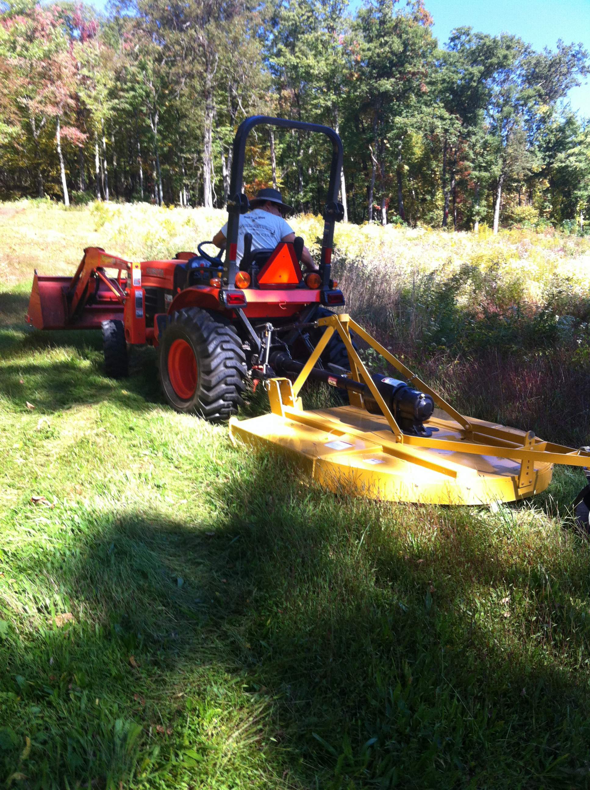

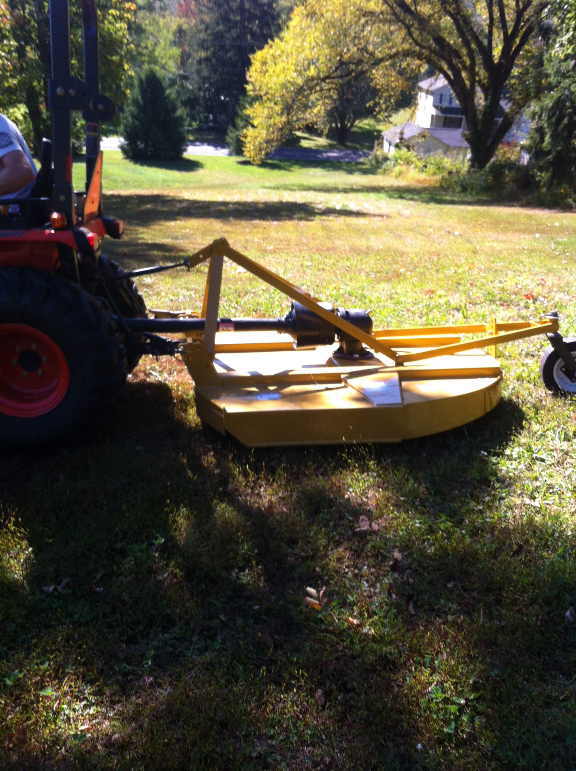

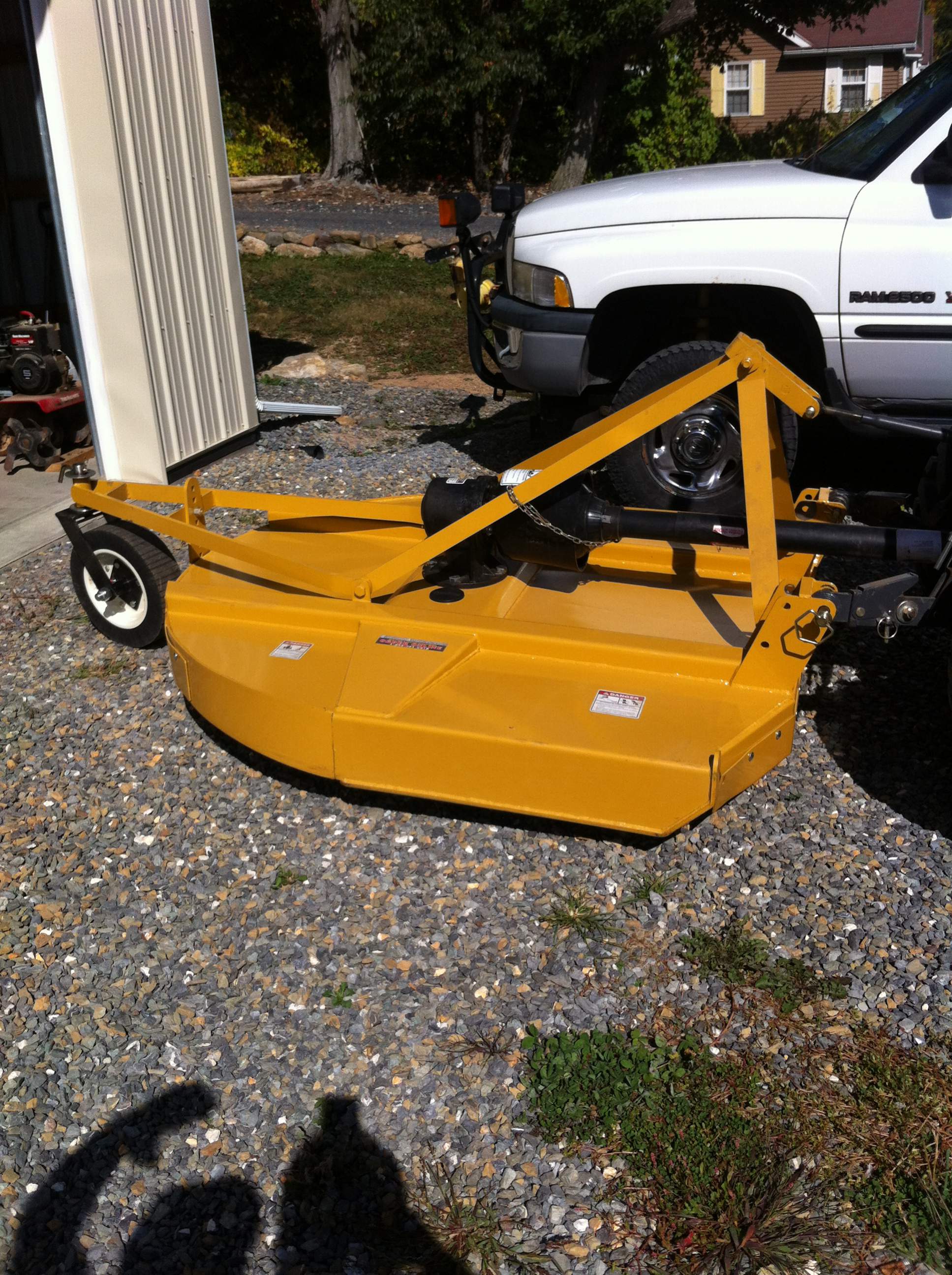

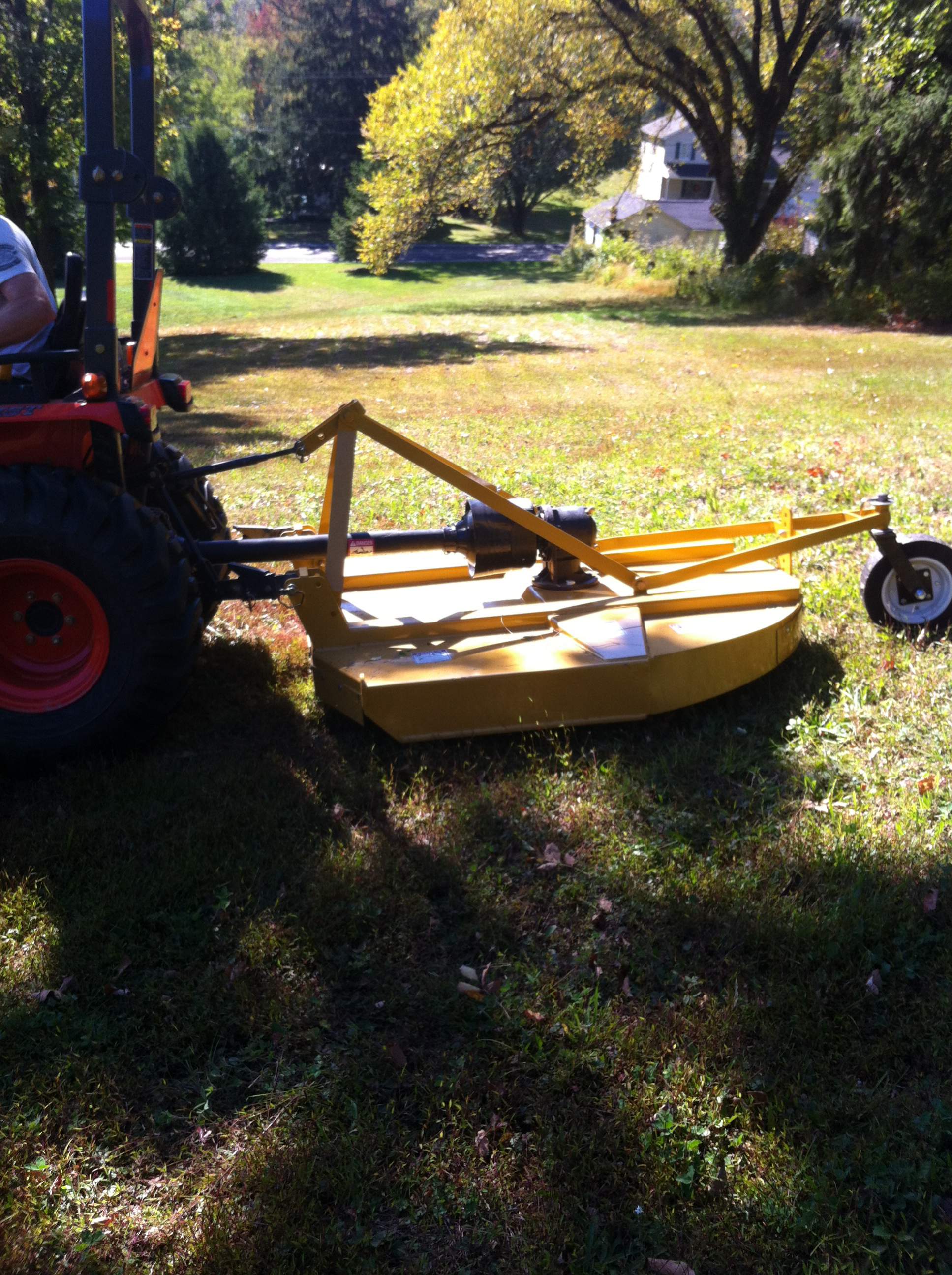

Here are a couple photos of my cutter. The pictures do not bring out the true slope of the land or the density of the brush but that is probably due to my inexperience as a photographer. The field was no real challange for any cutter really but the slope made things more difficult. You can see how exhausted my helper "Patches" was in the one photo. She slept like a log that night.
