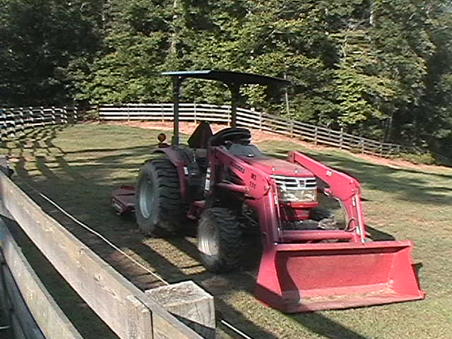

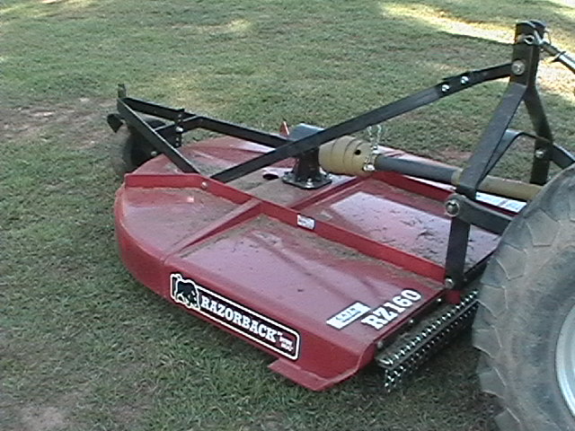

Finally had to get a Rotary Mower. With all this rain and hot weather we've been having, my pastures were getting overgrown in some areas. The horses couldn't keep up with it!:laughing: Went with a 5' Razorback for my 25 PTO HP tractor since all I'm mowing is tall grass. Handles it well. Never really boggs down at all. The only thing is I'm getting a strange load moan sound. Seems to be resonating from the stump jumper. It's oval in shape on this model. Becomes louder when your mowing over taller grass. Wondering if anyone else has experienced this? This is the first rotary mower I've used so can't compare to anything else.

The noise is tough to describe. It's more of a resonating sound coming from under the cutter as if a harmonic is created in the structure of the housing. Again, thinking it's created by the swirling of the stump jumper. Wondering if your stump jumper is oval or round in shape? It gets a bit irritating after a while. Wouldn't mind if it was just the sound of cutting.

Thanks for the replies. After using the mower again yesterday I would descibe the sound as being similar to when you blow over the mouth of an empty jug only much louder. I checked tightness on all the nuts and bolts on the machine, adjusted the height of the mower, made sure it was level side to side, adjusted the angle front to back, checked for any unusal play with the stump jumper and blades. All tight. Didn't help.:(

Does it have lift blades? or does it have straight brush blades? I have a 6' bush hog squealer and when I went from the straight brush blades to the lift blades it sounded signifigantly different, I attributed it to the lift or vaccum and it has never given any problems, it's a rotary cutter that is designed to do rough cutting it's gonna make some noise.:D

It looks like it has the straight blades. They have a bend downward lengthwise from the bolt, but they don't have any curve across the blade or any lift bend opposite from the cutting edge.
   / Bush Hog Razorback #10
Does it have the correct level of oil in the gear box? Like others said all bushhogs seem to have a unique sound to them.
