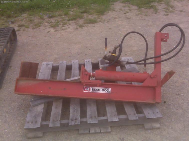

Purchased a used Bush Hog 3 point wood splitter from a JD tractor owner. I can find no model# or label, it looks like a L26A. I am a IH tractor owner. I got the splitter to work by tying the handle in one direction and changing the control lever on the tractor. The splitter's valve has a label saying closed. I think I need to change it to a open valve. Did Bush Hog sell the splitter with a open valve? Can the valve be modified to a open center valve? The end of the valve looks like it could be removed. I could go buy a new open center valve. I have searched the internet for a manual, no luck.

I happen to have the same splitter. Yours is the only other one I have seen. The model number is actually LS26A and the owners manual has a part # of SP112. Call Bush Hog, they sent me one for free even though they stopped making these years ago.
I am a little confused about your valve questions. The valve on mine is an open center valve. You have to hold the lever to extend the cylinder but when retracting the cylinder there is a detent that holds the lever and it is spring returned to neutral when the cylinder fully retracts.
The owners manual gives this information about the valve. Product number 20038. Description; CVA-200, 1/2 NPTF, 4 WAY, OPEN CTR SPRING RETURN.
Energy Mfg. Monticello, la. At one time that info would have been on a label on the opposite end of valve body from the lever.
You do know that if the lever for your rear hydraulics does not have a detent to hold it open you need to tie the lever open to provide flow for the splitter to work.
Let me know if you need anything else from the owners manual. To be honest there isn't that much to it.

In addition to what MarkV said, your hoses look tiny to me for that splitter. Larger hoses should give you more flow and increased splitter speed if that is a problem.

You said you hooked it up and the splitter worked. Is your tractor open or closed center?
Perhaps, whoever had the splitter had a tractor with a closed center system, and when they ordered the log splitter, they would have to purchased it with a closed center valve. The fix may be as simple as a plug, port change.
If the splitter worked normally with the lever tied back, and the detent worked, then everything is good to go.

I would just get a new valve. The on JJ listed from Surplus Center is the one I use and its been tough as nails for many seasons. Much cheaper and easier than trying to track down all the parts to change your valve to open center.
