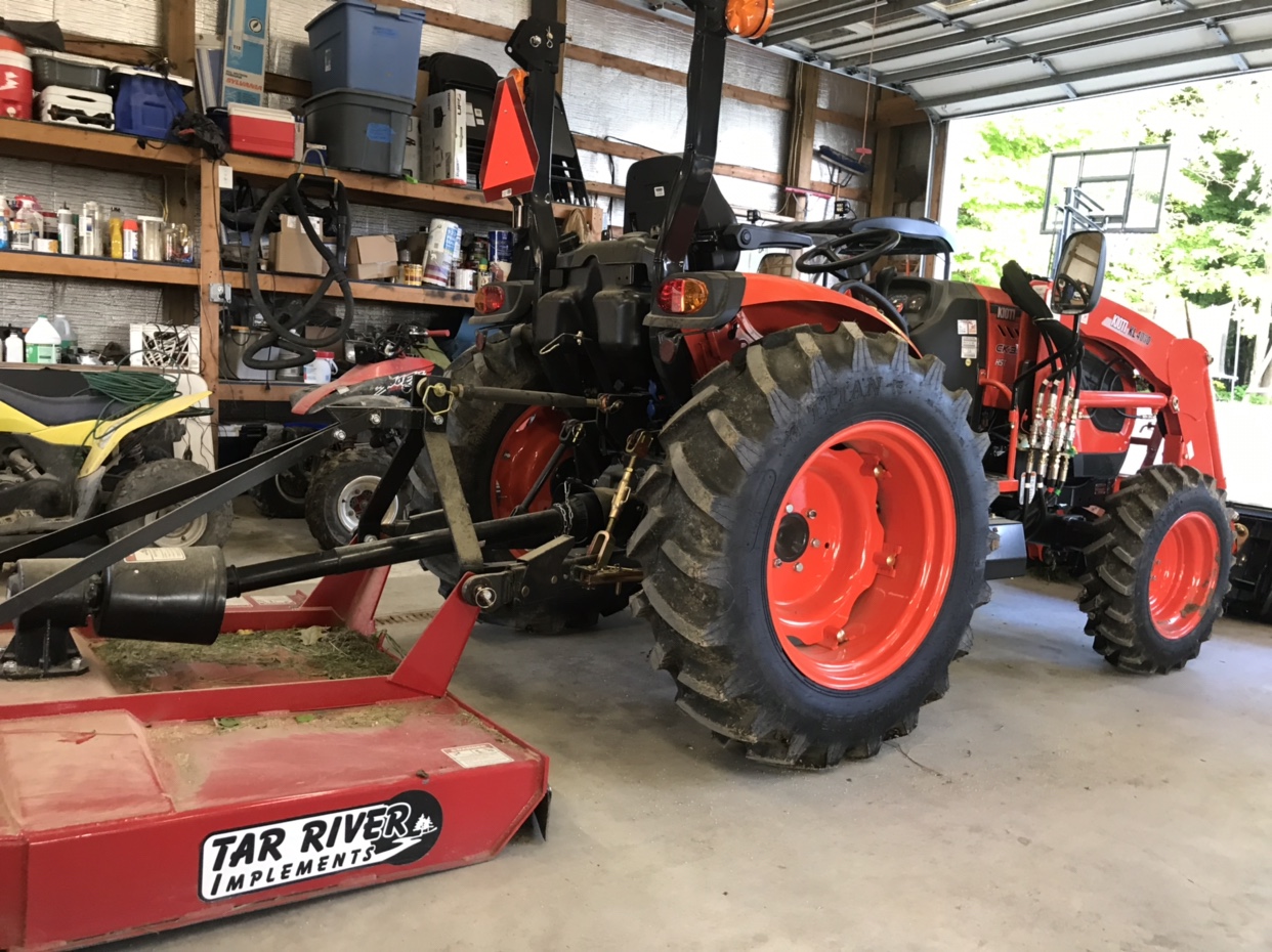

Finn, I just received my 3510 yesterday. I bought a 5’ due to my topography. Some of my hills are rather sketchy. I’d rather not have the extra weight pulling me around. I put 8 hours on it mowing grass that was nearly as tall as my hood. I had to be in low and take 2 passes to get a clean cut. It only bogged twice. Bogging happened when the cutter wouldn’t clear. I think it could easily run a 6’ cutter if you weren’t cutting tall field grass.
Last summer I used both a new Tak TL12 and a 200hr case TR310 with a 6’ Bradco ground shark. The pluses of a ctl is the it made a cleaner cut and sitting in a cab was great. Minuses was that the leading edge the mower would gouge into the ground. Cutting while turning didn’t turn out very well. The best cut was achieved by cutting in reverse with the loader in float. Camera or not, visibility sucks out of any CTL. Finally, traction is non existent with the ctl in grass. I was sliding all over the place on hills. I had to have my neighbor rescue me a couple times when I slid out of control towards an embankment. The lighter case with bar tracks did marginally better than the big heavy Tak with block treads. I could do crap with it. It was too stressful to be productive.
My loaded R1 tired 3510 is a billy goat compared to either ctl. IMG_8705.jpg
