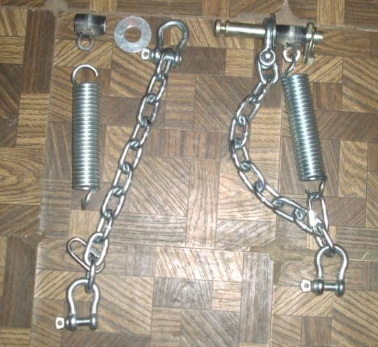

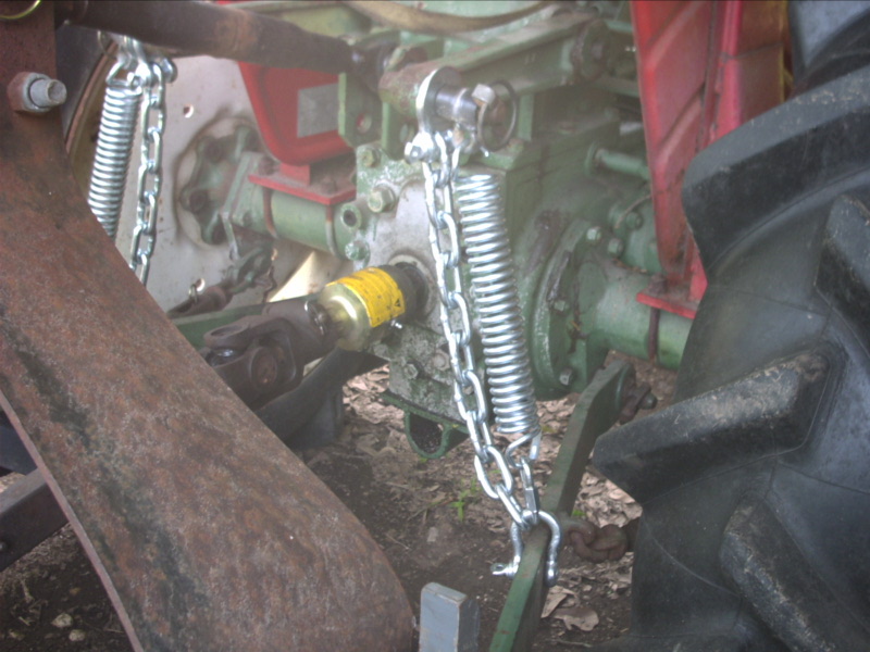

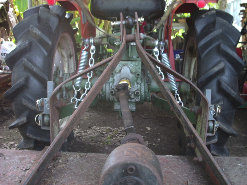

hi YM2310JC,
Yup, the problem plagued me also, this is what I did. In the picture, the brush cutter is raised off the ground, you see its weight is supported by the springs. The brush cutter truly floats, less vibration and no 2" trenches. Very helpful brush cutting next finish cut areas.
Hardware List:
4 ea - 3/8" shackles
2 ea - 13" lengths of 5/16" chain
2 ea - 3/4" x 1 1/2" pipe nipples
2 ea - 3/4" washers
2 ea - 1/4" qwick links
2 ea - 9/16" nuts (welded to pipe nipples)
2 ea - 1 1/2" x 7 1/2" heavy springs
I'm sure there are many other ways to solve the issue, this works for me. They swap back and forth easily with the factory links when implement used dictates rigid links.
