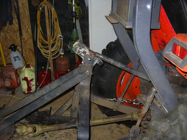

/ Bush hog differences? #10
Mine has the flex link, works great once I un welded it after the previous owners mistake.
OMG! There is no safety guard over your PTO shaft. The safety storm troopers are going to get you...... :)
Now I've done it! Here come the feds!! Let's see...never had one, uhhh I used it to make a funnel one day? Uhhh don't care! :)
