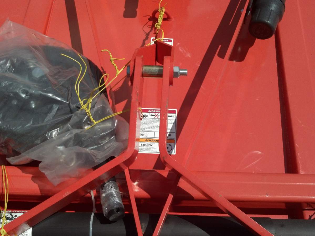

Mine came in today don't be surprised when you see manufacturing location of the gear box. looks like they have also taken some structure out of the 3point toplink attachment. They removed 4 gussets. Red is the 295 orange is BH27. Still looks well built though.
   / BUSH HOG BH20 series #5
I asked the dealer what the big changes were he claims the bush hog rep said they've increased the strength of the BH27 over the 290 by moving some of the steel to higher yield strength steel

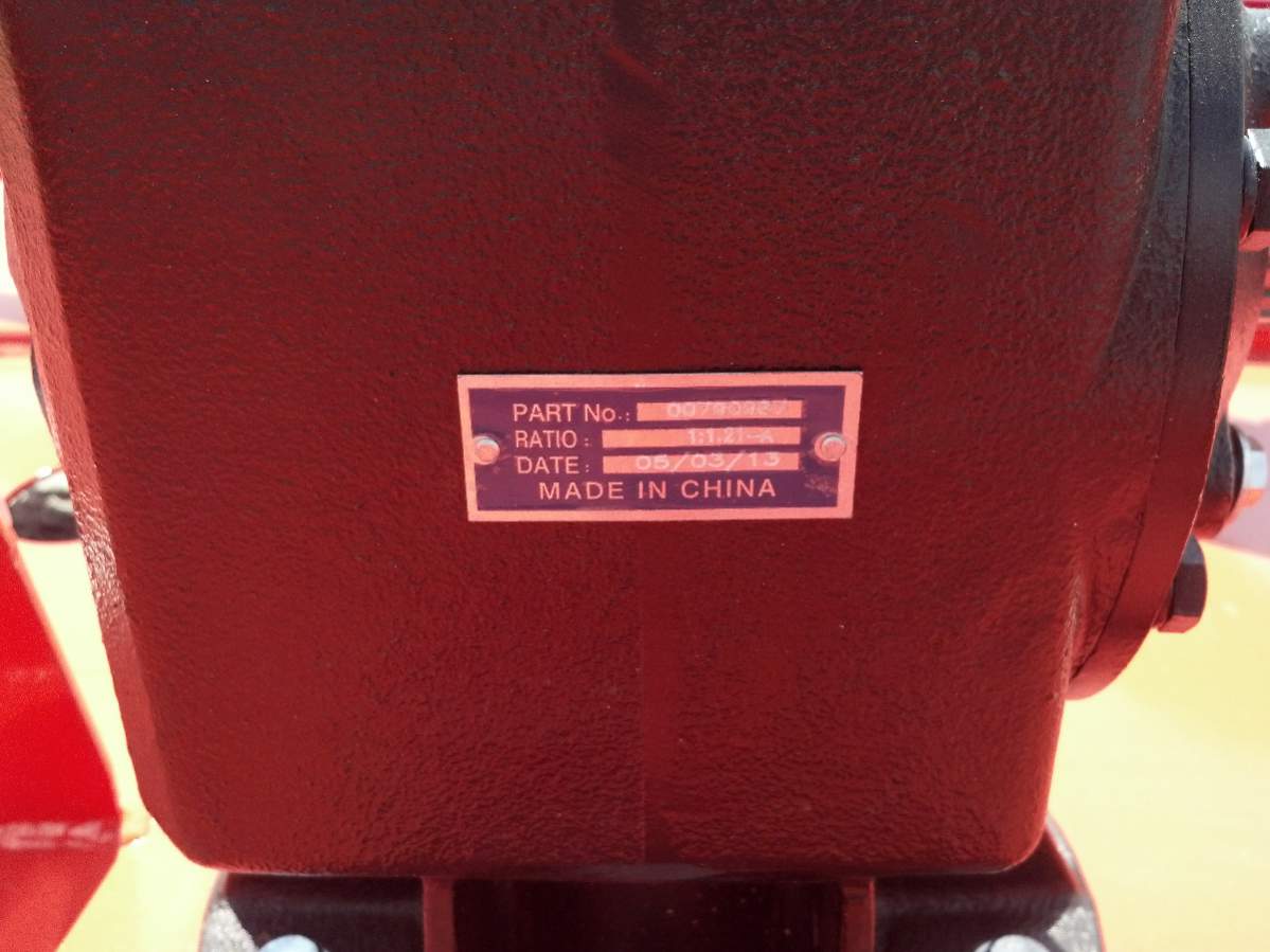

According to the parts manual The BH comes in two flavors china gear box BH2x-1R
And BH2x-2R which looks like it has the 290 camon Italian made gear box. Wish my dealer had told me this before i bought mine
   / BUSH HOG BH20 series #7
I don't think you'll have any issues with the china gearbox. All the research I've done leads me to believe theyre as good or better than many of the European ones. I was a little disappointed when I found the Comer box on my Rhino cutter was Chinese but Its given me nothing to complain about.
   / BUSH HOG BH20 series #8
So even Comer switched to China, disappointing. I agree i'm sure that it will be fine as long as they are built to the same standards.
