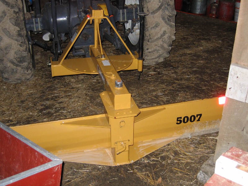

Verti,
just before Christmas I was in the same place you were. I have a 8ft Rhino, which is as heavy duty as they come, and I was looking for 7 ft blade to use behind my NH3430. The 3430 has about 45hp, and that is what I wanted to use it on. I have a light 6 ft blade, but it just barley cut the tractor tracks straight, and would not if it was angled. One thing I was after was the offset feature, and this is a little harder to find, but VERY handy. I did all the comparisons, and I decided i wanted the Bush Hog 70-07. The 70-07 is the 7 foot version of the 6 ft one you are looking at. I found what I thought was a good deal for mid OH. and went to pick it up. When I got to the lot, they had the Bush Hog 70-07, 50-07, and 35-07 to compare side by side. The 35 series is the light duty, 50 series mid duty, and 70 heavy duty series. Since I already have the 8 ft Rhino blade, I felt I could get away with a medium duty for a second blade. I chose the medium duty 50-07. This is a well made medium duty blade and will work fine on my 3430, and also on my TN65 if I don't' try to overdue what it is built for. The 70-07, Was a NICE blade. Heave, and has all the features: swivel, tilt, and offset. Definitely what I would call Heavy Duty. If I had only one blade, I would have chosen the 70-07 for the extra steel. The Woods blade compares nicely to the Bush Hog, and price being equal, would in my opinion, both be equally good choices for a heavy duty general purpose rear blades.
Would I put this heavy of a blade on a Jubilee?? I ran a 600 for years, and I would say that the 70-06 blade is at the upper end of what I would want on the Ford. My old 600 would have lifted it, but that would be a Big bit for the old girl. Depends on what kind of dirt your digging. I don't know about our B3200, but HP is about same I believe. I don't think you would have to worry about hurting the blade with either of these tractors.
Bottom line, see if you can find either one of the blades you looking for on CList or classifieds and save a buck, you can't go wrong. If you get a chance to take a look at the 50-06 series of the Bush Hog, you may be impressed, and $$ ahead for that next new toy, I mean tool!
