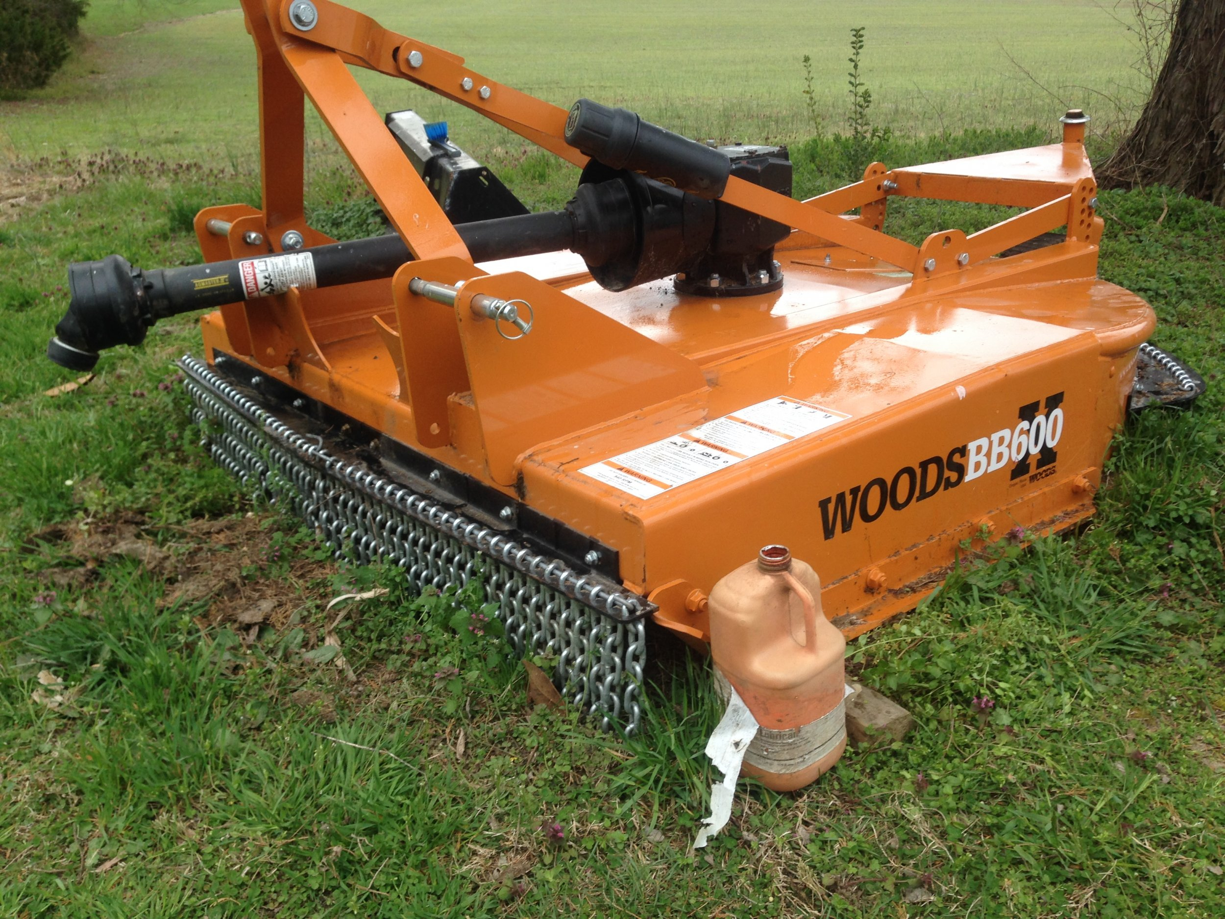

Brown tree cutter would be my choice. I had a Woods BB600X that was a beast. I would say somewhat similar to the brown tree cutter. If you run over it, it eats it up. It was a bit overkill for my New Holland TC40 but it would chomp. What size gear box is on the Brown?

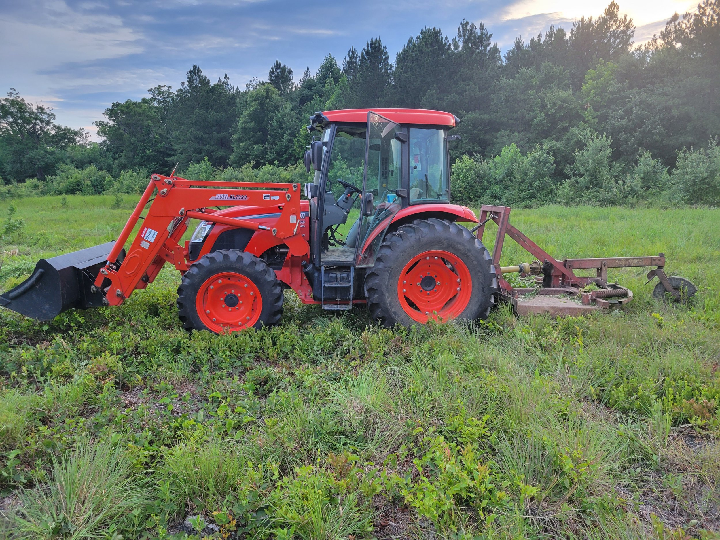

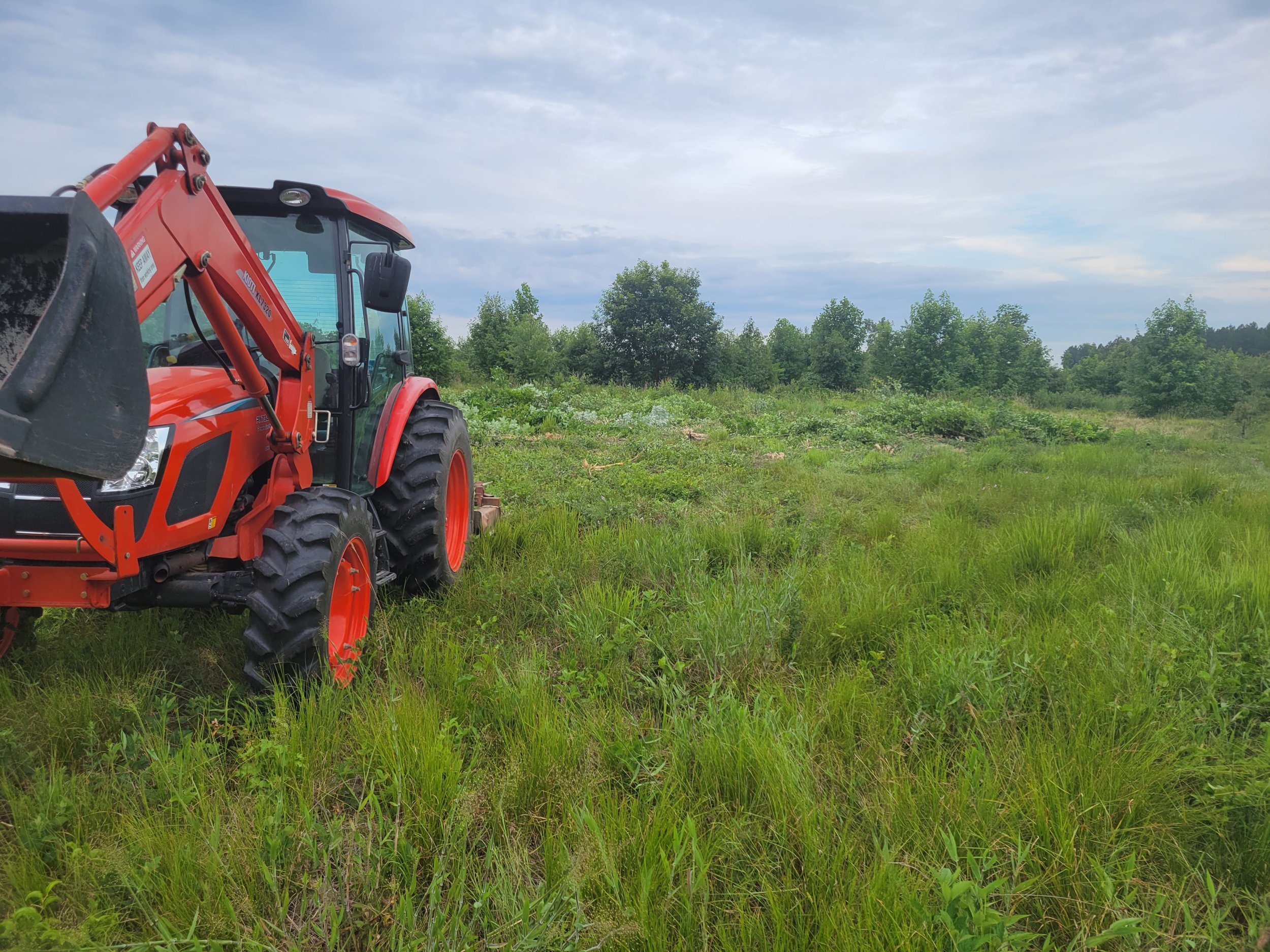

Just an update on this. Did end up with an RX7320 and the 6ft brown tree cutter. The cutter is HEAVY but will absolutely demolish anything you cut with it. I can cut through a clump of 3-5 tulip poplars all 3 inches in diameter and it doesn't even pull the engine on the tractor down.
   / Bush Hog 306 or Brown Tree Cutter #10
I notice that you mention a new tractor, but didn't post pictures...
