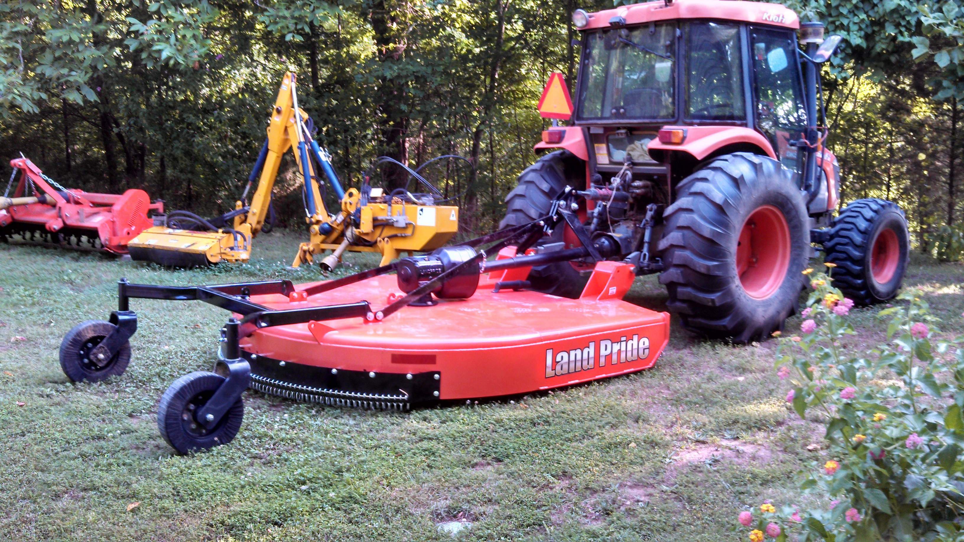

I'm looking at a Bush Hog 297 or Landpride 2784 need some advice.
seriously considering the dual tail wheel models as they are 8" or so shorter and i think they will probably be less likely to scalp over uneven terrain.
Leaning towards the Bush hog looks like the rear dual tail wheel structure is probably more robust to accidental lateral input than the landpride due to it having a very large gusset. However on the single rear wheel model i'd pick the landpride construction is otherwise similar. I Don't find much negative feedback on either model. Bush hog is $350 - $400 cheaper ~10% I believe both use USA made components but its hard to be sure.
Both look to be well made. Might be a tad overkill for my normal use but ive seen what my neighbors King cutter looks like after 10 years of use (its not pretty).
id rather have 3" capacity and generally only need 1" or less.
I'm assuming At 1350 lbs hanging a total length of 10' i will probably need front weights added if i remove my loader. Anyone have an idea on how much i will need i do not currently have a weight bracket or weights. The king cutter i used was 1/2 the weight and didn't even phase my tractor without the loader it was also shorter.
Any comments would be appreciated

I assume the cutter will be used on the Kubota M8540, not the small one pictured with it. I do not think any front weights will be needed when the loader is off.
I think dual tail wheels is a good idea for that wide of a cutter. I bought a used Bush Hog 297. It came with the single tail wheel and front and rear chains. Had I bought new I would have got the dual tail wheels.

I second dual tail wheels, I would like them on my 6' cutter and would order a 7' with them.
During, have you looked at the Brown 417 and compared to Bush Hog? I have the older model of the 416 (the 472) and am VERY impressed by it. If I ever buy another cutter it's going to be another Brown. Very heavy duty, well built, and incredibly good people to deal with. They have a great reputation and build some insanely strong cutters, the 400 series is their "lightest duty" cutter, and is still heavier duty than the Bush Hog if I remember correctly.

Piston, Thanks for the recommendation on the Dual Wheels. I called Brown , got a distributor and found a few dealers i have requested quotes. I like the setup for the top link better on the Brown 417 it looks to be rated at 2" capacity rather than 3" due to the entire deck being made out of 7 gauge metal including the skirts. The landpride and bush hog both use 10 gauge deck and 1/4" side skirts. You are correct that the Brown is built heavier than the other two but i'm concerned that its heavier all around but as heavy where its most needed. The Rear wheels also seem to have a pretty sturdy attachment with gussets on the vertical tabs.

Not what you are looking for, but this works well for us. I have found little to no use for a 7' cutter as it is too big, in my opinion for a single spindle, lot of load on PTO and kind of awkward, but would go with dual tail wheels if I had to have one. If I "needed a 7', I would just go on up to a dual spindle 8'. The dual spindle mounted won't stick back as far as a 7' single spindle.
Land Pride makes a couple of nice models which should work on your 8540.
We used mounted and pull type cutters over the years and to get the cutting capacity, coverage we need, we went with a Woods DS1260 10'6" cut as it is easy to pull on hills and can be easily pulled with FEL or front weights. We still have a mounted Woods 121, but its cutting capacity is only about 1 1/2".
As to weight, I pull a Land Pride RCR2672 with my L5740 and on level ground without a FEL or weights, so by extrapolation, I see no problem pulling a 7' on your 8540 without weights.
I spent a little time researching, but I am sure you will find more checking all the various brands, I like Woods, Land Pride and Bush Hog, no experience with other brands so I can't really say.

Just noticed that the 7' dual tail wheel Bush Hog 297 is actually shorter than the RCR2672 you pull behind the L 121" versus 126"
Not sure if Bush Hog is including tail wheel length or not

No, I wouldn't want to go down to a 6' on our M8540 either and it seems like for your needs a 7' may be the best way to go and I definitely would go with a dual tail wheel. My 6' cutter will even occasionally dig into the ground on a turn on uneven ground if I am cutting very low.
I can sure identify mowing where your tractor barely fits, why we own several tractors. In some places a 10' won't fit and if we only use a 6'-7' we will spend WAY too much time mowing. We also got tired of running equipment between farms so much, no way out totally, but cut it down quite a bit.
Yep, on another thread I mentioned how long a single vs dual tail wheel stuck out in the back, but turns easier in tight woods if you are just weaving around. In a turn those wheels sticking out to the side catch on stuff easier than the trailing single wheel, I guess there is no such thing as a free lunch. The Woods 6' single tail wheel cutters are shorter than LP, as LP really sticks out there.
The Woods BB720X is only 116".
