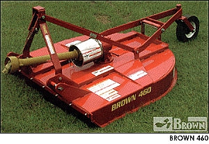

The only thing I don’t care for is the standard A-frame they use (it will bend/twist over long term use)… you can upgrade to an optional hefty A-frame, but I believe is only offered in Cat II and Cat 3… don’t think it’s available for Cat I… you will also pay a premium for the Bush Hog name… (I’m guessing ~~$2k for the 60” unit) (also over 800 lbs. of steel hanging off the back)
There is only one other 5’ rotary cutter that’s in this class (that I’m aware of)
Brown 460 ~~ $1500-1600. (note the strong A-frame design):
