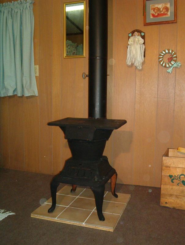

When I was a kid we would go out to the cabin on Friday nights to spend the weekend.
My grandad used to roll newspapers, cut them into 4" sections and soak them in kerosene.
Before we would leave on Sunday he would set the fire for the next weekend by placing one of the paper logs in first, then load coal or wood on top of it. That way when we arrived the next Friday night we could get a nice toasty fire in the stove quickly.
