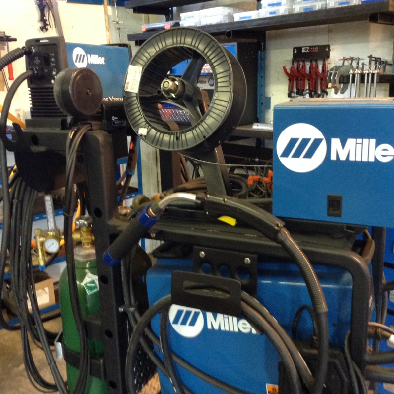

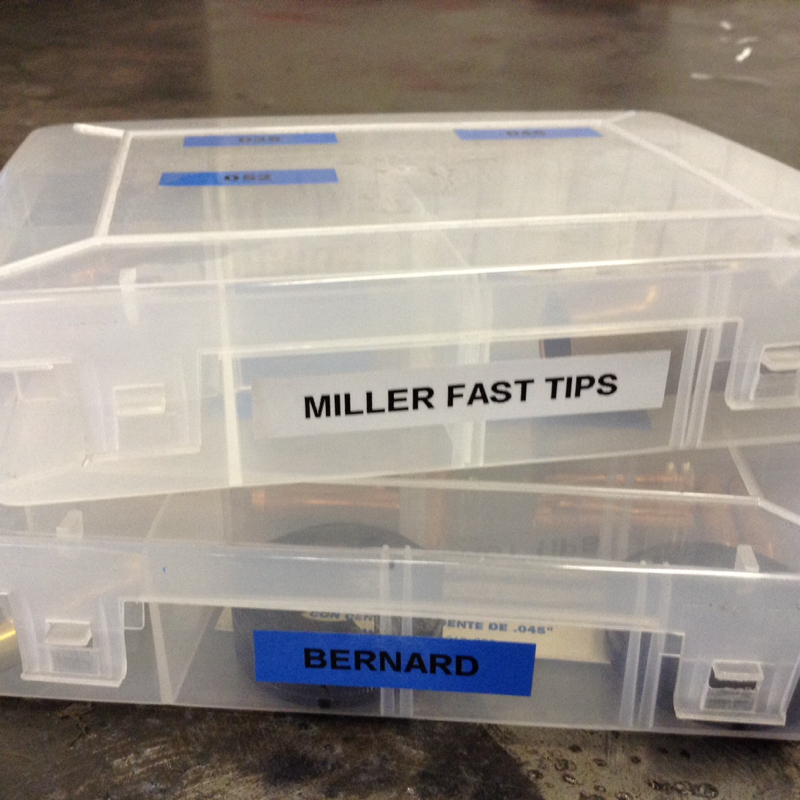

I went with the Bernard Centerfire. I wasn't smart enough to consider 30A spool gun consumables compatibility tho.... image-1484370732.jpg image-983760980.jpg Terry
