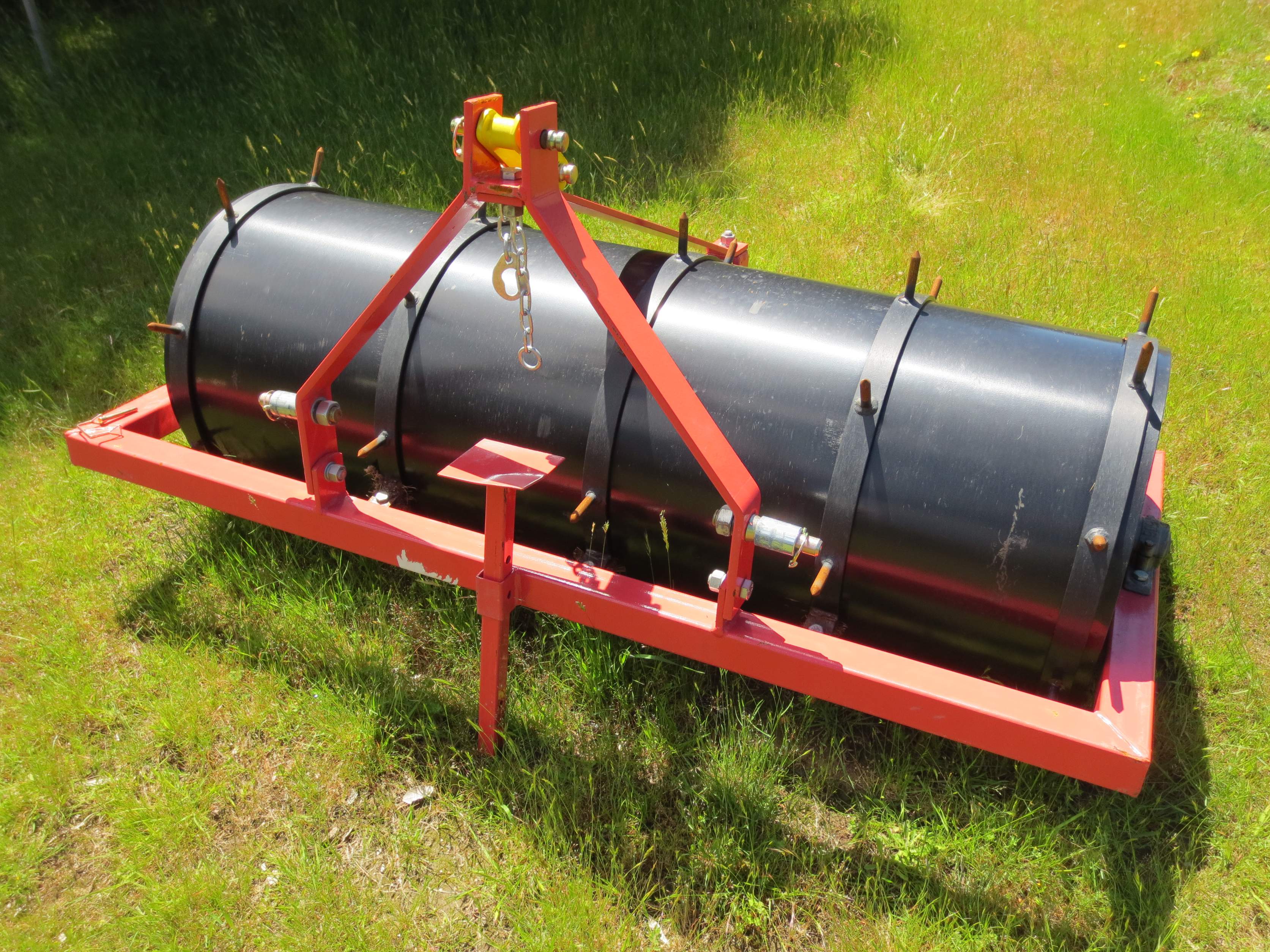

G'day Mate and welcome to TBN from Downunder.
I too use a chain harrow year round to break up the horse droppings. What I've also done is invested in a ballast roller (with aerating spikes) to smooth out my paddocks and improve drainage.
Another thing that you can do is to subdivide your big paddock into 5-6 smaller ones IOT rotate your horses. It's less impact on the ground, cuts down on parasites and allows the grass to recover. I rotate my 'boys' every 10-12 days.

   / Bumpy pastures after a water logged winter #9
