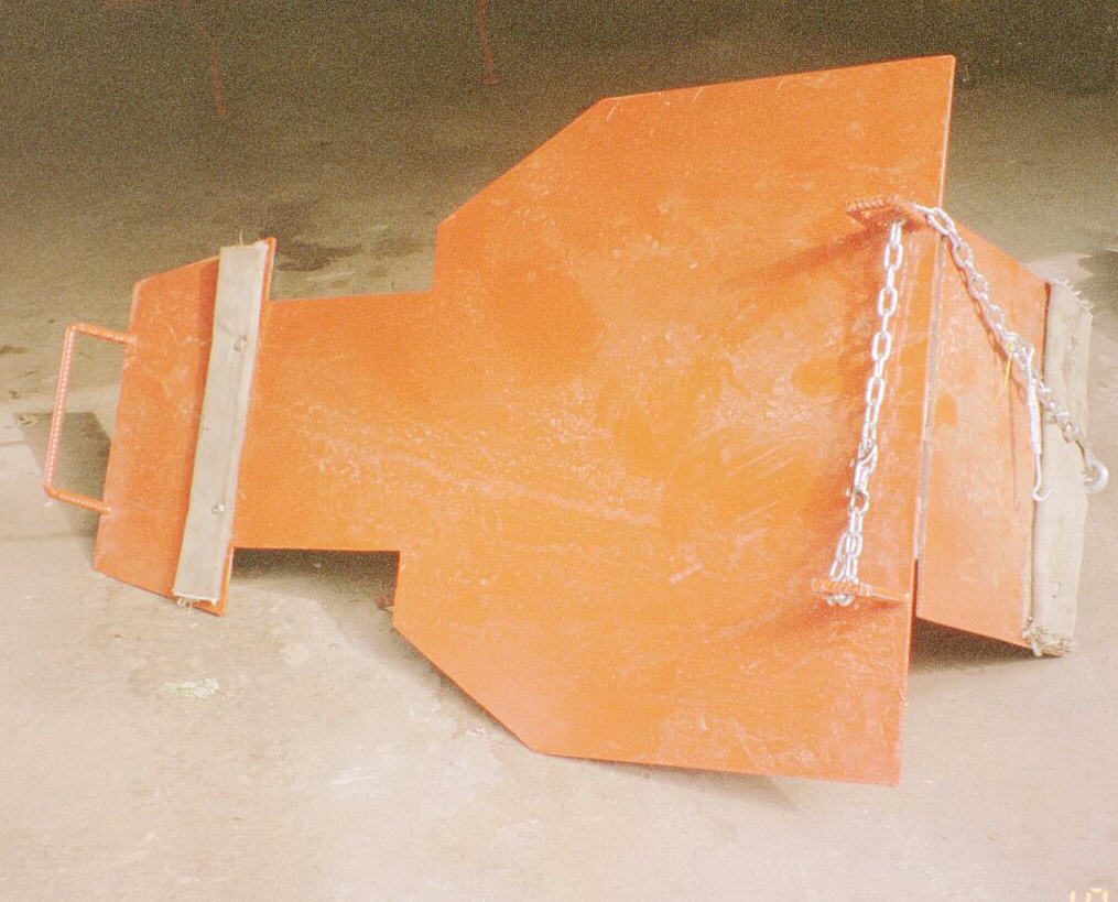

Has anyone here put a detachable skid plate under their BX yet. I'm going to build one for mine that will use the MMM links to attach it and provide complete under carraige protection from the front steering cylinder to the rear end. This should really work good when I want to bushhog down some nasty stuff and working with the FEL. I plan on using the mower links so I can just drop the skid pan and attaach the MMM when I need to mow. If anyone has done this and has pictures please post em. I just have the idea now and was wondering if anyone had done this. Cool idea huh?

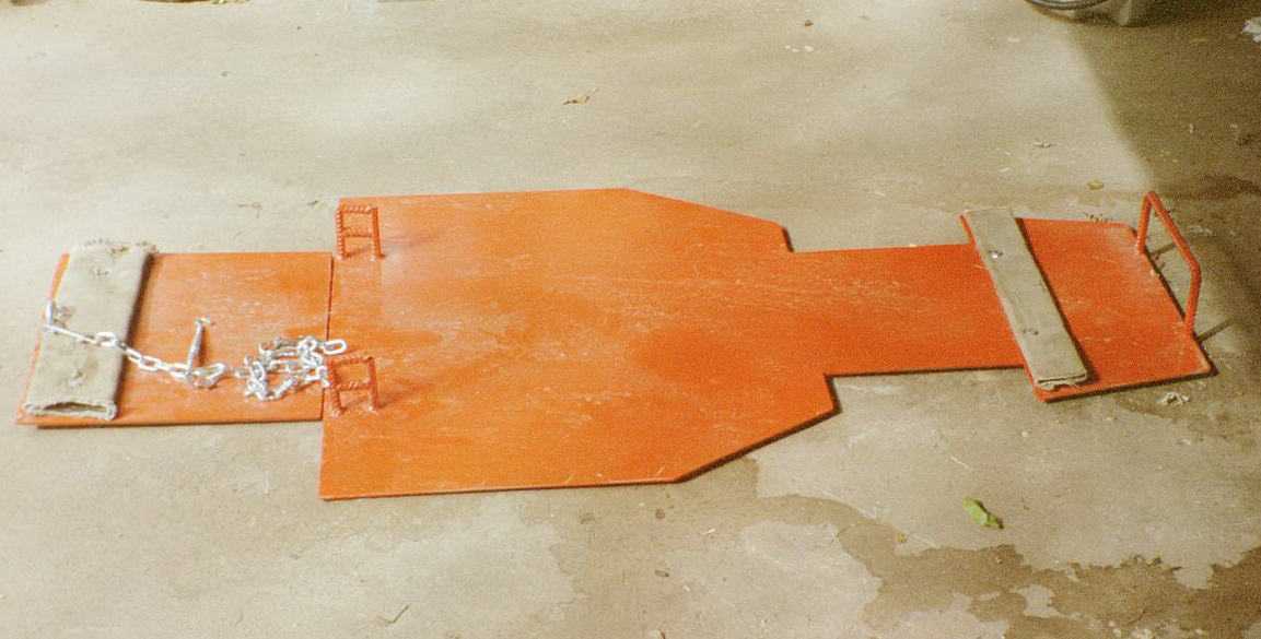

LARRY:
AFTER BRUSH CUTTING WITH MY M-40 CUTTER, IT WAS CLEAR THAT THE BX2200 NEEDED UNDER BODY PROTECTION.

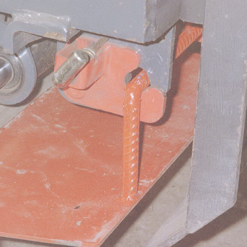

AS I POSTED PREVIOUSLY, I USED THE MOWER FRAME MOUNTS AS THE ATTACHMENT POINTS, USING 1/2" REBAR FOR THE MOUNTING LOOPS.
ONE FOR THE FRONT AND TWO FOR THE REAR.
THE SKID PLATE ITSELF IS 3/16" STEEL PLATE.

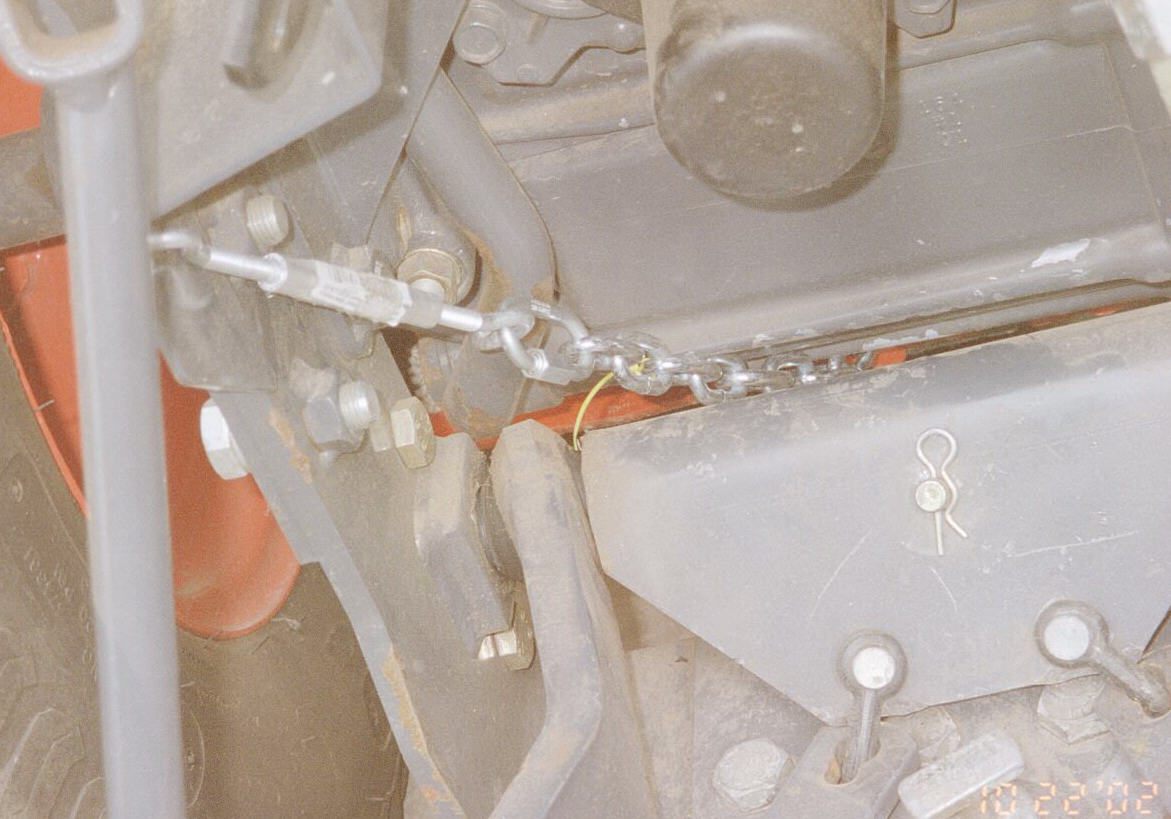

I ALSO ADDED A HINGED PLATE, TO THE REAR OF THE SKID PLATE, TO PROTECT THE REAR AXLE, LINKAGES, AND TRANSMISSION FILTER. I USED A PIECE OF CHAIN AND TURNBUCKLE TO FASTEN IT TO A FRAME HOLE NEAR THE REAR PTO.
I LAID OUT THE DESIGN USING A CARDBOARD TEMPLET, WOOD BLOCKS AND 1/2" COPPER PIPE.
THE CUTTING & WELDING TOOK ABOUT 2 HRS. I ALSO PRIMERED AND PAINTED IT ORANGE TO MATCH THE TRACTOR.
I AM STILL TRYING TO BORROW A DIGITAL CAMERA TO SHARE PICTURES OF MY FABRICATIONS WITH THIS GROUP.
WHILE "BULLET PROOF" MIGHT BE HARD TO OBTAIN, THIS WILL CERTAINLY MAKE YOUR BX "BRUSH RESISTANT".
WALT

I STILL DON'T HAVE A DIGITAL CAMERA. WHILE IN WALMART THE OTHER DAY, I NOTICED THAT FILM PICTURES COULD BE PUT ON A CD, WHILE BEING PROCESSED FOR PAPER PHOTO'S. SO FOR $8.02, I AM DIGITAL READY.
I WILL ATTEMPT TO ATTACH THESE PHOTO'S OF MY TRACTOR STUFF.
WALT

SKID PLATE HINGE IN ACTION

ATTACHMENT TO FRONT MOWER FRAME HITCH

ATTACHMENT OF REAR HINGED PLATE BY CHAIN & TURNBUCKLE, TO THE REAR FRAME HOLE, IN THE AREA OF THE REAR PTO
