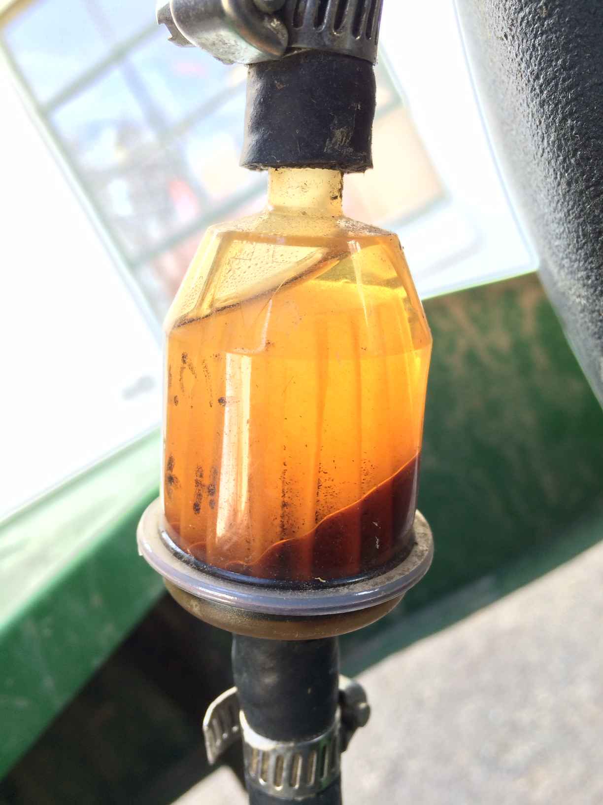

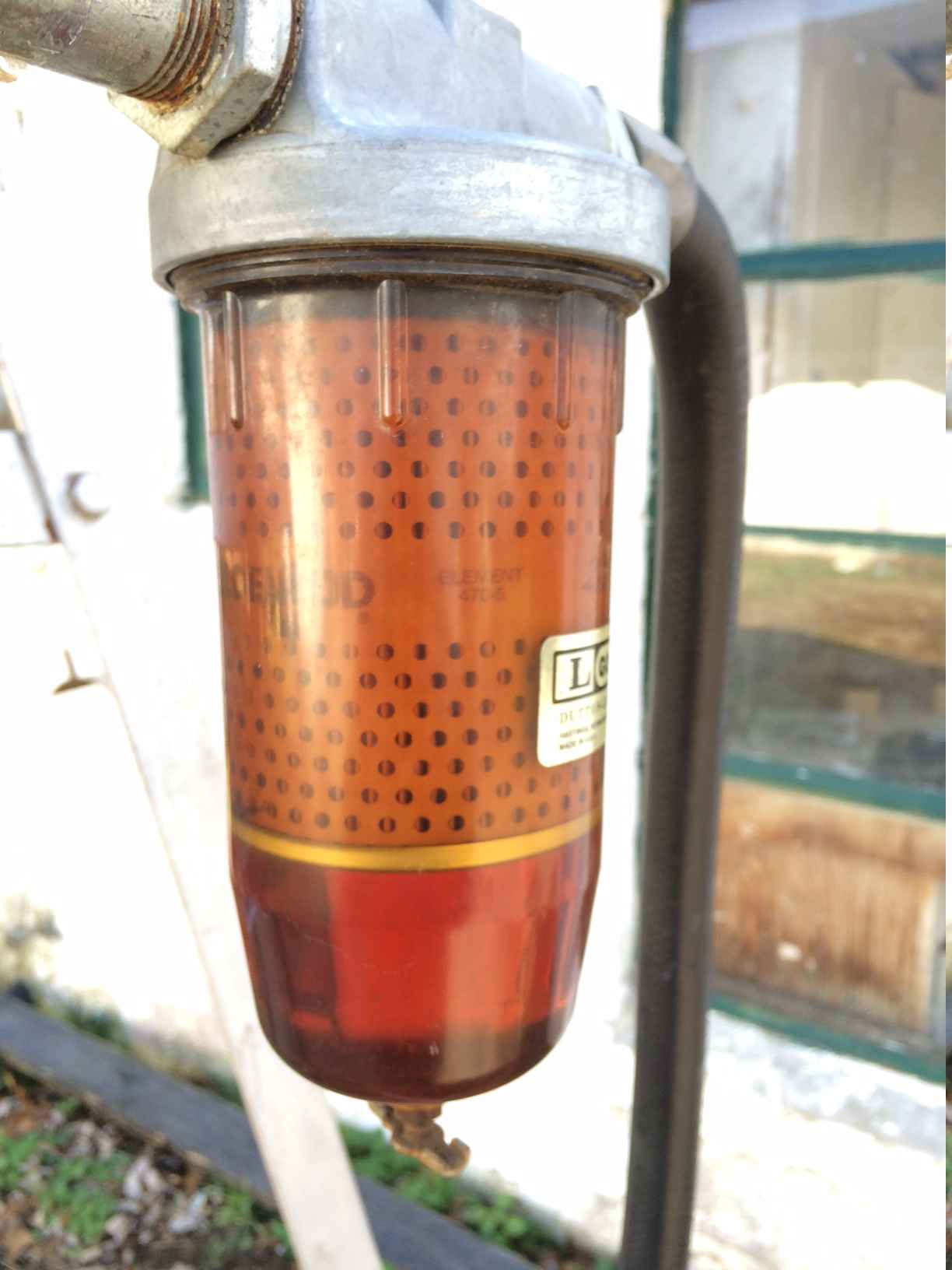

I think these pics worked:
Should show the fuel filter on the zero turn and the filter on the tank - water traping thing with a clear sight bowl. There is a little sediment, I mean just a little dusting on the bottom of the bowl.
You can see more sediment on the mower filter.
Seems like it should not get through the filters...
Is the tank junk?

That is water in the bottom filter mixed with dirt/rust. Shouldn't of made it through the tank filter since most of the tank filters are 10 micron, and the filter on the mower is around 60-75 micron. No water in the tank filter, makes me wonder if it didn't come out of the hose.
   / Bulk Gasoline Tank - Possible Contamination #6
Get a water absorption 10 micron filter for your tank and that will help get rid of the rusty water condition. The water may be getting thru the present filter you are using and settling in the mower tank. Looks like it is time to change the mower filter. As long as the filters are catching the water, I would keep using the fuel.
DO you have your stand tank tilted so the hose end is at least 2-3 inches higher than the other end. This gives the water a place to settle out and not come out in your fuel. Hopefully your stand tank has a drain on the low end that can be opened occasionally to drain off any settlements. If not, at each time you empty the contents, tilt the tank toward the hose, let it set for an hour or so and drain out the fuel till no more water comes out. I would remove the filter if possible (reinstall the clear housing)so it doesn't contaminate it. Your photo doesn't show a valve installed prior to the filter but I would assume that you have one.

Discolored stuff in mower filter
There was water in the hose from the tank - the dispensing handle was positioned such that water ran around the tank and into the nozzle. Water then was put into mower tank, and ended up in filter. Clean up was a new filter, a quick split of the mower carb to remove water from bowl, some Heet for the mower tank and a bunch of fresh gas.
Discolored gas -
I did several things and the discoloration went away - rinsed out the tank with gasoline and got out as much of the rust and gack out of the bottom as I could. There is a drain, but it is rusted shut. It all has to come out the valve end. I THINK the discoloration was because the tank was used for diesel, and allowed to sit for a while. The rust discolored it, then the gas diluted it and off we went. A couple rinses and it cleared.
The tank was then and is now set with the outlet higher than the rear. This keeps the crap and water away from the outlet. When the tank gets close to empty I remove the filter and tilt the tank and let more crap drop out. I then refil the tank, and wait a day or so and no cloudiness. I'll probably do this few more times then just use it.
