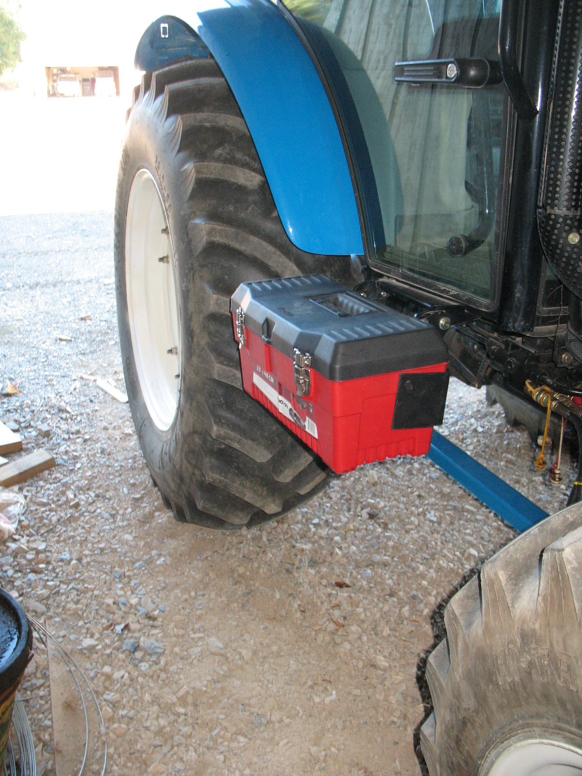

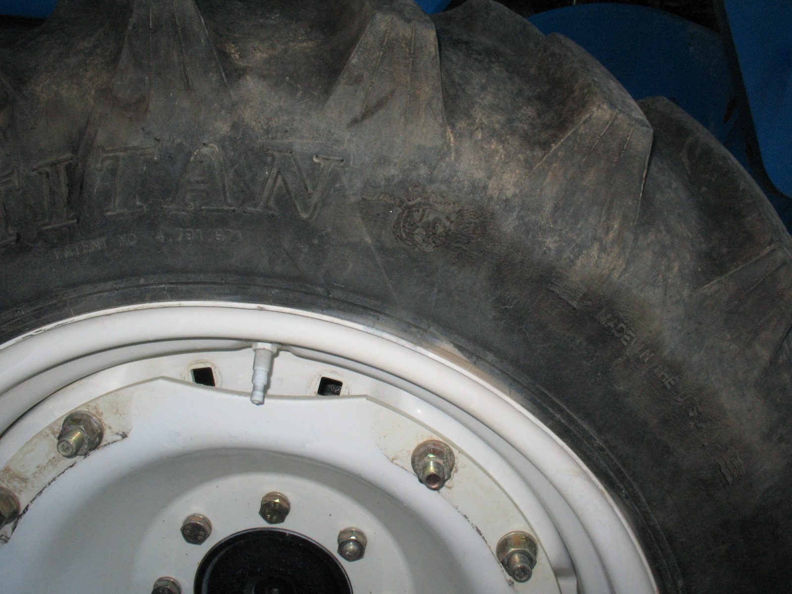

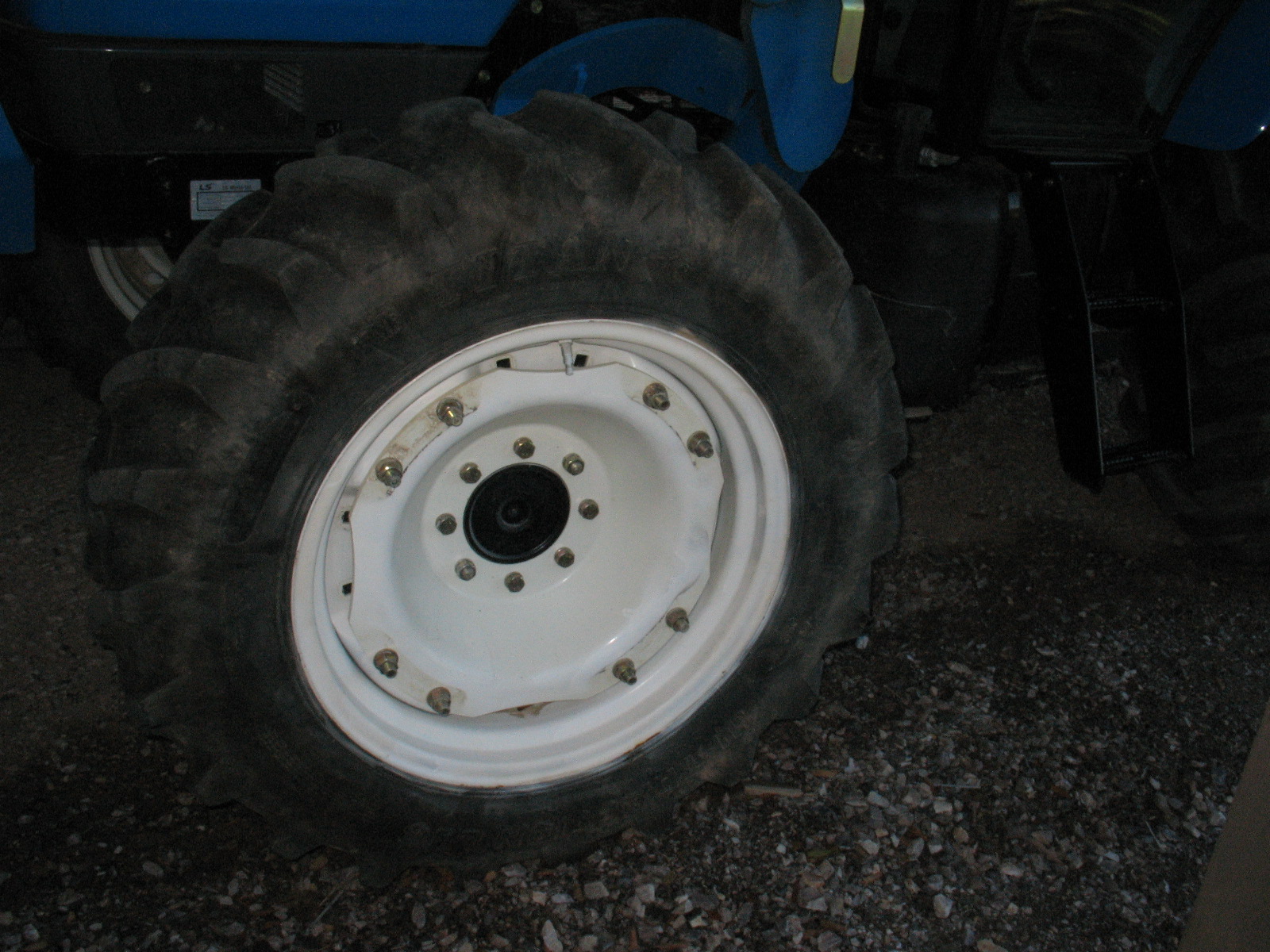

I have a couple showing how I changed the tire width by moving the location of the hub to the rim and a couple of the tool box bracket installation.

Well first photo of tractor on trailer got in by mistake and I cant seem to remove it, so just disregard it.

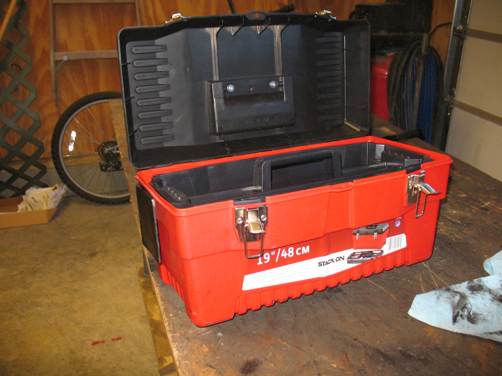

I could be wrong here but I think you may want to add a support on the bottom of the box. I think the weight of the tools will cause the plastic to rip/tear/break over time.
Seems like a nice job. Would be concerned about losing ground clearance but I think you'll be just fine.

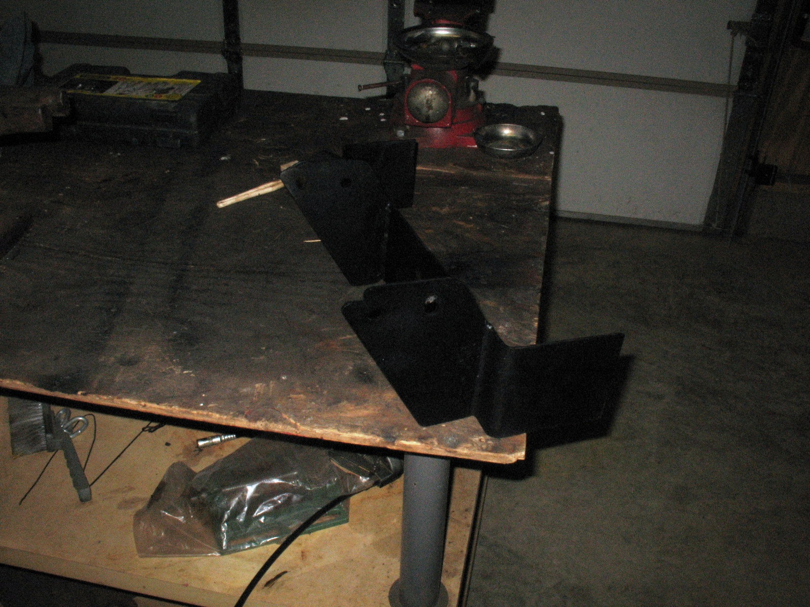

When I built the bracket, I didnt take into consideration that the tool box is not square sided and made the bracket to be level so it ended up tilted a bit to make the tool box be level, but it worked out pretty good. I had to do some trimming on the bracket where it mounts to the tractor to allow the TB lid to open fully but all in all it worked out well.
As for the tire movement, you can see from the photos where it was originally bolted behind the far lug location. I had to remove the tire rim and center hub to relocate to the front side from the back side. You can see from the photos that it is now identically mounted as the back tire so they are same width now.

Put 20 lbs of tools in it and watch what the box does. The plastic back wall of the box will want to rip where it meets the side walls of the box. This should show itself quite quickly with very little weight.

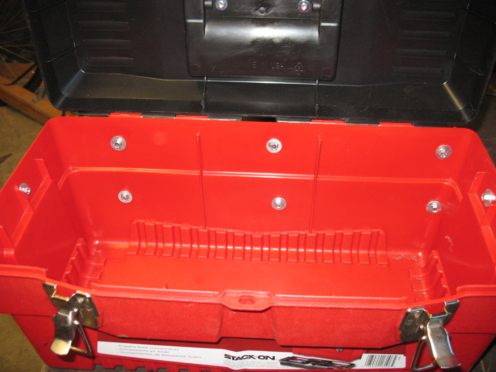

I had a plastic box mounted up front with only 4 screws holding it and it broke 2 of the screws loose but never pulled a head thru. I had much more than 20 pounds of tools in it and the box weighed at least 10 pounds or more, it was the kind about 24" high with wheels to roll it around(Walmart special) that I bought as a spare box to have at my shop before I moved to Bismarck from Houston. It was inconvenient as all heck to get to as you had to have the FEL up to get to it and it completely blocked the hood mounted headlights. Metal boxes will rust out pretty fast from mud and water splashing on them.
I put 8 screws on this one with 1" diameter washers so it should be good. The bracket is built to hold tightly to the box also so the screws just hold it on place. It wouldnt fall thru if it had no screws.

Gary: looks good to me. Its about the only place to mount a box that we have on these cab tractors. As for ground clearance, it looks like a step on that side would be about the same level. I have considered the same location for my JD. Metal does rust for sure so if you are happy with the heaviness of your plastic box, then you should be good to go. It looks good to me and sure beats having chains and tools rattling around on the floor (or forgetting you put 'em in the bucket and dump 'em out,..ha,ha!)

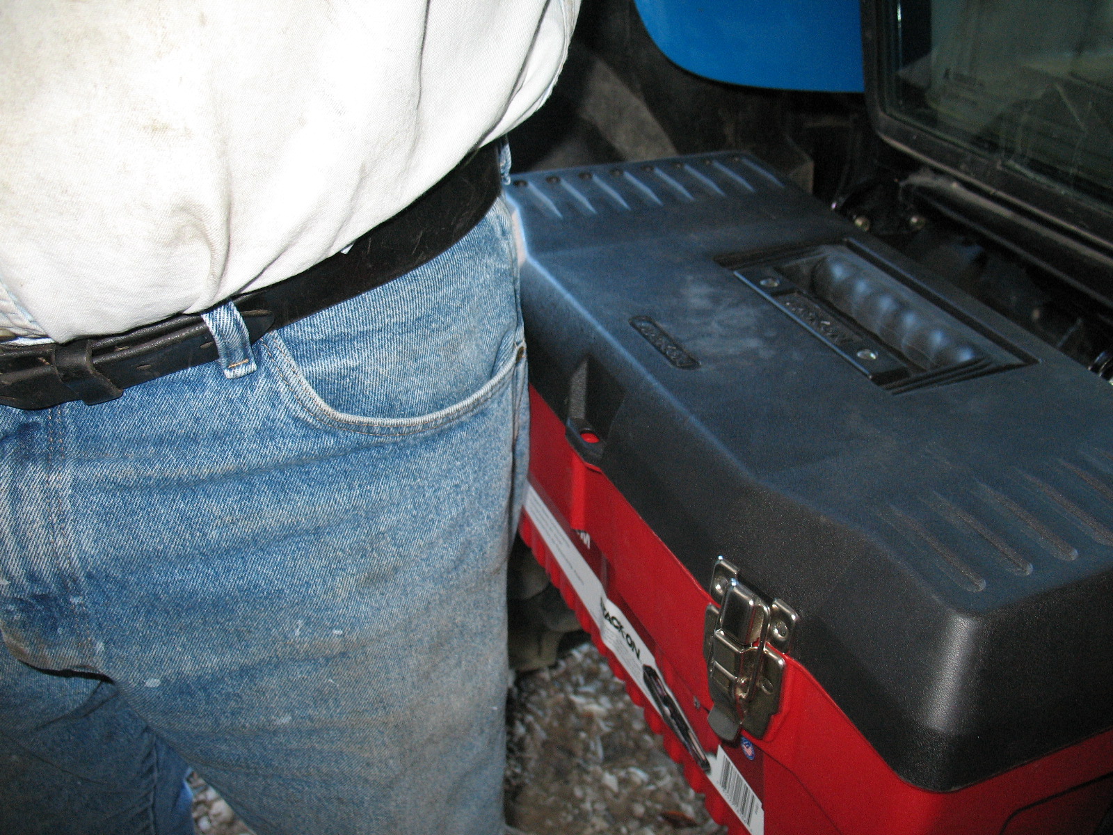

Actually the bottom of the box is where the second step was at and top is nearly level with bottom of the door. Notice the photo of me standing next to it, its nearly waist high at the top and mid thigh at the bottom. Smaller tractors wouldnt have so much ground clearance but still should be plenty to avoid rubbing it off on brush. I guess one could always put on a skid plate in front of it if he used his tractor for a dozer or something in the woods. The bottom of the box is still higher than the bottom of my fuel tank which is on the opposite side
