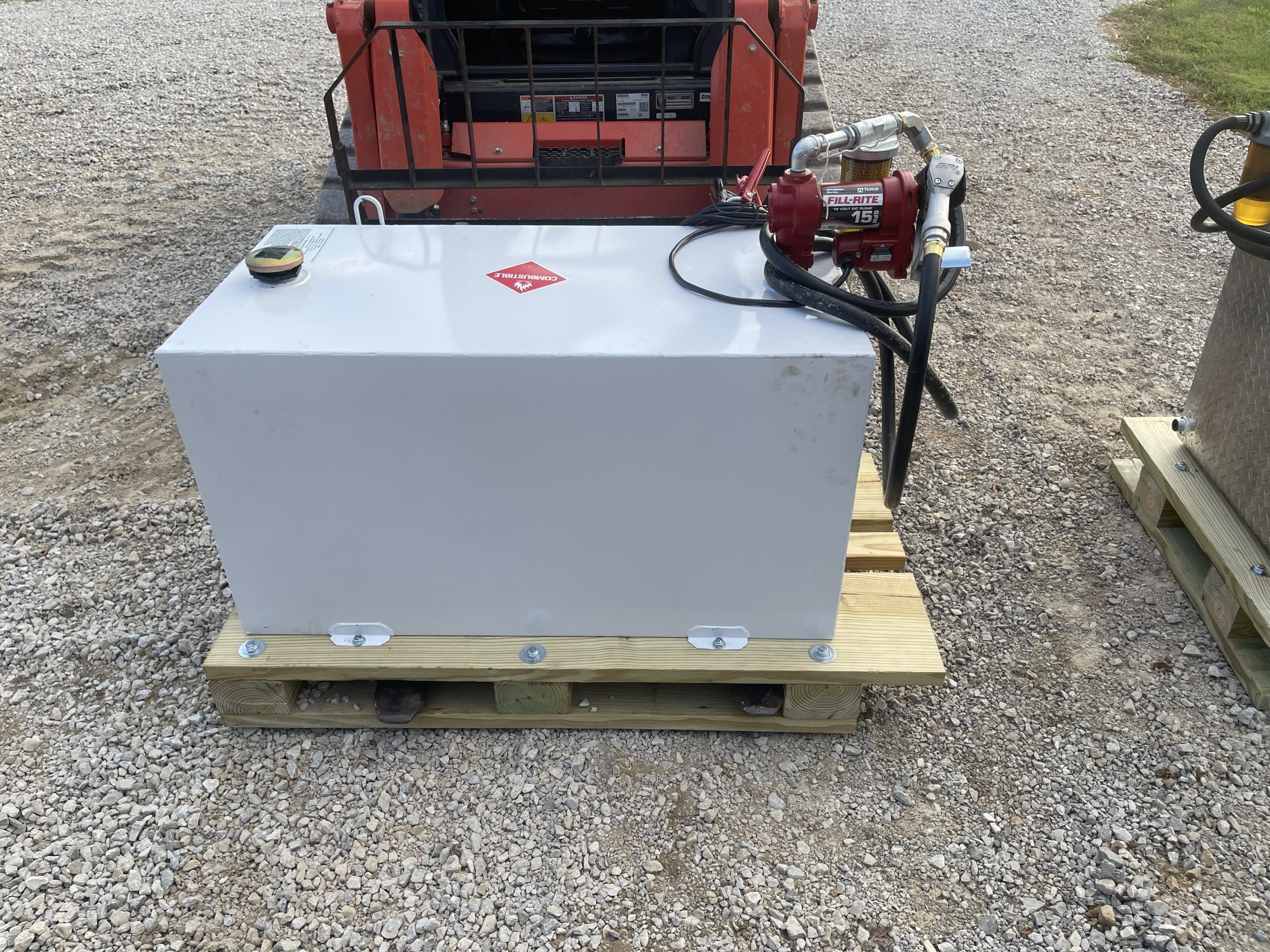

Built a new diesel tank dealio…or put one together. Had 50 gallon tank forever but lately just tired of alway running out. I like them to be portable and I use battery clamps so whatever I’m filling up I just use it’s battery.
The new one is a 100 gallon. On a side note went with a fill rite 15gpm. Seems good but it’s pretty strong. My old one is gpi and not sure what gpm is but it a little less I think.
Anyways, I was thinking of selling the 50 gallon but started thinking maybe use it for gas. My question is how safe are the 12volt transfer pumps with gas? I don’t use gas much other than power washer, mower, generator, and atv/dirt bikes.(guess that actually a lot)
I could clean it out and use it for gas.
What’s the 411 on 12 volt transfers?
Here’s some pics..

Your new Fill Rite pump is rated for gasoline, and most of the GPI pumps I looked at are also. I suspect your biggest concern would be the clamp on 12v battery cables creating a spark around potential vapors.
That said, I have never noted any sparks when I hook up my diesel transfer pump, though I'm sure it would if the pump switch was on while hooking up to the battery. I say confirm your model GPI is rated for gasoline, and just be careful with the clamps.
When I was storing and using 55 gallons of gas I used a GPI hand cranking pump.

Ok, ill have to look up the model. Its about 15 years old i think and the sticker is rough. As far as the spark, the clamps would be far away from the tank when using.,

Unless tank states for flammable fuel, don't do it! Most tanks are for combustible fuels. Plus most states limit the amount of gasoline you're allowed to transport in a portable tank. Check DOT and local laws concerning transportation of gasoline.

If transferring gas make sure you have proper grounding between tank and equipment. Fuel flowing can cause static.
