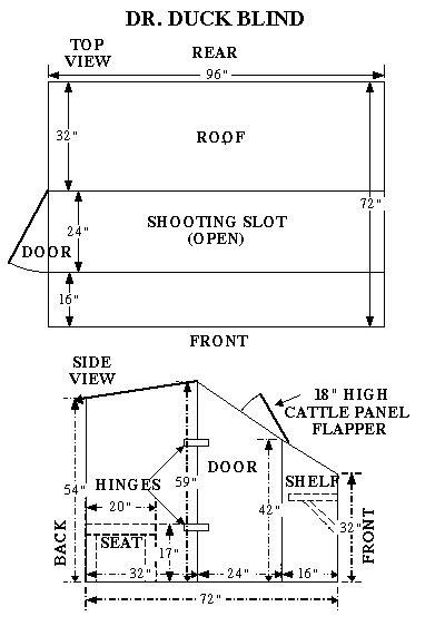

I am getting into duck hunting on my property this year and was thinking of building a ground blind that is mainly for duck hunting but could be moved with the folks of tractor for turkey or deer in the back. I found some plans and like them. Please do not tell me to go to walmart and buy a tent it will not do for this purpose. For duck hunting we will need to have at least 4 hunters in the blind for duck and goose. It will be a lot cheaper to move it with tractor then build on a wagon, as I will not take off my property.
So when you give me your comments remember
It can not fully enclosed
Do not suggest a tent
Do not tell me to build on a wagon
I am going to help hide mass around ponds with hay bales so I do not
want high it must sit on ground.
Here are the plans I found but would like some suggests about how
to build better and how by changing something out I can use for deer or
turkey build. IT would be nice to get out of wind here in during deer season.
Found this on web site
SPECS
Materials: 1/2" CCA plywood; 2x4 CCA boards; 3" galvanized screws. Start by building a 6' x 8' braced frame and attach plywood for floor. Build the 2x4 upright fame on 2 foot centers. Cut and fasten plywood walls and roof. Cut and frame door and fasten hinges on outside with latch hook on inside. Mount plywood for shelf as shown. For hinged flapper to cover the shooting slot, use a piece of light wire cattle panel 18" high and long as the blind. Fasten bottom of panel to front of blind with eye bolts for hinges.

Just trying to help. After reviewing the plans that you posted, I cannot see or visualize FOUR hunters being able to utilize this design to hunt and shoot SAFELY out of. Notice that I capitalized the words FOUR and SAFELY. As I recall, the commentator describing the design and layout of the plans, suggested that all possible buyers or users of these plans bring along a friend. Am I missing a vital point here. It appears that he is talking about two hunters--here.I was duck hunting on the Holston River in Hawkins County Tennessee when I was six years old with my Dad and hunted ducks every seasen for 30 years. Years of deer hunting also, only a little turkey hunting experience. Maybe I worked too hard today and I am tired, but if I missed something, would another member out there help me.In regards to FOUR hunters SAFELY. Thanks. I, along with everyone else, am only trying to help. Happy Tractoring.:tractor::tractor:

I have hunted ducks out of a very similar blind for about 15 years. I too think the blind would be a bit small for four people. We built ours out of PT and do not have the flapper. Each year we dress the blind with oak branches (the leaves stay on a long time) and the blind is permanent. We also built a blind that we can pull the boat into that is cedar poles sunk into the marsh with pole cross members and dressed with bundles of cat tails and grasses. I have tried to make multiple purpose blinds out of conduit and PVC but find that nothing beats the comfort of a well built permanent blind. For deer I use elevated blinds built like treehouses about 12 to 15 feet off the ground. Turkey I use my porch!
If I really wanted to make the blind tranportable, I would put in a permanent foundation for it to rest on wherever I wanted to use it -- that way it would be fast to relocate and be stable when I did so. Put together with removable pin hinges, the walls and roof could be "knocked down" fo transport or storage. I will be interested to see what others suggest since I too am always looking for ways to improve the blinds -- as an old acqaintance of mine used to say --"any fool can be uncomfortable"

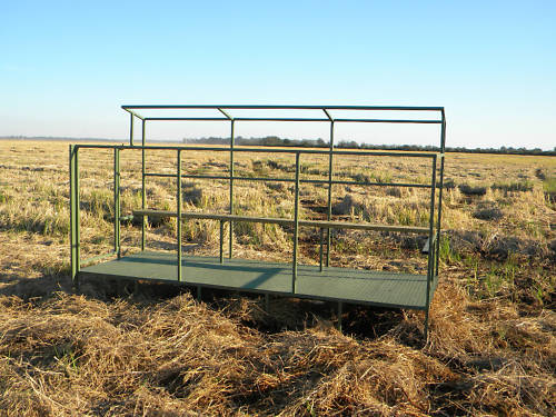

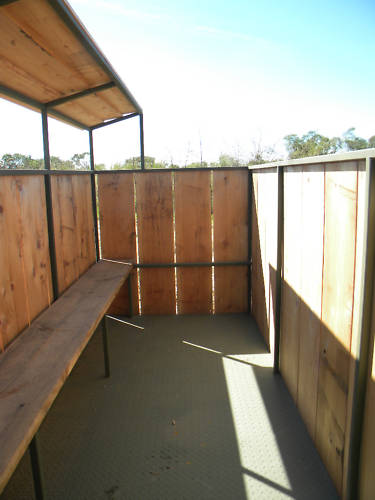

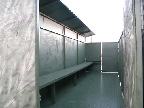

How long should the blind be for 4 hunters? Have been out of touch lost power with storm so much damage people loosing their homes. Pretty bad in our area.

For four people to be able to stand and shoot safely I would think you would want to double the length to 16' so each shooter has a 4' area to swing the gun without bumping into anyone. That or build two of these 8' blinds and stack them next to each other so you can still move them easily but then you have two blinds you can use for deer season.
