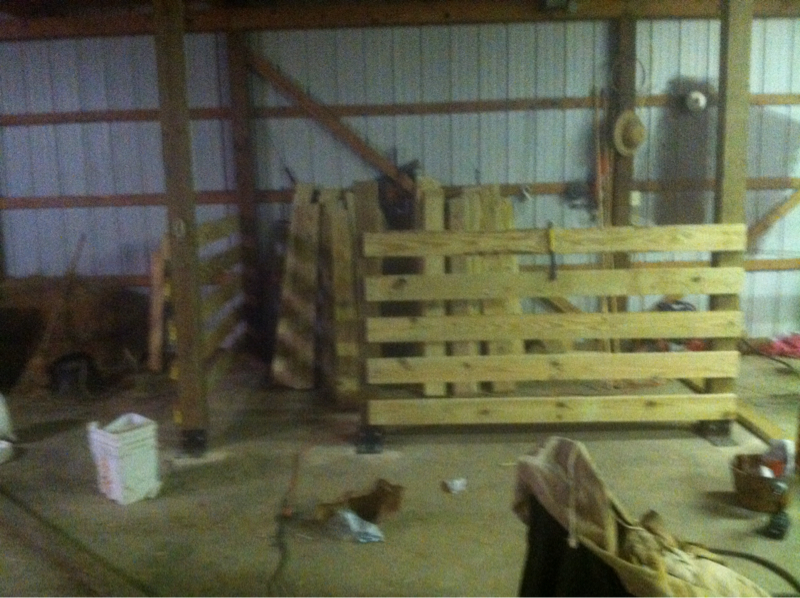

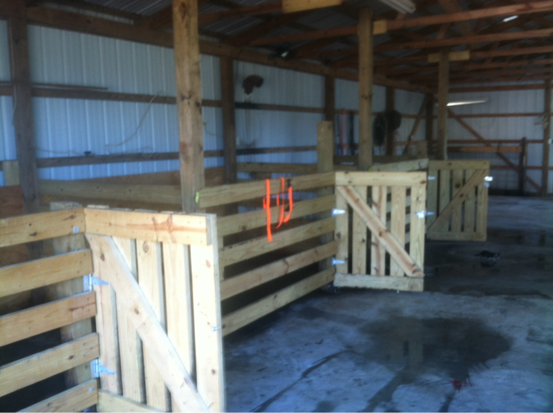

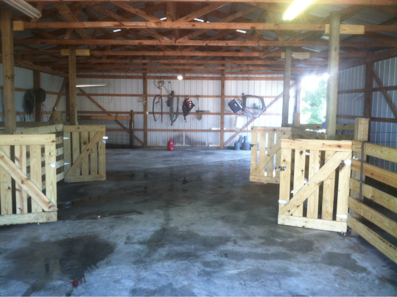

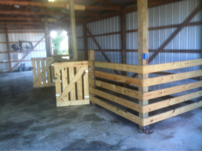

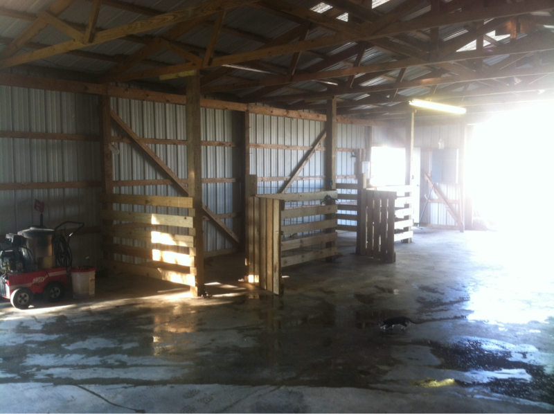

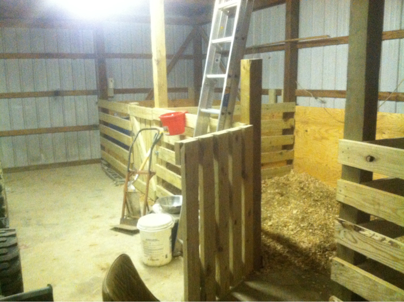

Mine is anchored to the floor, used a Hilti gun and put 1/2 inch anchors to hold 5x5 posts, tied to the rafters on top. I have 2x6 treated for the that ties posts to post with everything screwed together with large decksrews and lag bolts. I am adding lofts for storage possibly this winter. I would definetly tie the post to the concrete. We raise pigs me they will wreck stuff without meaning to, and ours are tame showpigs. Hear our some pics. They are not real good but maybe they will help! LUTT

Abriso, I don't remember and I am off at work right now, I will be in Friday and take some measurements. I would not use pig panels, there not tall enough and too flimsy without good backing. Pens are roughly 10 wide, I used the exsisting 6x6 timbers that are part of pole barn structure, which are 10 feet apart. They are about 8 wide, it leave plenty of space to get the tractor in for cleaning the stalls. We use pine shaving for the bedding. The building is 30x50. Steel is another option or what I'm gonna do in the future is polly poured concrete walls. More sanitary and sometimes pigs really don't new to see each other. And they cannot tear them down. I have had trouble with a couple of market guilts chewing on the lower boards. They are fins to go to the slaughter house though. LUTT
