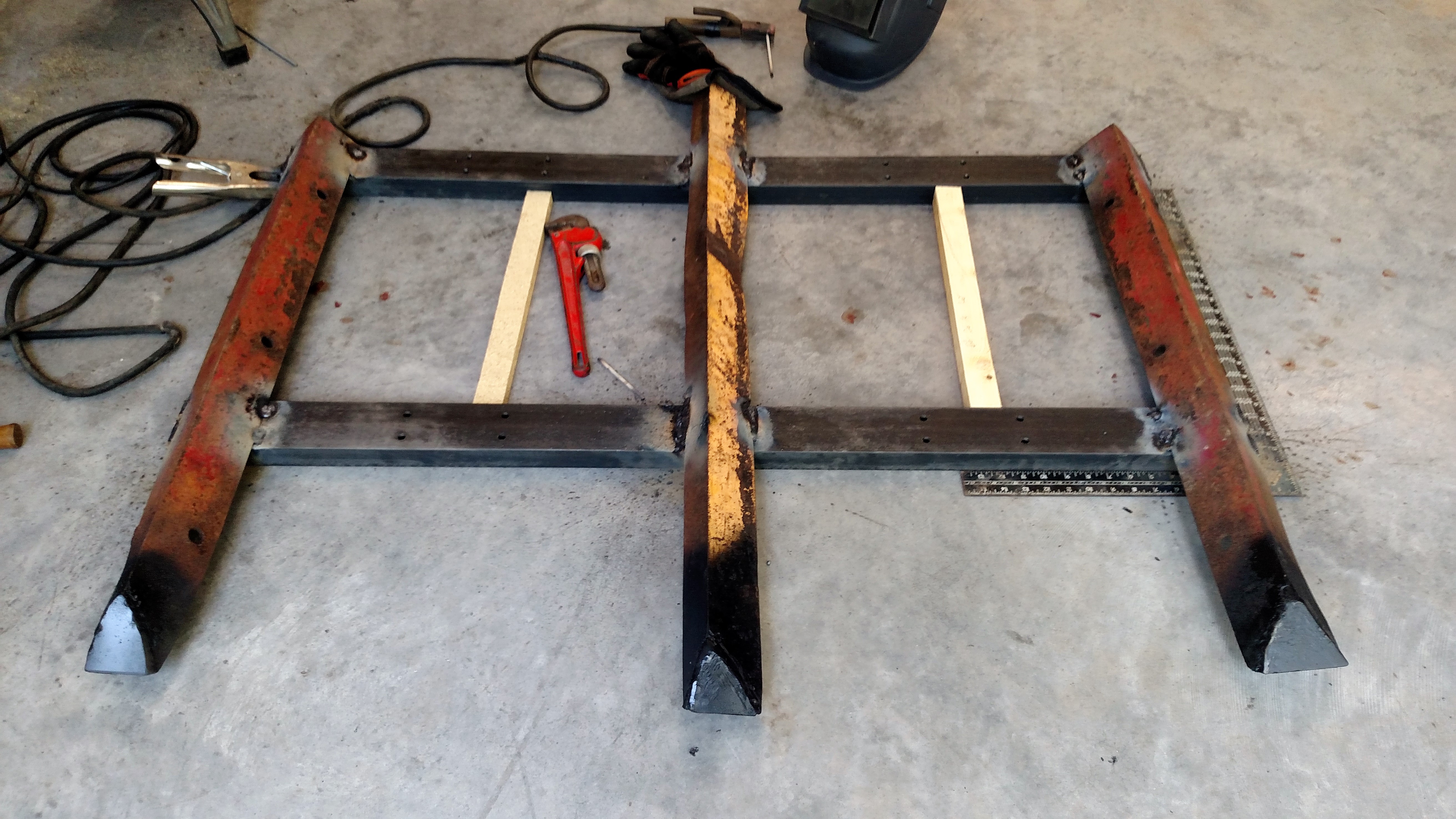

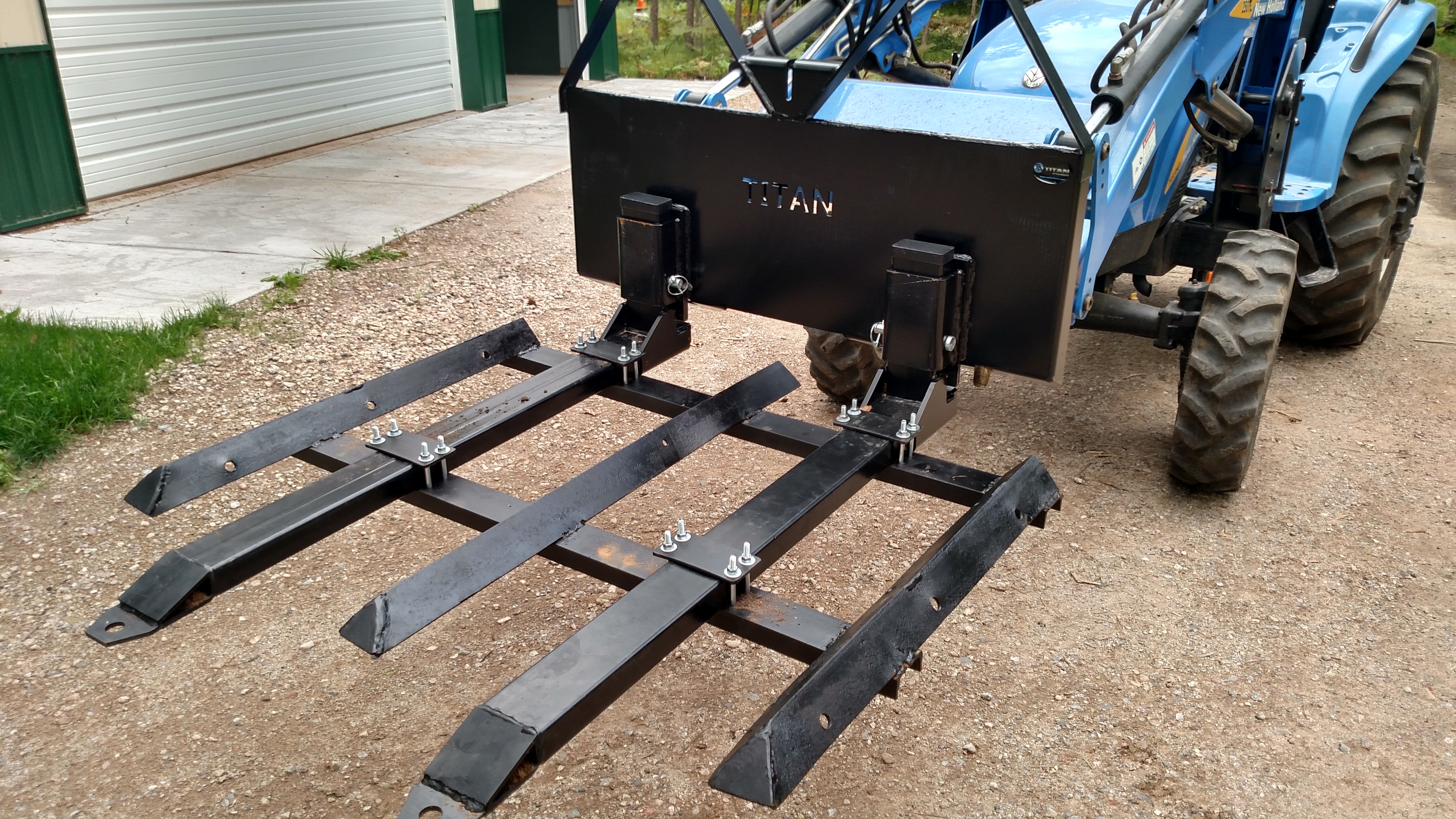

I bolted some old angle iron on to my forks to make a debris fork. They work great.

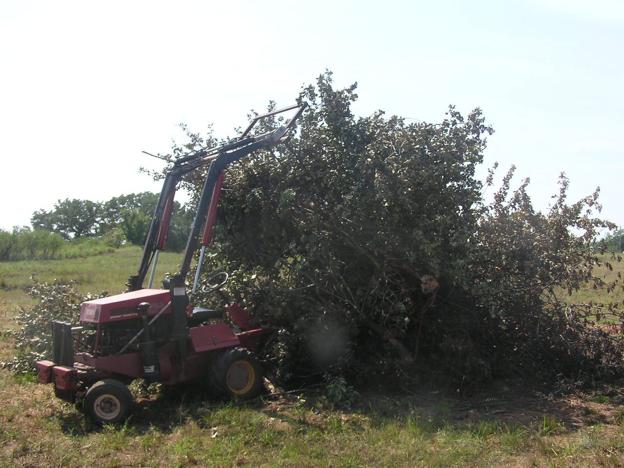

Found a guard off some machine, its expanded metal and when secured in FEL bucket makes about a 4 foot square "basket"....
Any sort of big box or basket the will secure to FEL bucket is possible slash hauler....

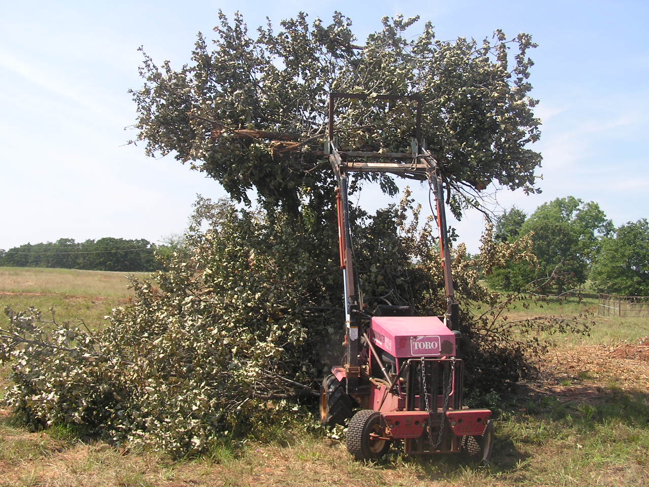

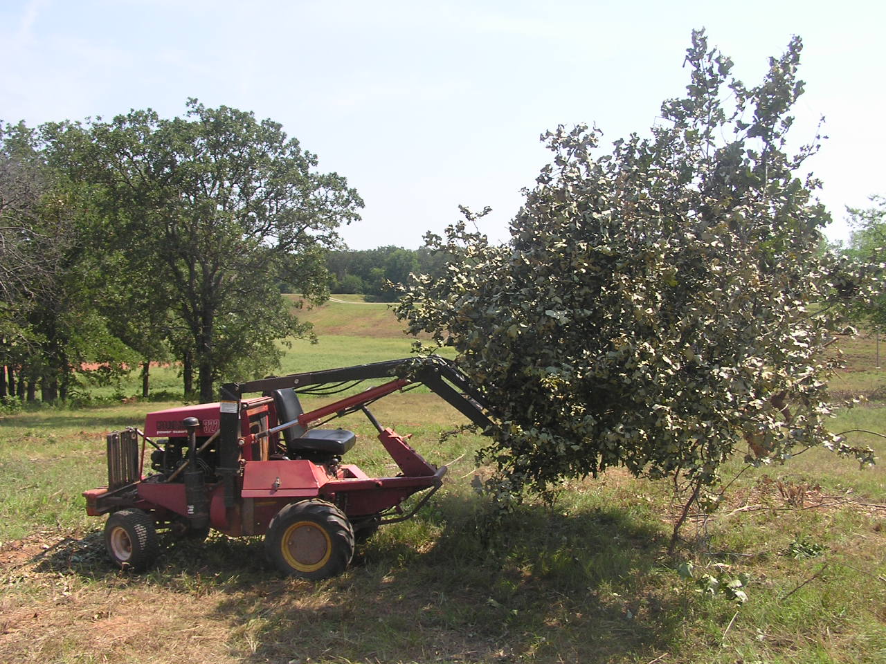

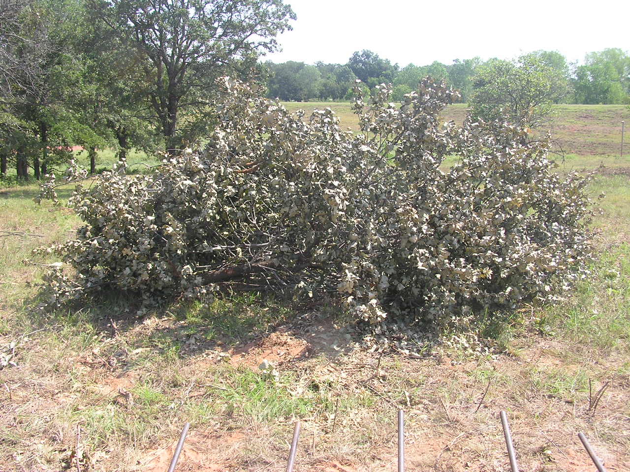

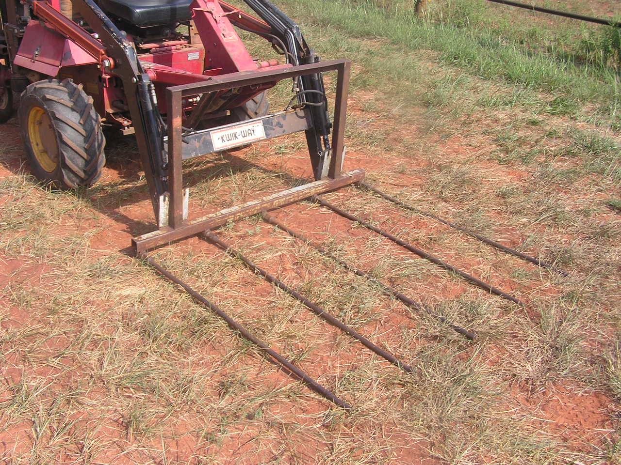

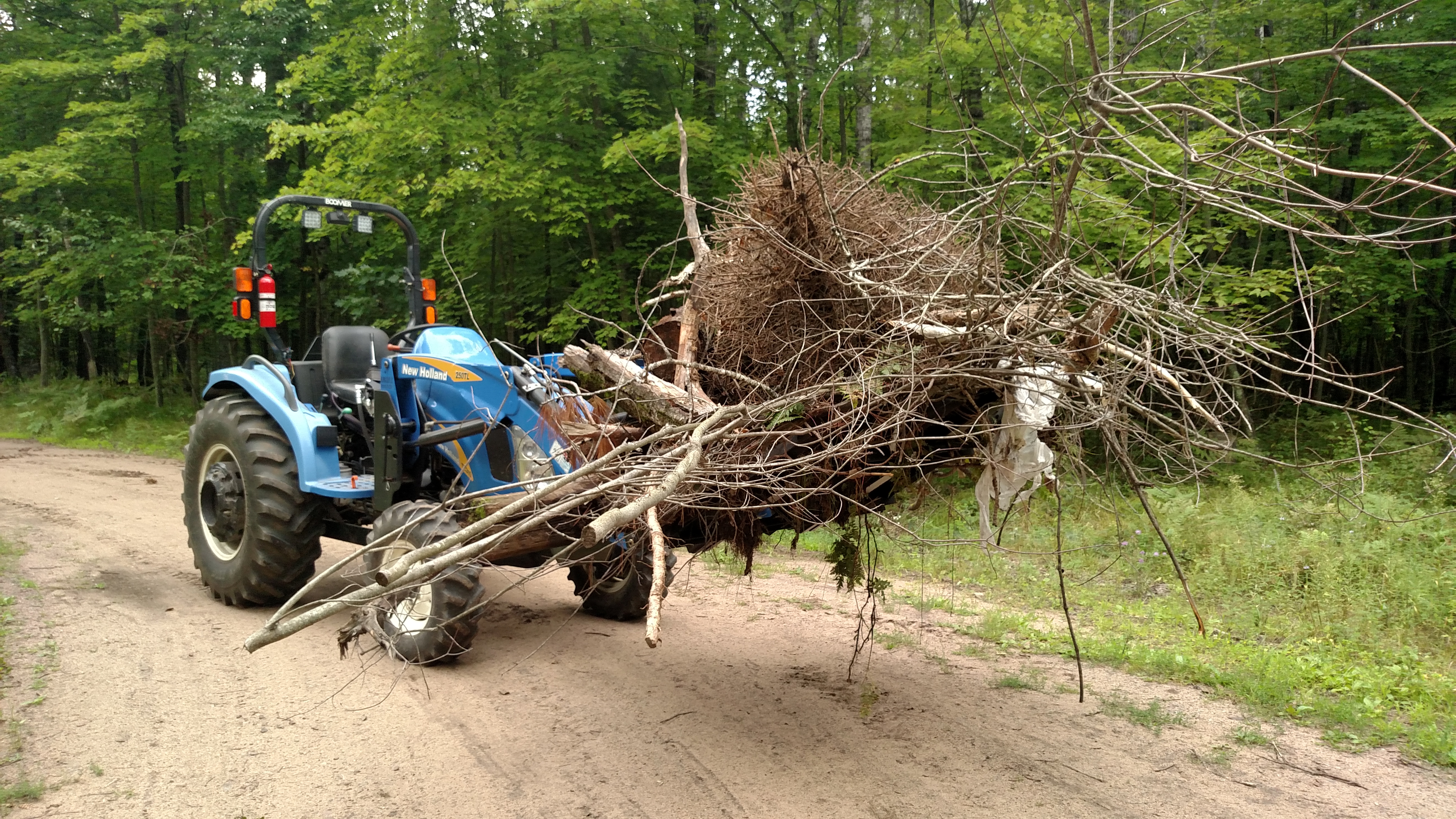

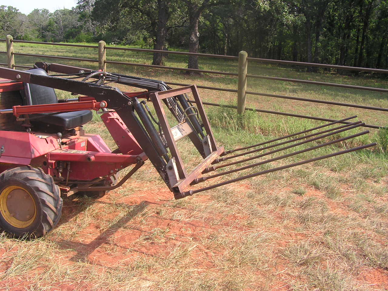

I made mine from 4' long metal rods that screw into the frame:
Just drive into the slash and pick it up:
Take it to the pile and dump it:
