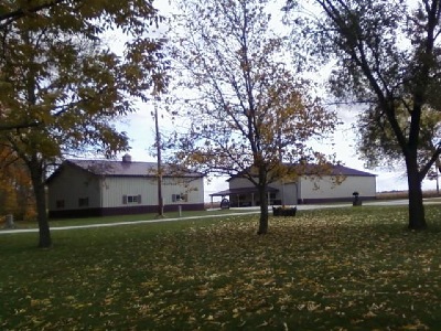

Planning on building a 40X40X12 pole barn and have decided to go with laminated poles/columns for sake of them remaining straighter mainly during the build.(I am building it by myself so they may be exposed several weeks...) These are the type consisting of 3 treated pine 2x6's for ground contact and #1 southern pine above that. I have not been able to find a supplier in the south for these. The closest place I can find is Menards in Kentucky. We don't have Menards down south hea. Does anyone know of a supplier within a couple hundred miles of Athens Georgia?
If I can't find any local, I guess I will be building my own but the problem that arises then is finding 2x6's treated for IN Ground contact. Also, while I am asking..... southern pine is still prone to more warping than say spruce. If I build my own, what would be the problem with using spruce (I think they refer to it as white wood these days?)

The couple of pole barn structures I built used treated 6x6 tamped with gravel. The top 1.5 ft of fine gravel was mixed in a bucket with Copper II preservative:
It's likely not necessary but may help prevent rot, which mainly happens near the surface.
   / Building Pole Barn, need help re laminated poles #7
On the last two large buildings built here with laminated posts, the treated 3 2X6 bottom sections are set in the ground with sackrete. Then a jig is used with a lazer and the treated posts were all sawed to the same heights, stair-stepped. The walls were bulit in sections and then set on the treated stub posts with a loader.
They do not build them like they did with 6X6's. I have seen some built where the bottom treated stub posts were put in and the skirt board and the concrete floor poured befored building the rest of the barn.
