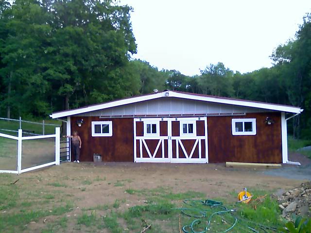

I would recommend a Klene Pipe building. If you have a level area the pipe frames are easy to assemble and get square and plumb. The basic building module is a 12' x 24' run in type shed. If you put two of these facing one another you can have a building with a center peak roof. Tabs are welded on the pipes that you connect 2x4 lumber to use as nailers to attach exterior and interior siding. You can add whatever kind of siding and roofing, door, and windows you want to put in it. My wife and I were able to build a 36' x 36' horse barn using one of their frame kits.

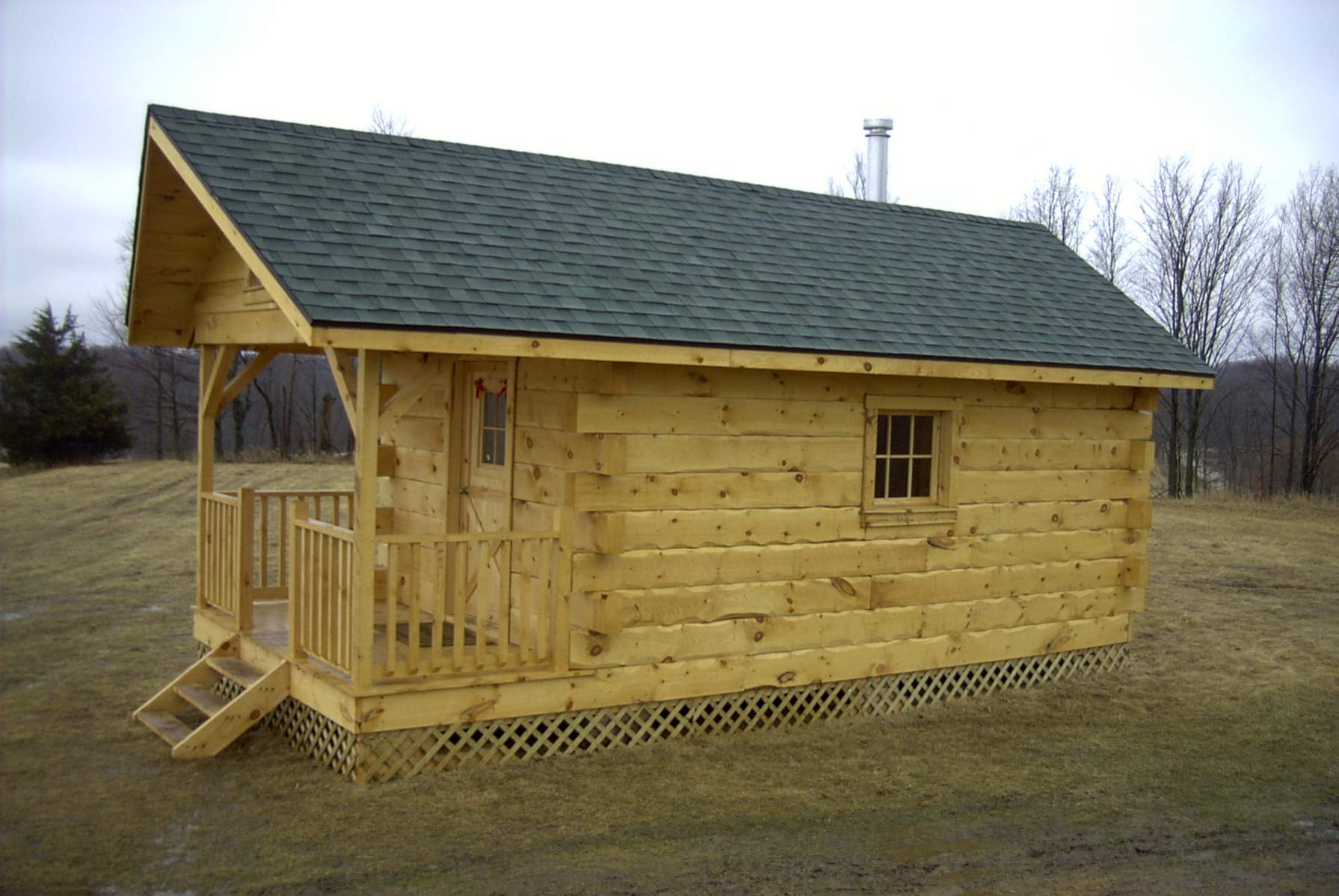

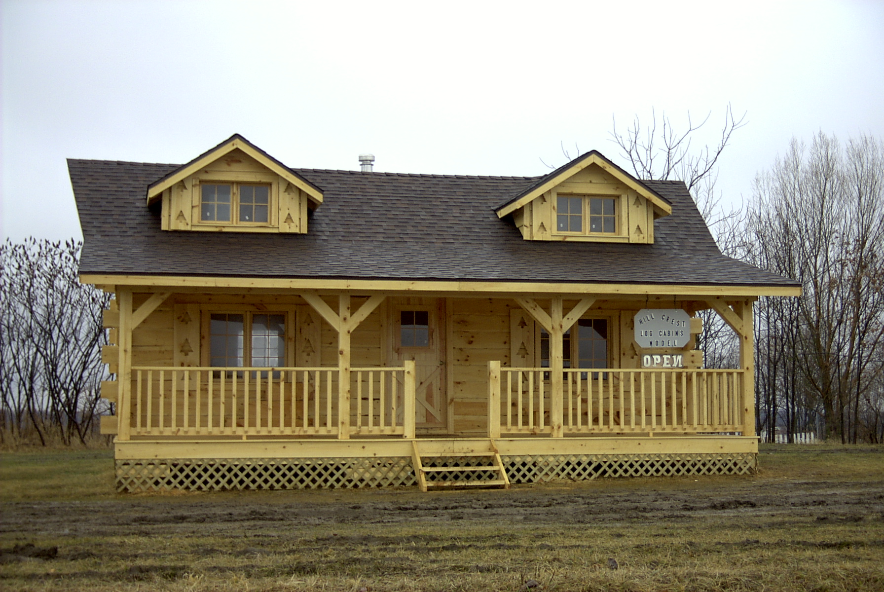

Here is an example of the Amish builder near me. These are CABINS but you can have them build any style you want. For example this cabin is 24 X 30 and costs $15,500. Of course the small one is much less.
Imagine your guests sitting on that Porch!! If you are anywhere near them, go talk and see what they can do within your budget.
jim

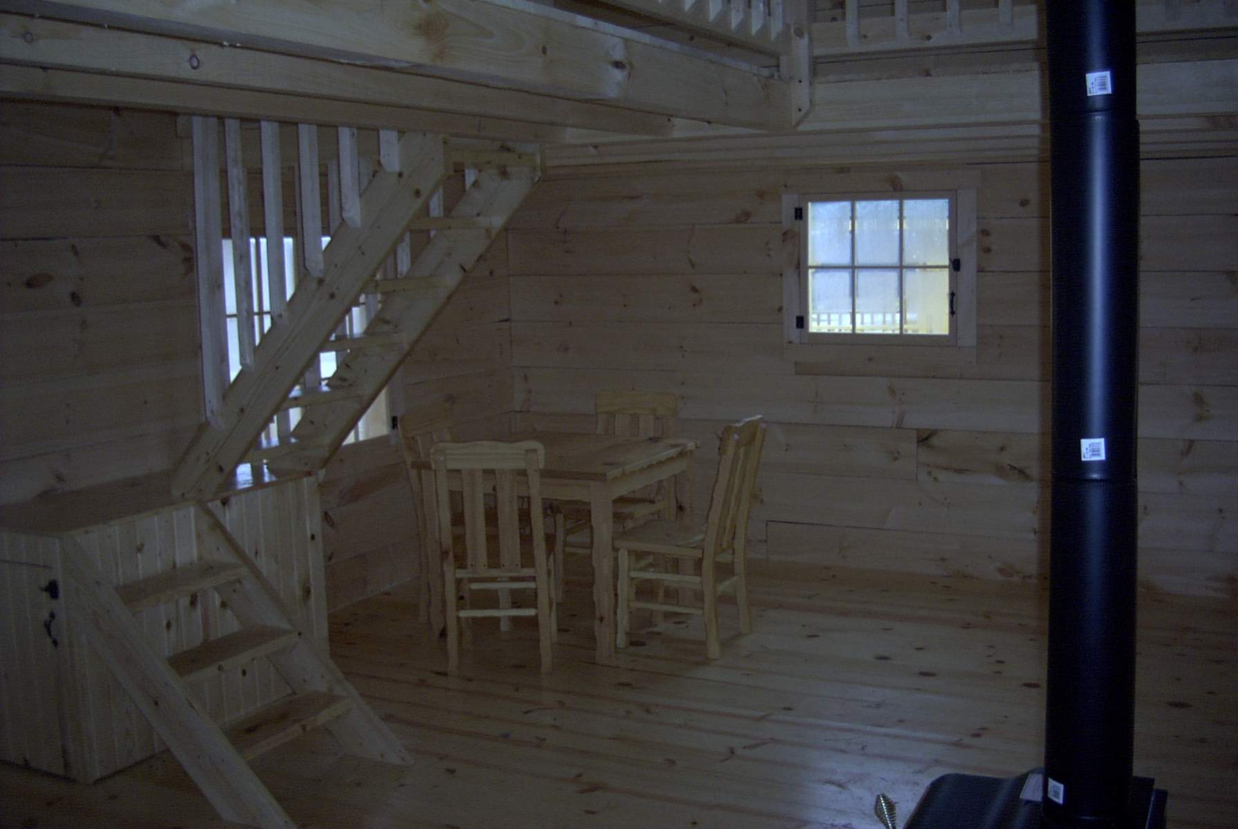

This guy is over by Richland Center, WI but there are quite a few around, in Cashton, Hillsboro, Sparta, WI. I thought it was REAL nice. I thought I had a picture of the small kitchen, he made cabinets from t-g carsiding. BEAUTIFUL. Notice the inside/outside wood storage inside the stairway?
jim
