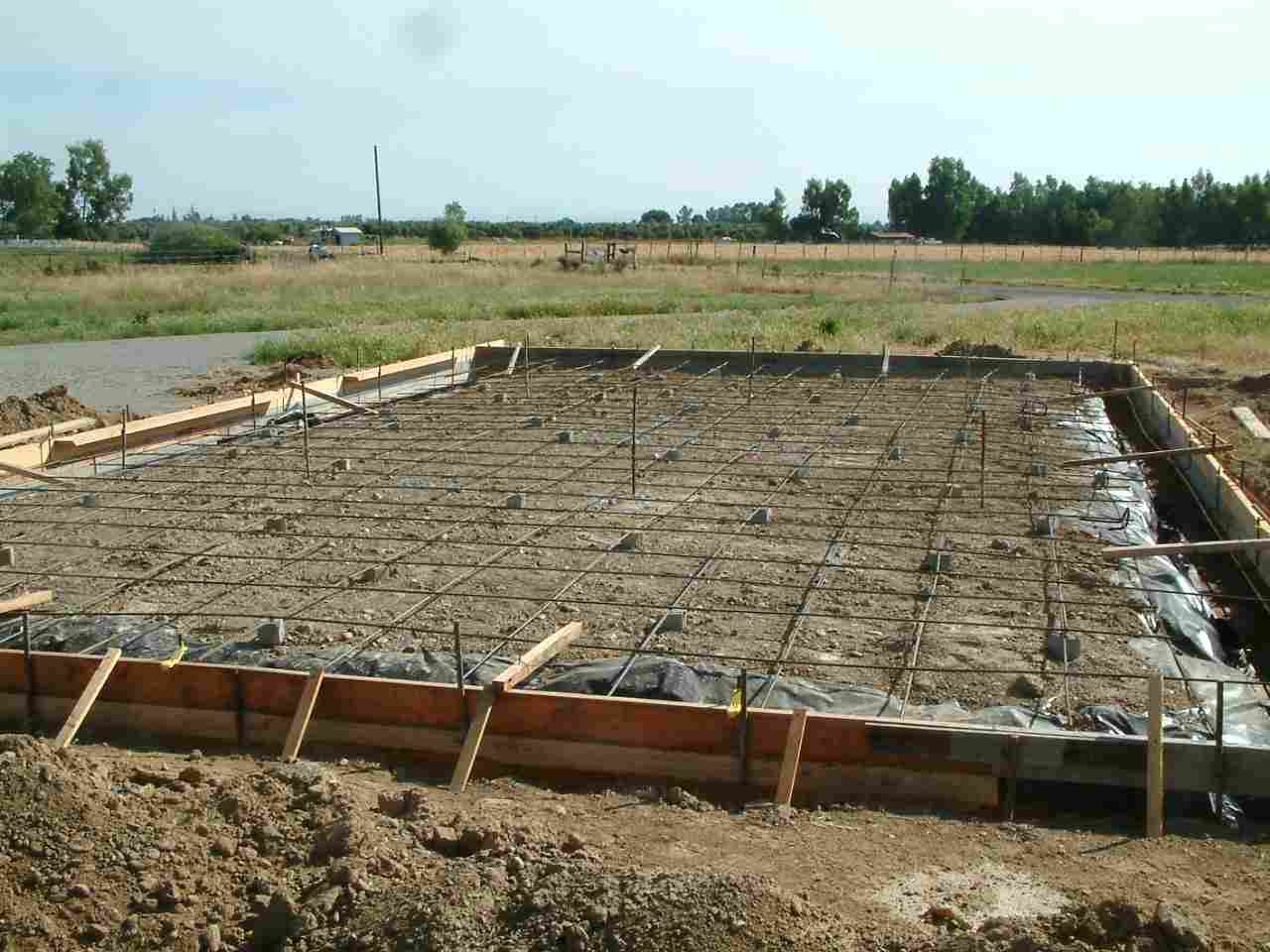

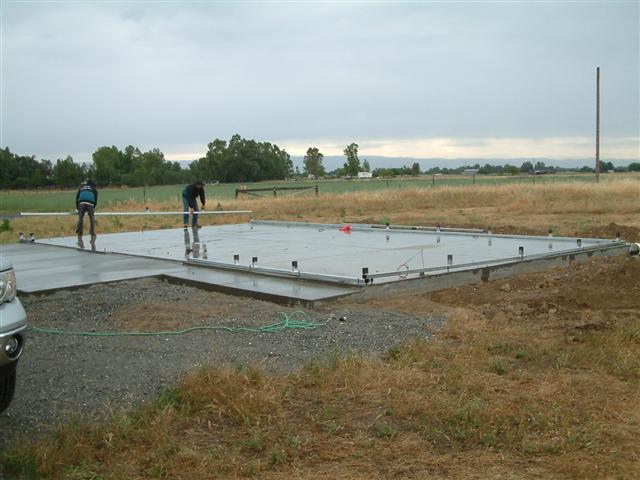

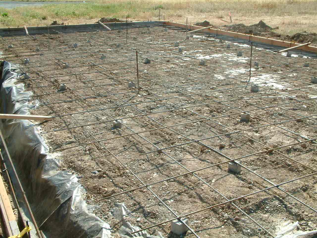

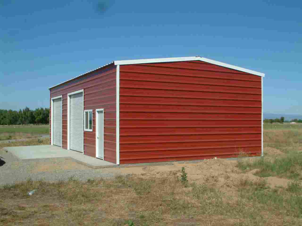

Here's how my concrete contractor poured a 24x42 ft x 6" thick slab for my shop in June 2005.
4000 psi concrete, 6" thick #4 rebar on 18" centers, 10 mil thick Visqueen plastic barrier under the slab.
Shop slab-1.jpgShop slab-2.JPGShop slab-5.JPGShop--slab finished.JPGShop-finished-1.jpg
No cold joints in that slab.
Good luck
