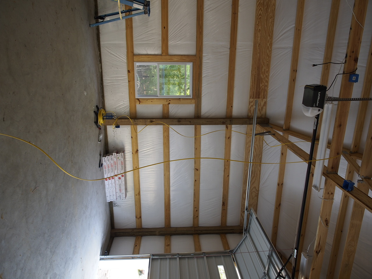

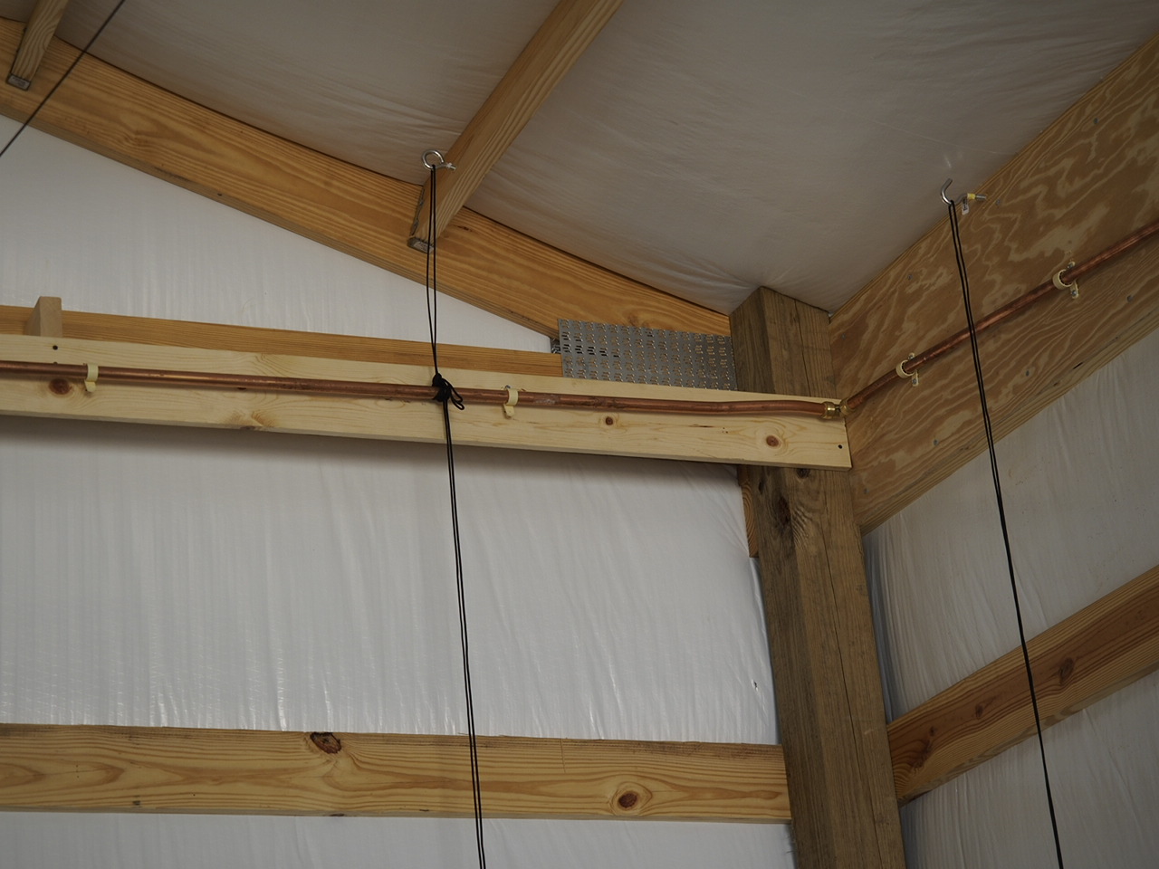

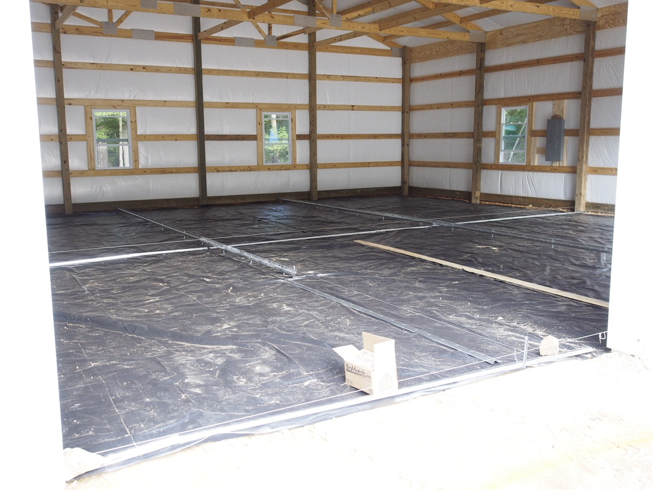

Hoover buildings recently completed a 40 x 40 x 12 for me with a roll type insulation I have never seen before and must be designed for this type of building. It is a fiberglass blanket sealed in a moderate thickness, pliable, plastic, attached before the metal skin and works very well so far in the heat.
   / Building new 36'x60' Pole Barn - Advice on venting and insulation? #8
View attachment 518482View attachment 518483View attachment 518484
What did that insulation cost out where you live? I looked at that same stuff when I did mine but it was really expensive. I came out better by adding 2x4's on the inside.......sorta like a stick built wall then went with R-15 wall insulation. Any way you go about it the insulation part of the job is going to be one of the highest cost points in the building.
You have a nice clean looking building going on there really looks good. The only drawback with that insulation is after a few years the outside layer will start to get brittle and is pretty easy to tear or punch a hole in. The stuff you used may not be the same stuff I see in a lot of buildings around here though. Anyway, you have a great looking building going on there. What's that copper looking tubing in the last pic?
