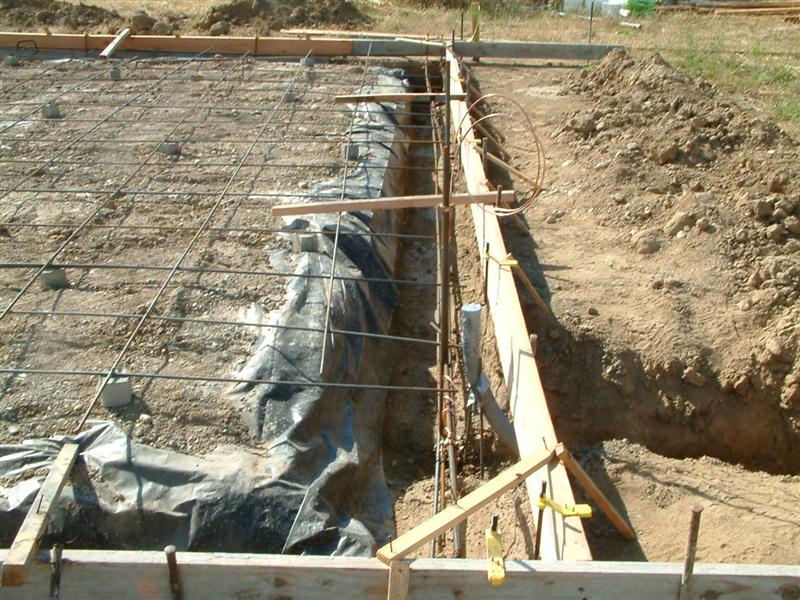

I have a "Ufer" ground installed in the concrete slab for my garage/shop (see photo).
There are two rings of #5 rebar in the footer. I attached the copper ground wire to the lower rebar ring. The building inspector made me move it to the upper ring. Didn't ask why. Just wanted the inspection sheet signed off.
