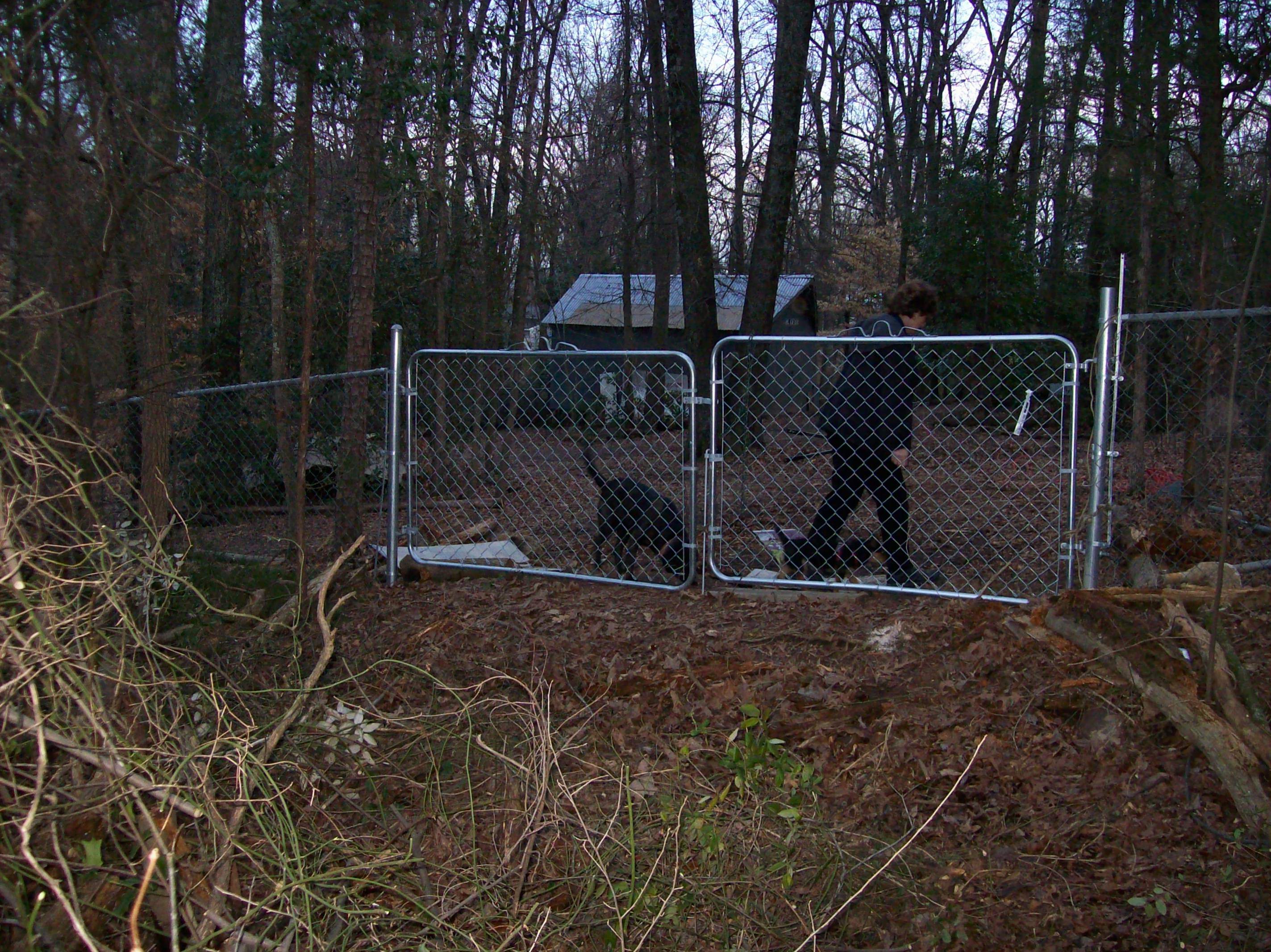

When I put our 12' double gate in, I made sure to build my gate posts plum, but hung the gates at an angle on the hinges and also placed the hinge mounts on the lower post lower than the upper the gate post.
   / Building Gates on uneven ground #4
MitchellB - were the hinge pins plumb to the poles or to the gate?
   / Building Gates on uneven ground #5
Neither actually. On my fence gates the hinge pins have somewhat adjustable bolt/nuts (an inch or so) that go through the posts in a drilled hole. I was able to move the bottom hinge pin in as tight as it would go on the upper post and the top hinge pin I just adjusted it out until the gate hung down at an acceptable level to the ground. (reversed that on the lower post) The pins probably are closer to matching the out of kilter gate than the plump posts though. We had the chain link fence installed professionally many many years ago, but last year I wanted to make a tractor drive through to the property behind us we had just purchased. So that was my first attempt at cutting out a section of chain link fence and adding a drive threw gate. Seems like all the gates that I looked at, that others had installed showed the main gate posts always looked plumb while the gates were angled and/or offset to fit the slope. Once I had the posts set in concrete the pre-made gates were easier to hang on my mild slope than I expected.
Before the section was cut out
after installed and some clearing of the tractor trail looking in the same direction.
