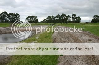

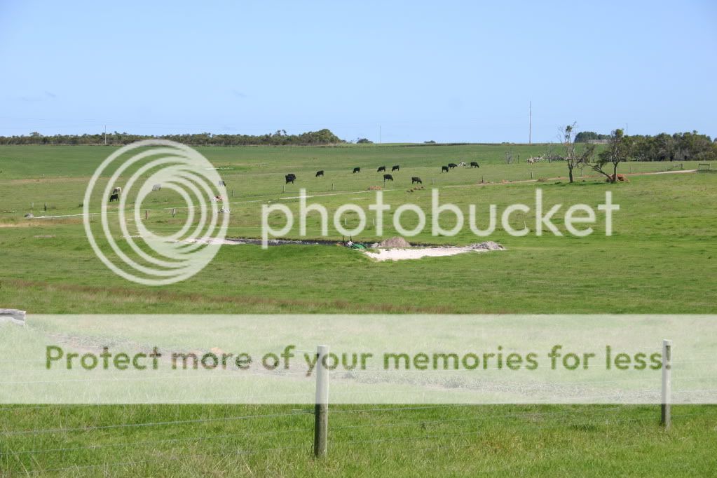

Hi All, thought i'd share a "works in progress" here as i build a second fish pond with our little JD 3120, during our "dry" season b4 the winter rains come. This has been one of the driest years on record so gives a great opportunity to build this, while having to work around the last of the water. It never ceases to amaze me how much earth these little 4 w.d. tractors can handle.
The idea here is to enlarge a previously small livestock water hole into a fish pond deep enough for fish to survive our hot summers.
From this:-
to something like this existing pond:-
The new pond will be lengthened at each end and along the long side and have soils so removed added to bank height on 3 sides. Its a bit tricky cos there is still a bit of water in the bottom to work around.

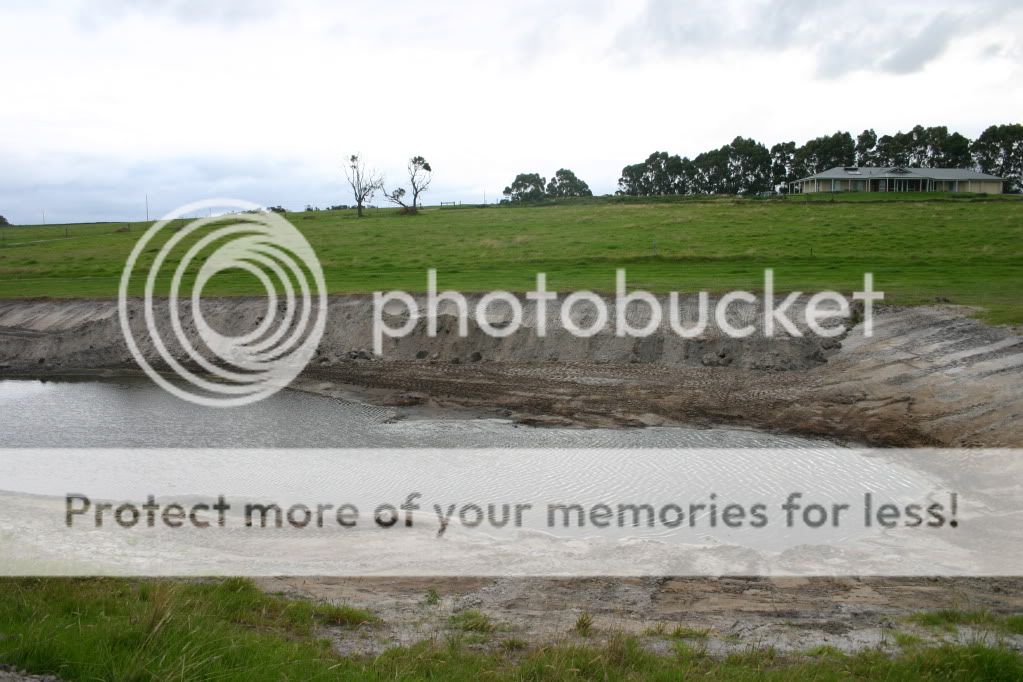

Cutting out the north end....

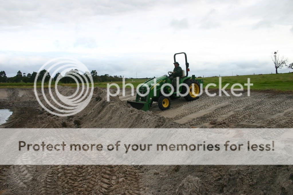

Getting some extra depth in and building top wall steeper & higher. Unfortunately have hit a rock ledge in top left corner, but we'll work around that.
Stockpiling soil ready to take around to front wall.
Finished job, on north end with water quickly filling in....cutting long side is next job...will keep u posted.

Hi pat32rt, soil on the farm varies a lot, ironstone cap with heavy underlying clay on the ridges - as where the house is = no water. hollows have a shallow growning zone of grey sandy loam maybe 1ft deep where grass grows, then deep white sand that bottoms out on what we call "coffee rock" (decaying ironstone), water usually follow over that hard surface, hence the need to get the cover off. evaporation is high in summer, but i have a 130ft deep bore that has a good constant supply of cool 12degree water that keep water temps down & allows fish to survive. we produce an average of 18 units of solar power per day, enough for us, farm & some excess to sell off. also solar hot water.

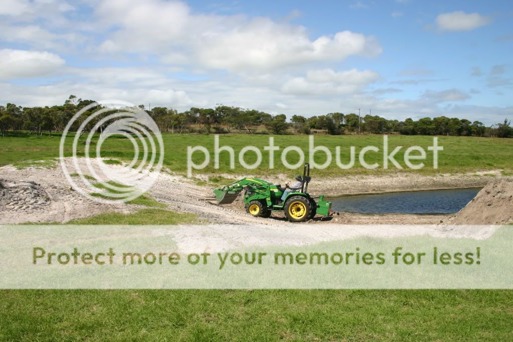

Now cutting the bank on the high side to get extra width and moving this fill around to heighten the front wall:-
Building the front wall up has its moments when backing along the bank & u feel a bit of slip in the fill!!
Progess as looking over the pond....still lot of fill needed...
Deepening of the other end will provide a lot of spoil.... should get that done next week.

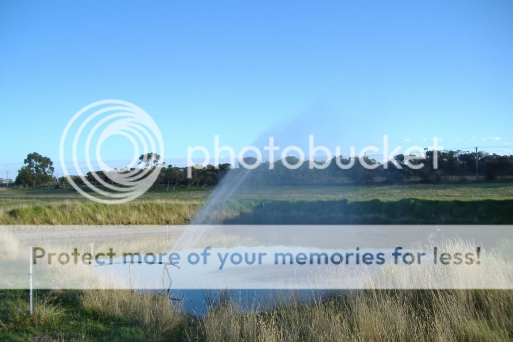

Hi Brandi, ur project has certainly been a journey 4 u, that little M tractor had a lot harder work to do with clay than my sandy soil. however ur clay will IMO when it settles down hold water well, i have to keep topping up thru summer here. we have 90,000lt rainwater tank and over 500sqm of roofing which produces about 3X water we need, so overflow from that tank plus a bore hooked to solar panels means water is not too much of an issue so far, but as ur finding, this is all a journey into the unknown, every pond is different.
