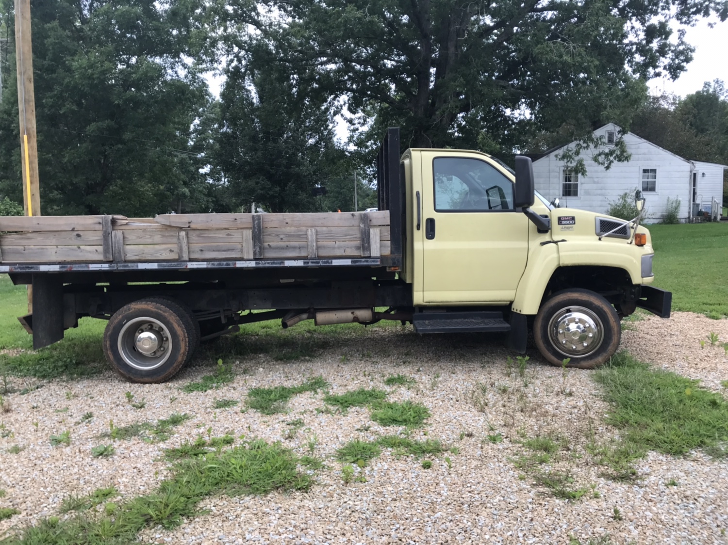

I wouldn’t want a dump trailer of that capacity anyway. A medium duty truck would be a lot more useful IMO. Here’s a truck I was looking at buying to add to my collection of 2 gravel bed dumps. It’s a 14” flat dump. The 5500 is quite a bit lighter than my 6500 dump truck but I would say it would still handle 7-8 tons. IMG_9017.JPG
