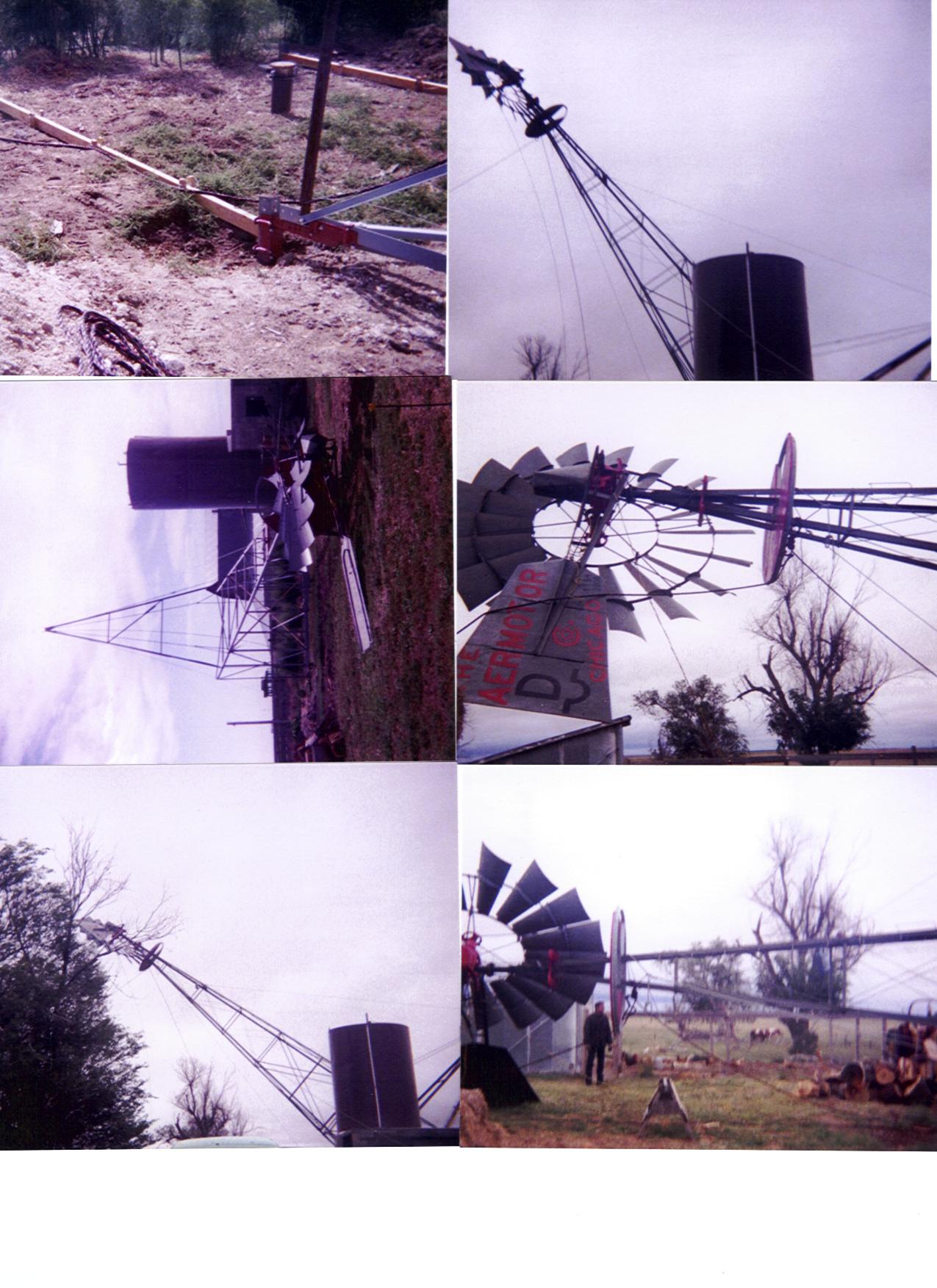

zzvyb6, does the windmill in the first picture work ok? I thought that windmills were suppose to be several hundred feet from anything tall like all those trees.
Just curious.

My windmills are placed in tree 'allys' that channel the air pretty well in an east/west direction. I'm not that 'thirsty', so a short dry spell for an hour or two is not a problem. And, mnay windmills had regulators on them to shut them down because of overfill conditions, especially for filling in-house tanks with a so-called 'suburban water system' (in house plumbing).
What's interesting to all of us and visitors is how the air can be quiet at the house and 100 yards away, the fan is on full governor (speed limited). And the other way around. Sometimes when you ae standing in a place that you can observe both mills, one is maxed out and the other is completely stopped.
They are 200 yards apart !
This 3rd one I have ready to raise is in the middle of an unused horse riding ring surounded by high trees near the barn. But you can feel the wind rush when standing on the platform. Its more for decoration than water supply. I have a hit-miss engine and a pump jack I want to hook up and demonstrate (without all the mess, so to speak).

I have two mills Aermotors, one a 10 foot and a 12 foot, 265 foot to water and 280 feet to water, one tower is 60 feet and one is 40 foot (no trees around it) both on steel factory towers,
I have seen towers made out of old drill pipe and other

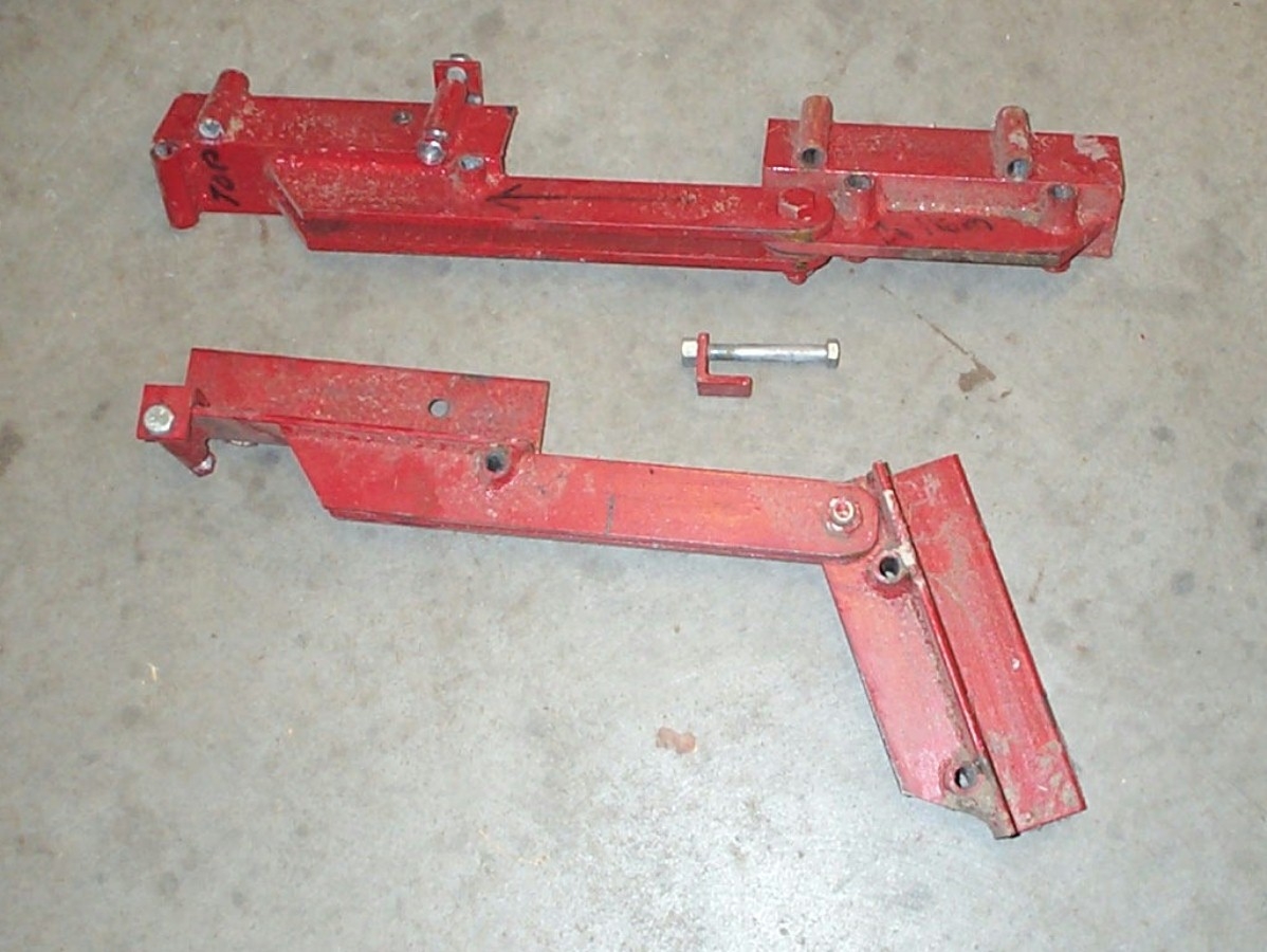

below are a few wood tower plans and some pictures of raising the 12 foot mill up I braced the lower section of the tower and used tower hinges, a picture of them as well I have a few other views of them if needed, (made them my self, the allow the tower to lap correctly, as it goes up,
