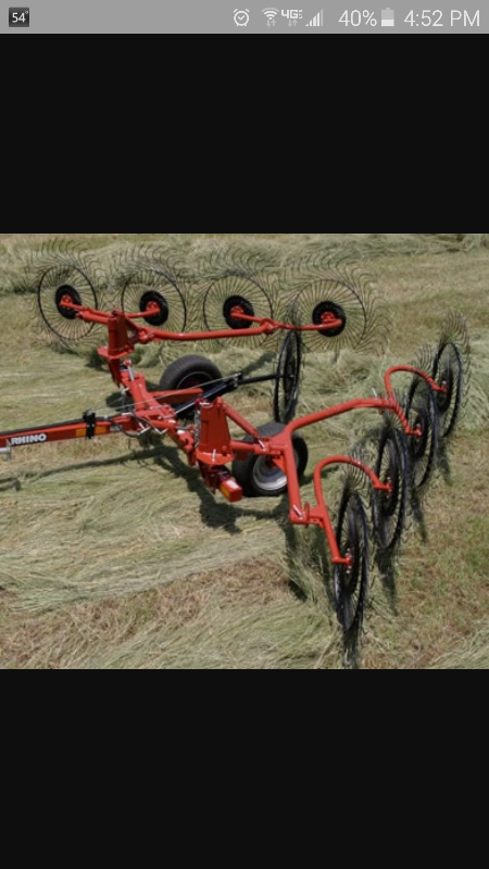

Hi
I been wondering for a long time how possible it would be to build my own hay rake. Looking at it I have 2 four wheel Hay rakes. Guess I could easily make up an axle and could purchase the hydraulics. The one question I have in my mind about doing this is how easy is it to flip te wheels on what would be the right hand side of the rake so make them rake as they should.
Anyone who has either tried or thought about this, your thoughts, help and opinions are much appreciated

This is what he is talking about

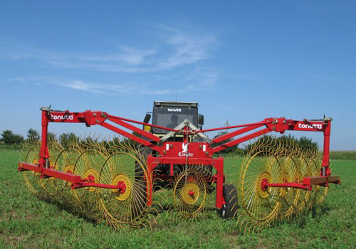

never ran a V rake before. let alone watch one. looked up a few on youtube. i came across a couple video's of complaints about the U shape frame that holds 2 of the tine wheels together. they were stating in heavier hay, the hay would all build up and clog up on the U. looking at some pictures. i started noticing "old v rakes" to newer V rakes. and more new V rakes (more expensive ones) each tine wheel had its own frame going to it.
i was scratching my head some to different styles of V rakes....
some had tine wheels "on the back side" so basically tires ran over the hay first, then the tines wheels would grab it all and move it into a wind row. ((would not matter tractor tires already run over the cut down hay to begin width))
--picture you are showing
the other V rake style. the tines were on the front side. so the tine wheels would grab it all and toss into a windrow in center. and THEN the tires would go over everything. i had a little issue on some of them ((the very center wheels)) almost seemed like they might flatten the outer edges of a windrow maybe?
you wanting to flip tires themselves to tine wheels....*scratches head* makes no sense to me. in how they are suppose to be.
some complaints about being able to control each wing of the V rake independently... (more hyd hoses / valves needed/wanted) more to do with rolling a windrow and grabbing another windrow you did not want to grab.
below picture from... 403 Forbidden
above is first V rake style setup. that had a combo of everything. and more likely fully adjustment of each wing and angle of it.
