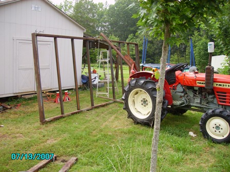

Been building a trailer , I am slow it is taking me a long time . May I will get it done one day.

Looks good so far. Are you using plans or just winging it? Why I ask is a employee of ours built a trailer and it looked great and towed awful. Getting the axles in the wrong spot can make it a hand full.
Chris.
   / building a trailer
I have some prints on some trailers I have had for years. I am using them, I have build a lot of trailers over the years. I am just slow at it now.

Just make the frame square and the suspension the same distance from the back on each side. Should pull smooth. You need to bias the axle (s) to the rear so the nose will have 15% of the load transfered to the truck. That makes it behave on the road.

I've built a couple and after I built my first one I learned to measure from the hitch to the spring mounts by measuring an arch from the center of the hitch that keeps the axle in correct track. this eliminates any error in frame.

Can you use that trailer on the highway just like that ?
Over here in Holland, all highway trailers above 750 kg total weight, need a license plate of their own, and need to have a type approval.
We cant get home built stuff on the road anymore.

Here in SC I don't need a inspection or a tag for it . not going to be that big of a load.
tommu56 what do you mean an arch from the center of the hitch.
