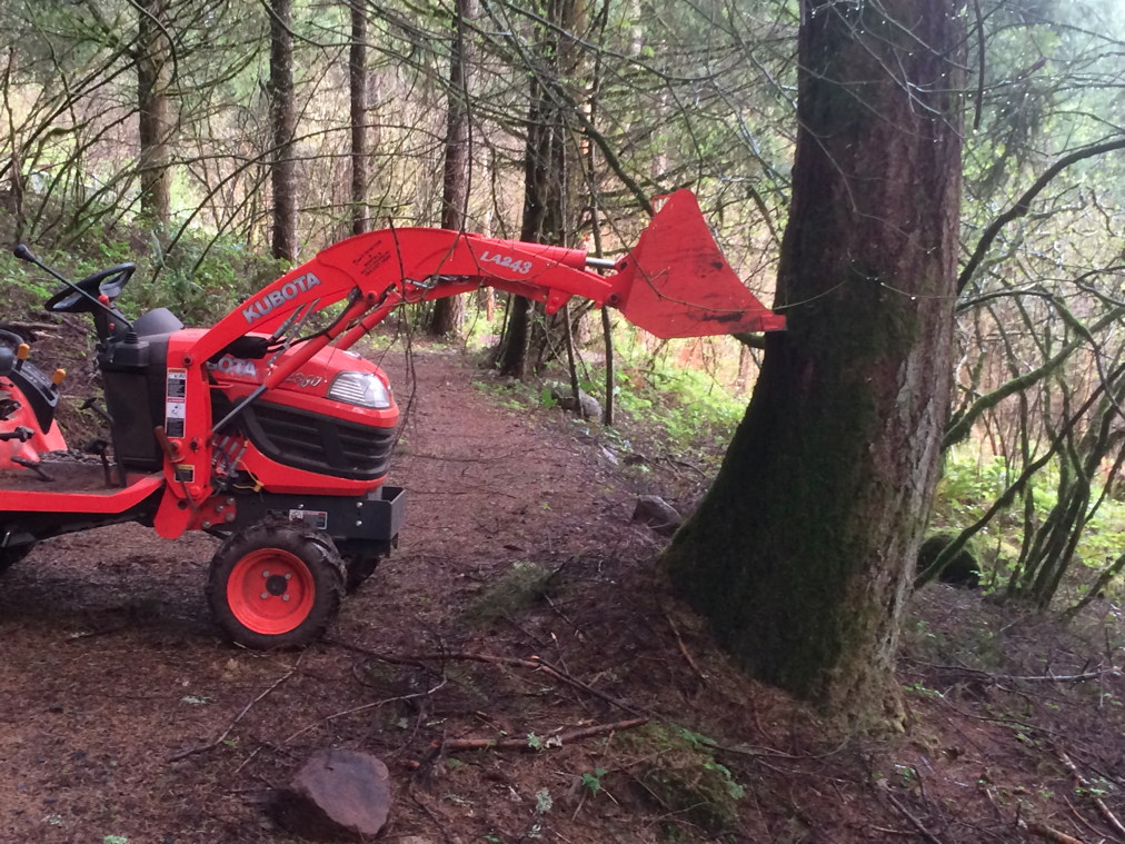

I built one using mainly the loader. Start by making a flat place to work from. I used a rototiller and shovel to make a tractor sized level spot. Then dig half a bucket from the hillside and dump it on the lower half of the road. Repeat until finished.
A toothbar was a major help. A boxblade helped to finish it, but not build it.
You can see part of it in the attached photo.
