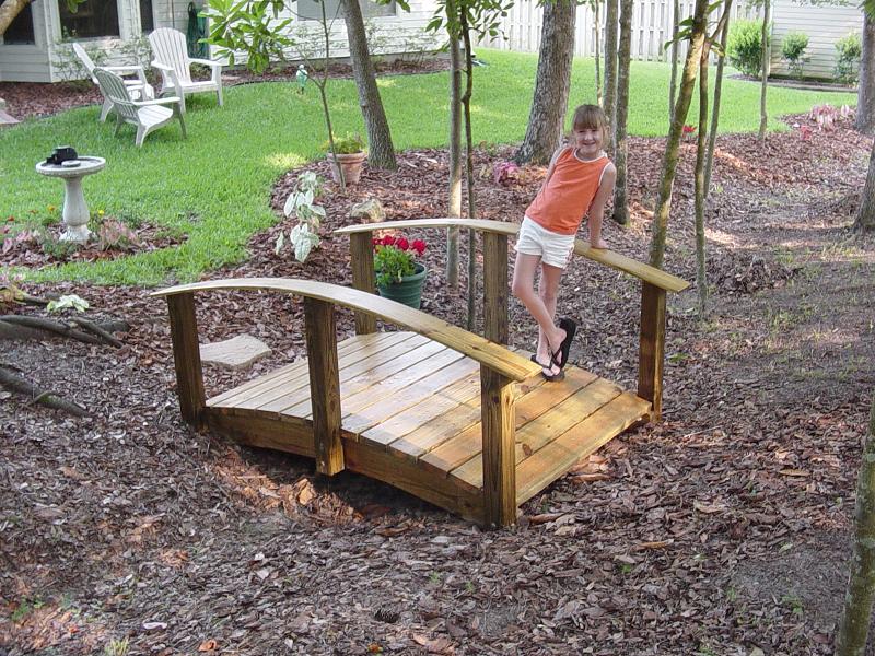

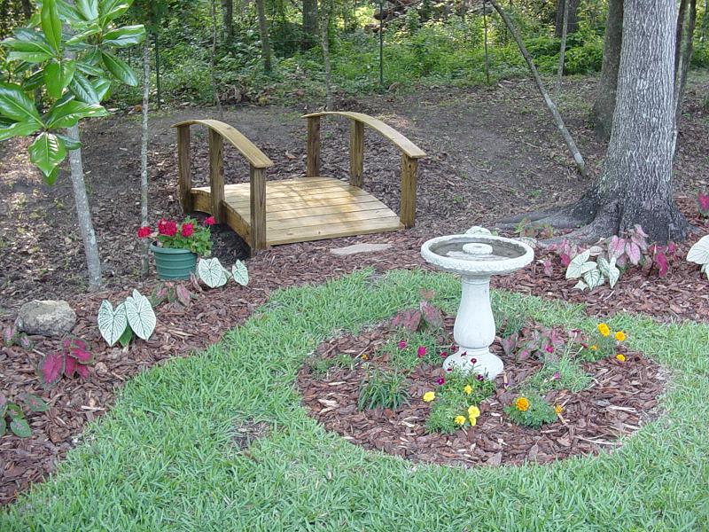

Here's a little foot bridge I made for my sister a few years ago - Ask questions if you have any. May be too permanent for your situation, though.

   / Building a temporary foot bridge over a small creek. #6
I was thinking the 2x10's and ply on top. But make sure you put a rug or better yet pre paint with the anti-skid (sand added) paint. If it gets wet people in dress shoes will go flying.
You could even paint it white to match the day.
I would then use 4x4's on the sides and 2x4 on top for a rail.
If bolted it could all be premade and taken apart easily.
