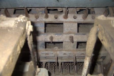

   / Building a small scale thresher #13
Taken from on top of the cylinder, I still think you'd be fine with just beater bars instead of toothed.

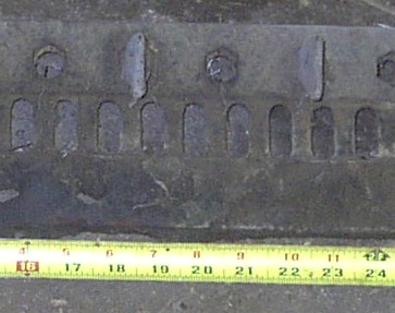

   / Building a small scale thresher #14
Close up of a concave, I think have it set with 3 concaves.
   / Building a small scale thresher #15
Wide view of concave; 32 inches wide. Thus, 32 inch machine; actually 32 X 48 [or is the separator end 44", dang absent mind...].

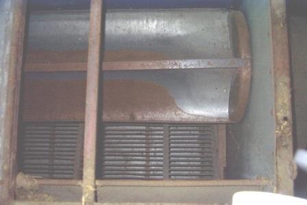

   / Building a small scale thresher #16
Immediately behind the cylinder is the primary sieve, if you made this long enough and wide enough [and fed slow enough], I don't think you'd need straw walkers.
   / Building a small scale thresher #17
The round thing in the sieve picure is neither the cylinder or anything related to it. I'm sure somebody is going to poke fun at me for not knowing the name, but it only helps direct the output from the cylinder, I really don't think your machine needs one. Again, I'm thinking you just need a really large [in both dimensions] primary seive to simplify much of your needs.
I'm thinking if you build the output side of the cylinder really high, wide, and long, it may make the rest simple. Then you can "funnel" the rest of the machine down into one or two smaller sieves and a fan.
Also, that 32 inch machine was considered pretty respectable in its day. A lot larger ones [and smaller ones too] were made, but this thing could keep four people pitching continously. Been over 5 years since I had it out, but I love watching city folk try to keep up with it [I don't laugh out loud to anyone though; you never know who was once a "country boy" and remembers how to slug a machine {make the cylinder bind}] /forums/images/graemlins/cool.gif

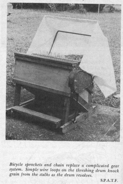

   / Building a small scale thresher #19
here are some pictures of a build it yourself thresher. Plans are available from
Intermidate Techonology Publications
9 King St
London WC2E 8HN England
They also have plans for many low tech rural implements.

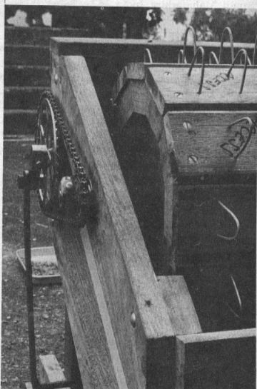

   / Building a small scale thresher #20
Another Picture.
Putting a box with differing screens(depending on size of grain) under it makes winnowing much easher.
