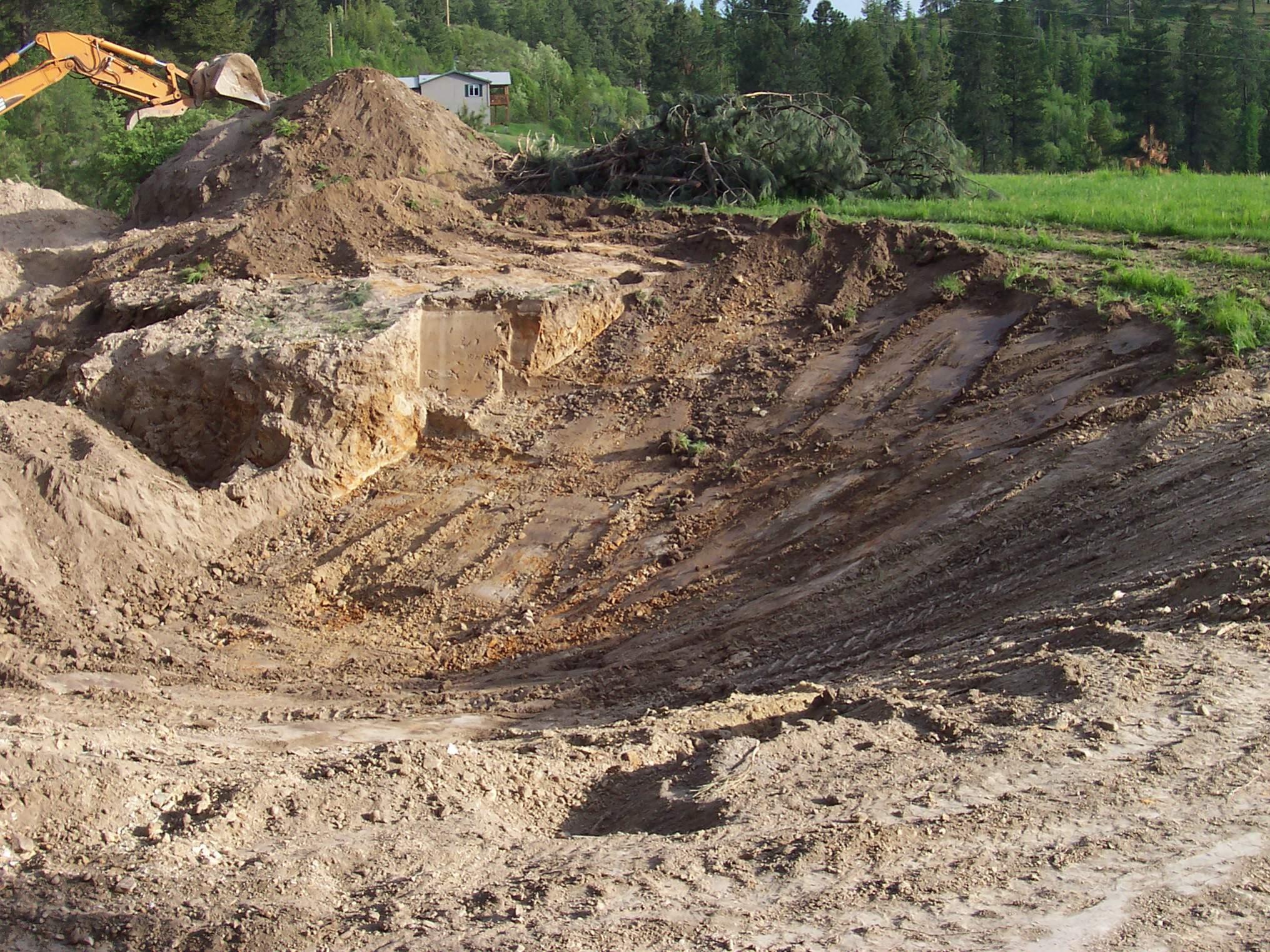

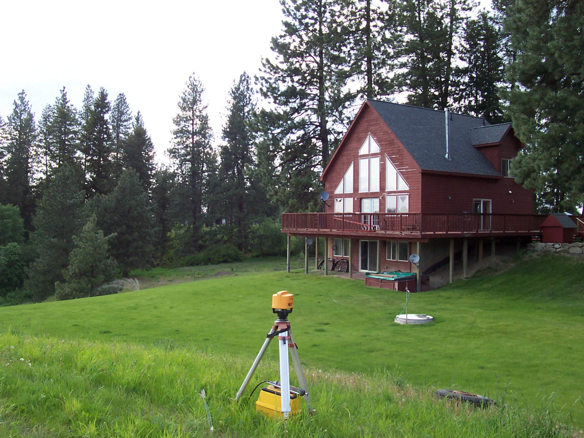

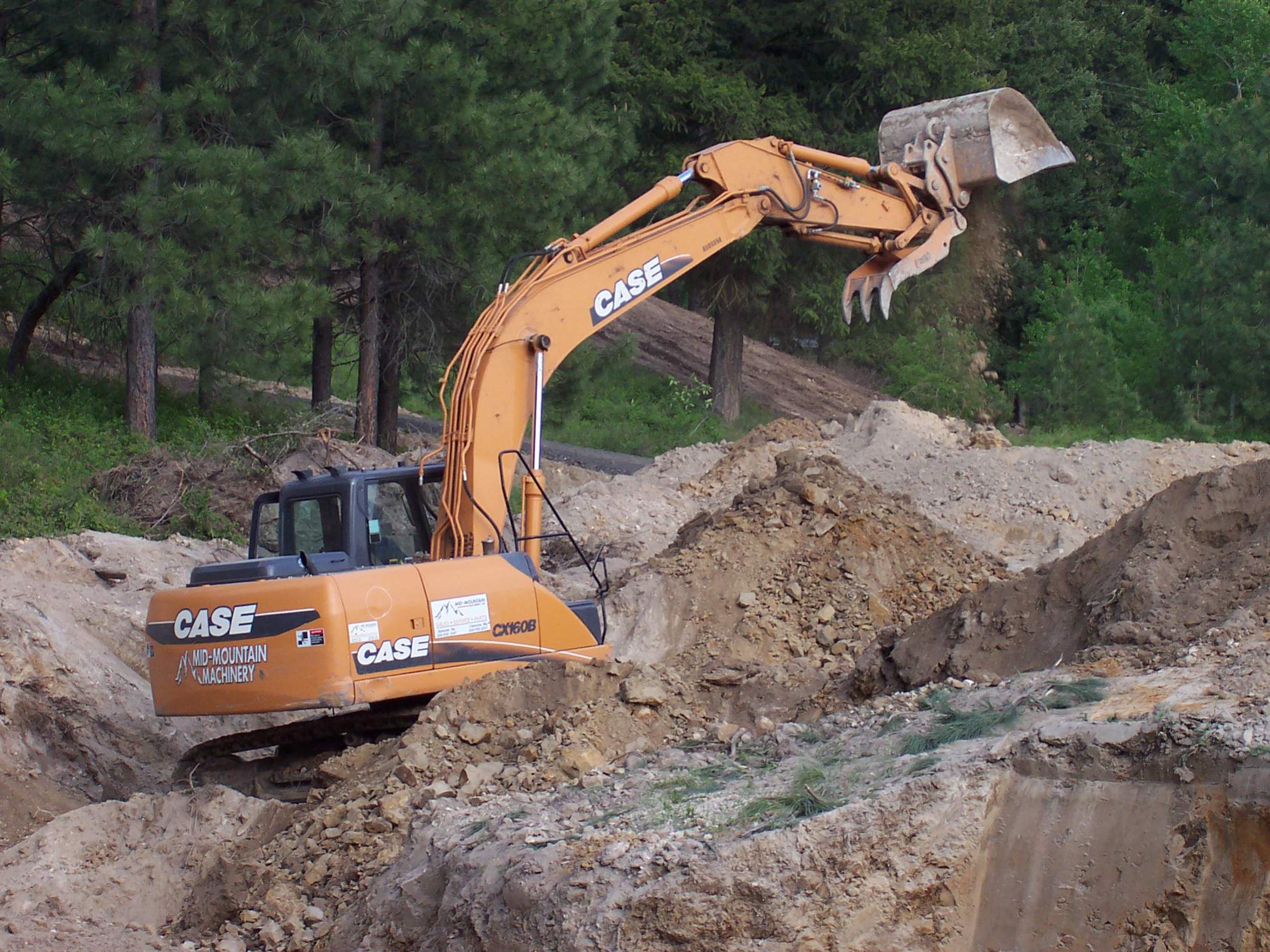

I have started building a pond on my property and wanted to share my progress. My pond will be about 25ft deep in the center. My plan is to build a creek that will recirculate the watr to keep it fresh. The pond will hold about 1.2 million gallons. Does anyone know how much mater I will need to circulate each hour to keep the water fresh? omh pro screen usa 4 10 2010 124.jpgomh pro screen usa 4 10 2010 120.jpgomh pro screen usa 4 10 2010 128.jpg

That looks like some nice sandy soil for easy digging but I doubt it would hold any water ,Are you planning on bringing in a few dozen loads of clay ? It looks pretty deep already with no ground water seen .

Most pond builder don't recommend more than about 12 feet of water depth with 6 feet of the water containing the most fish. As said the deeper water doesn't cycle much and can become O2 deficient so no fish can live in it, therefore if you get an inversion in the winter and the water "rolls over" then most if not all of your fish will die. You would be better to make it twice as large and half as deep.

You raising fish for sale, or just for recreational use? A decent size pond really does not need "fresh water" moving in and out of it for fish to survive for recreational uses. We have plenty of half acre and larger ponds that are only fed by runoff water and raise fish just fine. If you have water moving in and out from a stream, you may be introducing fertilizers and other things that are not helpful to your pond. Hopefully you have read some good books and such on pond building and fish management. Most soils slough off to a 2 to 1 or 3 to 1 slope after being saturated with water on the inside of the pond. If you want a 25 foot depth, then you need at least 150 feet width to achieve this. Good luck.
