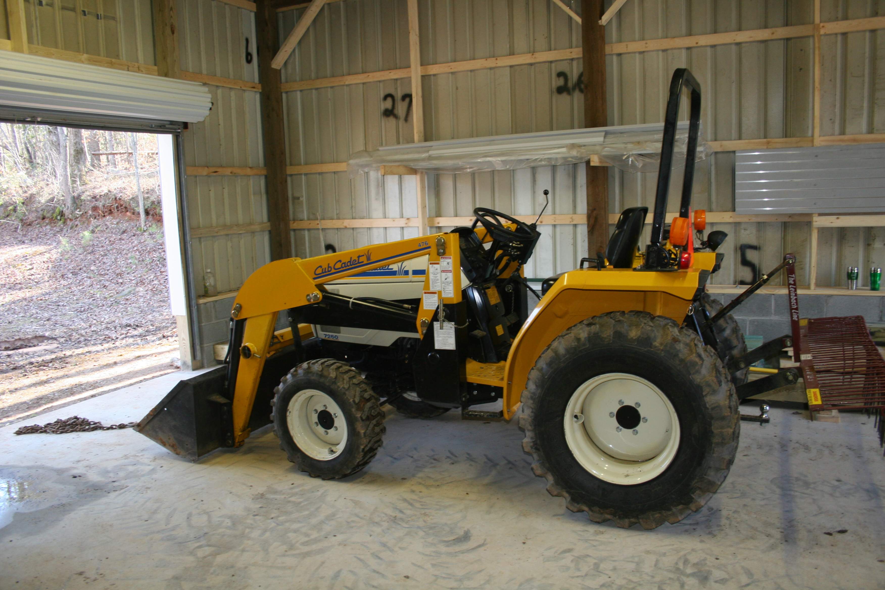

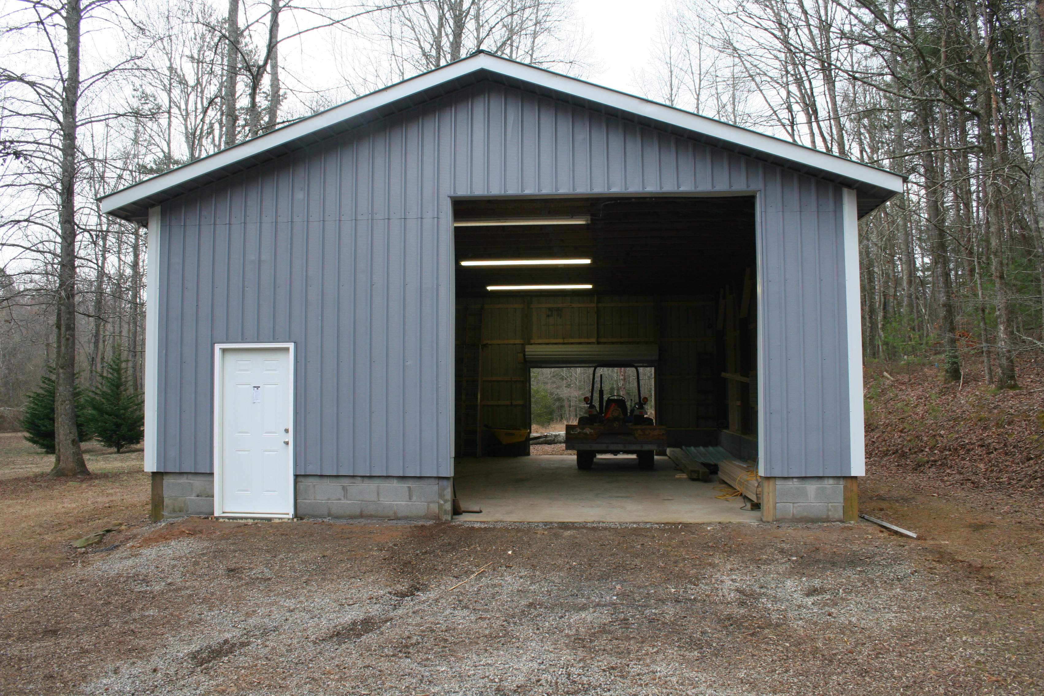

I built a barn last year and put Overhead Drum doors in the front and the back, best thing you can do for yourself.
Hold on there. New member, first post and only two pictures. What's the big idea? I need to see some more pictures of the inside of your building. Pole building with block base?
