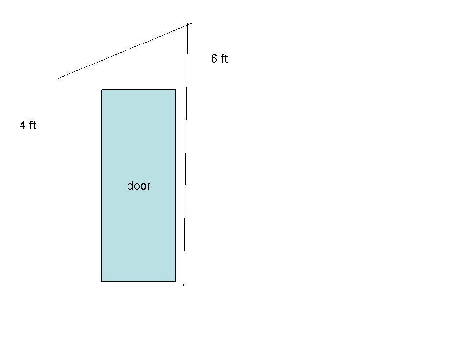

I had some rodent and other issues with bird this past year so I am going to do stuff a little different. I am going to use more portable pens and not
as big. When you brood birds you can only have 1 age group in with each
they will pick on each other if you try and do 2 different age groups. Espically game birds.
I have draw some stuff on powerpoint, do not have any other software.

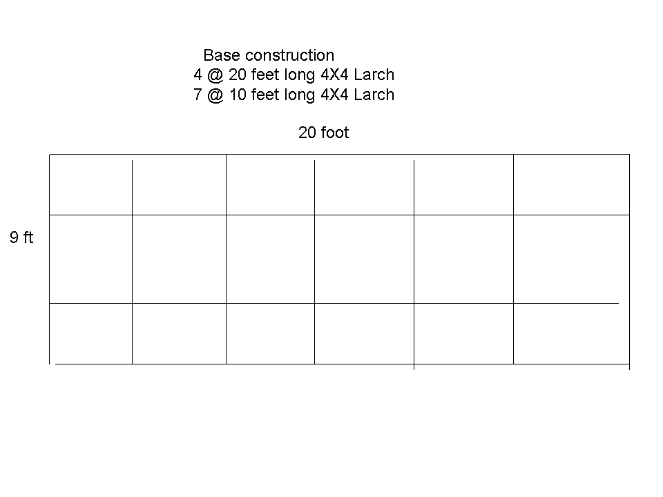

It will made with 4 20 ft larch 4 X 4 posts and 7 10 ft larch 4 X 4 posts.
The flooring will be welded wire 1 inch by 1/2 inch. Real stiff stuff.
20 foot long 9 feet wide. Height of building will be 4 ft one end 6 ft other end with metal roof. One door wood skirt 2 foot high 1/2 plywood keep the wind off birds and they will no panic as something approaches. The side will be chicken wire. It will have a metal roof with the height of the roof being 6 feet in one end and 4 in the other snow will come off pretty good.
When we build the base I will interlock the 4 X 4 the way we did with the frame for the other bird pens. shown in picture below I will ad a carriage bolt at each joint for added strength.
I am going to wire the building with three electric outlets and leave heat lamps plugged in so I can throw a switch from the outside. all I need do is run heavy duty lead cord to building and plu bulding in. At each corner
they will be some exposed wire and recall area so that the chukars or quail
can get back in the pen.
I will use 10 foot 2 X 4 for rafters that wall I will have a 6 inch over hang on each side. I plan on raising many of my own chukars this year and I figure
this pen will hold about 300 for while I can put the bird outside when they are about 6 weeks old with a roof I do not have to worry too much about the weather and heat lamps.
The supports for the wall will be about 5 foot on center and on the corners
and in the middle I will I will double my 2 X 4 and make my own 4 X 4. Rafters will have to rest on 2 X 6 more then likely held to gether with carriage bolts.
Will do all corners with carriage bolts when ever possible. I think so long as I even pressure I should be able to skid this any place I need.
Will use a PVC pipe the length of the pen will holes big enough for heads
of birds to drink and will elbow out a clean out and fill pipe. 6 inch should do.
I am sure I will change design as I go I generally due to problems.
1) The advantage to this design is I can use as a big recall pen.
2) I do not have to worry about having birds in the weather
3) Can make 2 for different age groups.
4) Can move then when I need them close to the house or in the field.
5) IF the pens are moved every so often the rodent problem will not
be as bad.
6) Having a roof saves for food and keeps birds out of rain and snow.

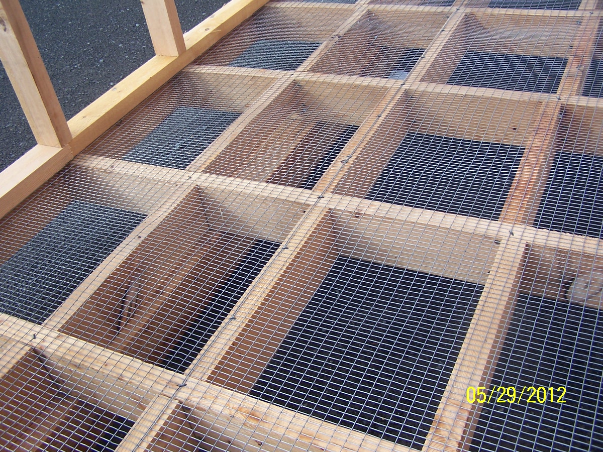

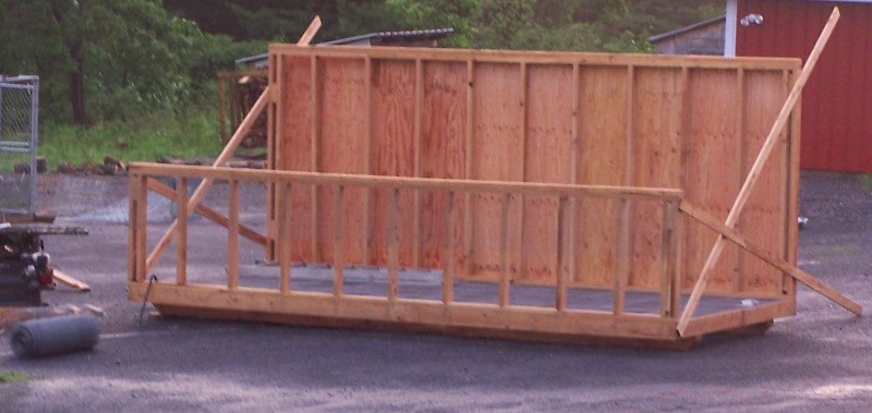

Well finally got the guys here to build the bird pen. I have got the amish doing it. I was a little worried first about how it would turn out but they are
doing a great job. Here is what is done on day one. They got a late start due to choirs and they do not observe daylight savings time.
Will get more shots of floor. I changed design a little I went with a solid wall of plywood on one side. And now it will have two doors. One to walk into
and the other to let birds into another pen. It will still have a two foot knee wall so birds can not see out of pen and will heard better.
Boy when those guys hammer a 4 inch nail they only bound it three times and it is like an airgun. but I think hand drove nails stay in better.
I think with pen I could in warmer weather brood birds in this and then just down the brooder part. When they are big enough they will get escorted to the big flight pens right next to this. It does not matter rain or shine I will be able to put birds in this pen. With the walls and roof.
Still will be skiddable.

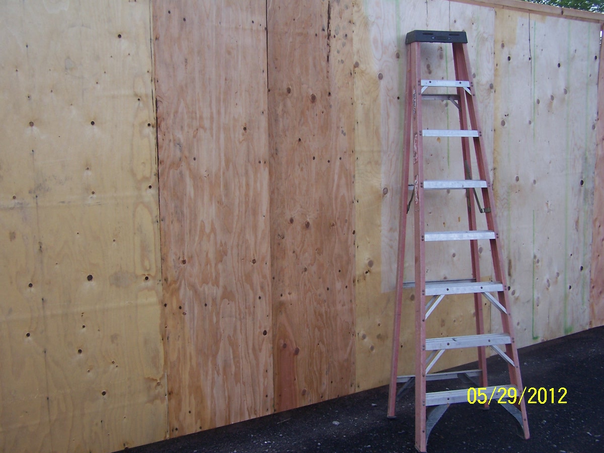

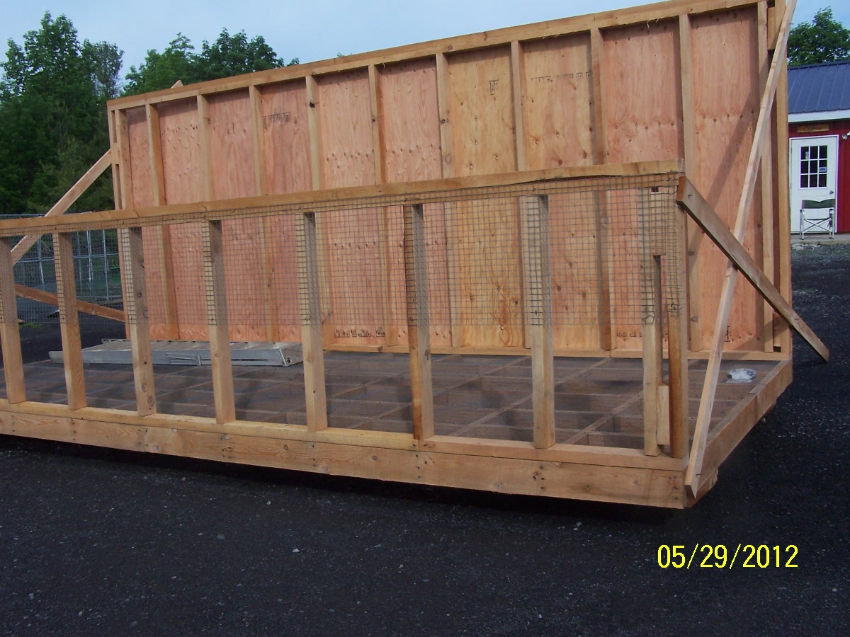

here are some more pics I took this morning
