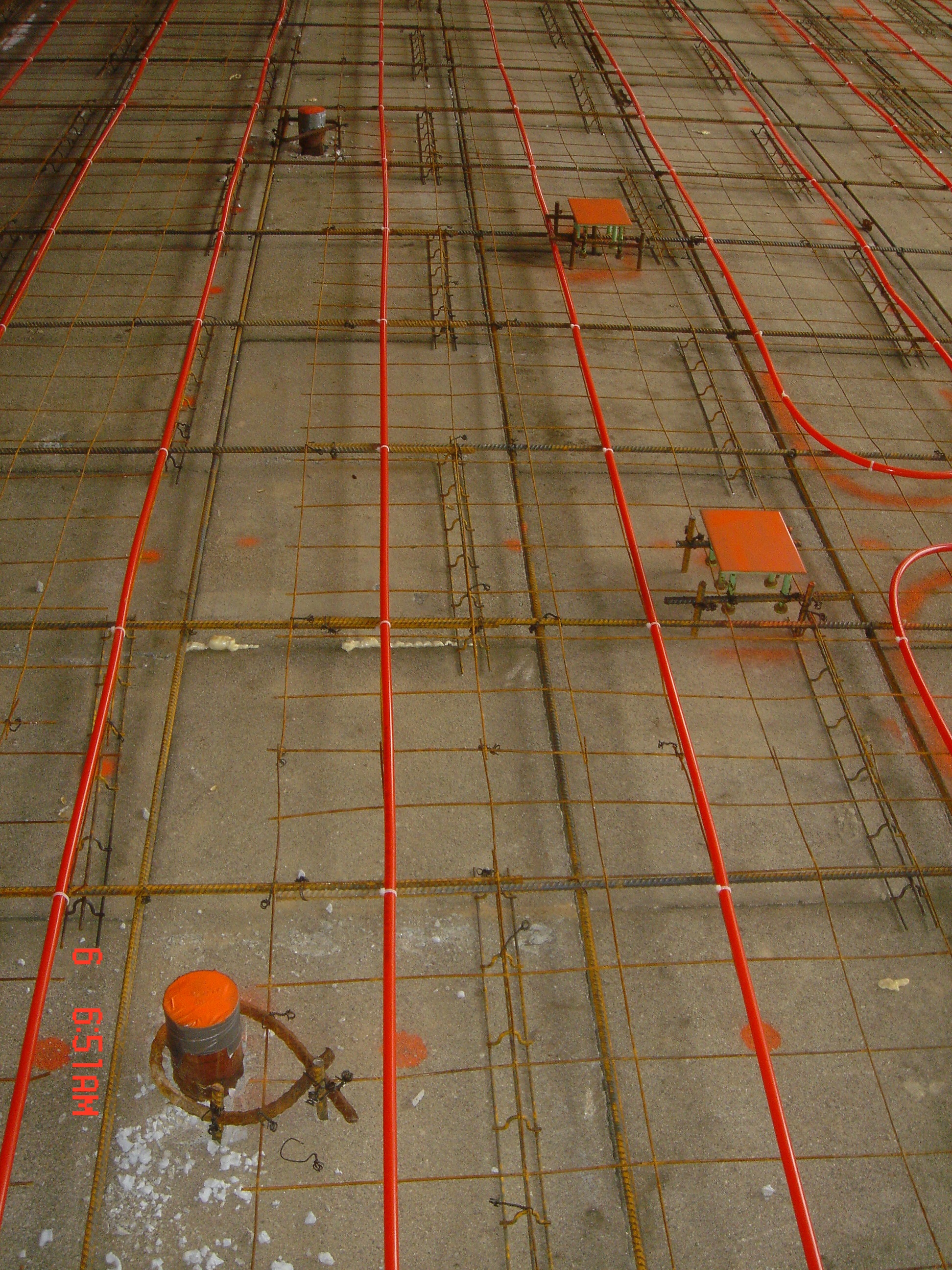

I embedded a 4' section of rr rail to be able to tack something down to it. I also put in some flat plates for this purpose.
Those round things are little chain pot's used in frame shops for an anchoring point for pulling. They have a little cap that closes it off. Not exactly a solution for what you are looking for, but the small plates might give you an idea.
