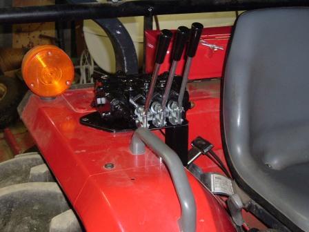

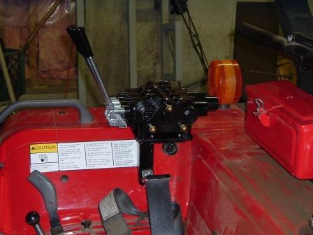

Here is the bracket I made for my valve. All bolt-together and it used existing holes in the fender.
   / Building a mounting bracket for a Prince SV valve
#9
DMF - nice looking bracket. Thanks for posting.
