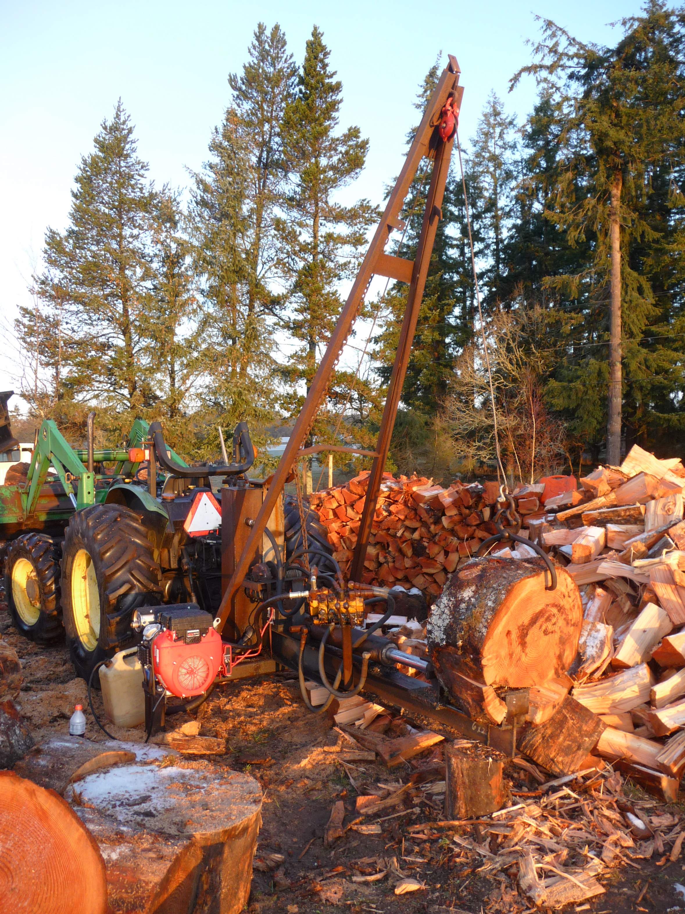

how many blades are you planning to put on it. This one works great with a 5 inch ram. As you can see it only takes two pieces off the bottom as you work the round. Because of the large difference in dia of the wood I cut I found this is the most effiecent way to get it done. this one will do about 2 cord an hour if you can keep the wood to it. It has a 7 sec cycle time, no matter what is in it. One stage pump 33 gpm, 24hp. If I were to split comercially, I would put an oil cooler on it, but for my home splitting it is fine. Just finished up splitting for a few years. Lot of blowdown last winter so it will be dry by the time it hits the stove.
