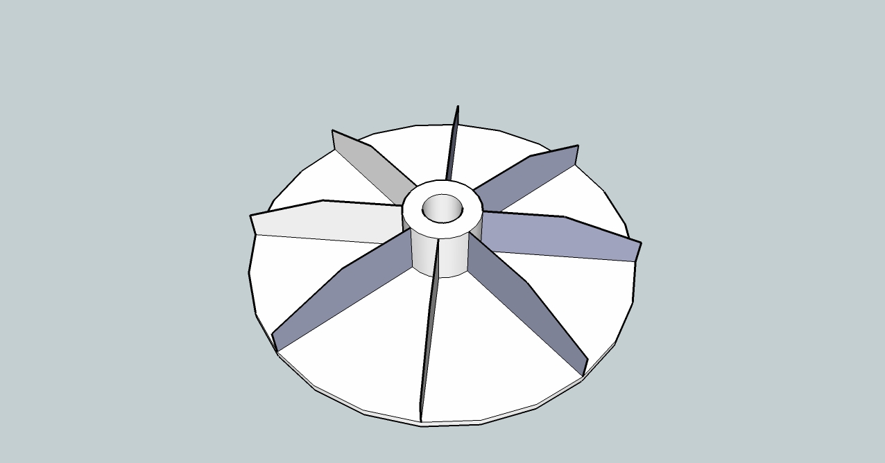

I have thought about the vac route, but I would rather have something that was ground powered instead of another engine. Although, I am starting to suspect that by the time I engineer a sweeper, I may as well have built the vac.
The thing that keeps stopping me on the vac is the impeller. I have not been able to find any good information on the design of it. From what I have seen, it is a pretty simple item. Basically, a round plate with a hub centered on it, with flat vanes radiating out from the hub to the edge of the plate. Usually, the outside corner of the vanes are clipped.
Should these radiate out at a right angle to the center, or should they angle?
I am attaching a quick drawing of what I have figured out from others.

You would be much happier with a vacuum attachment that sucks the clippings, leaves, acorns, needles, dog poop, newspapers and pop bottles all up and blows them into a small trailer. The trailers can be a childs wagon with plywood sides even. The hose is all you would need to buy. You could even use a piece of flexible plastic drain pipe. Get an old gas motor, make an impeller out of soft steel. six blades. A housing out of sheet steel and bingo. Worked for me Eventually I would up with a new Honda motor, a 12" flex pipe, and an Agrifab garden trailer that I enclosed. Hooks onto my 72" mower deck. Fab or buy the connector to the mower deck.
Do you have any pics of your blower how you made it?
Soft steel can you elaborate on this subject please?
