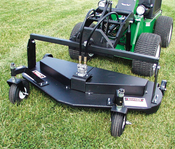

I know the smaller PowerTrac mower decks are driven by a hyd motor, about a 3 cu in, that turn three pulleys. Either a 48 in or a 60 in deck.
They also use a 48 in brush mower with a single spindle, swinging two blades.
The PTO about 8 GPM to the hyd motor. .

If you want to do the less money route, then find yourself the best deck your machine can handle, and compute the hyd requirement and turn the three spindles with a single hyd motor.
The 48 in hyd deck from PT is about $1300
The 60 in hyd deck about $1500
