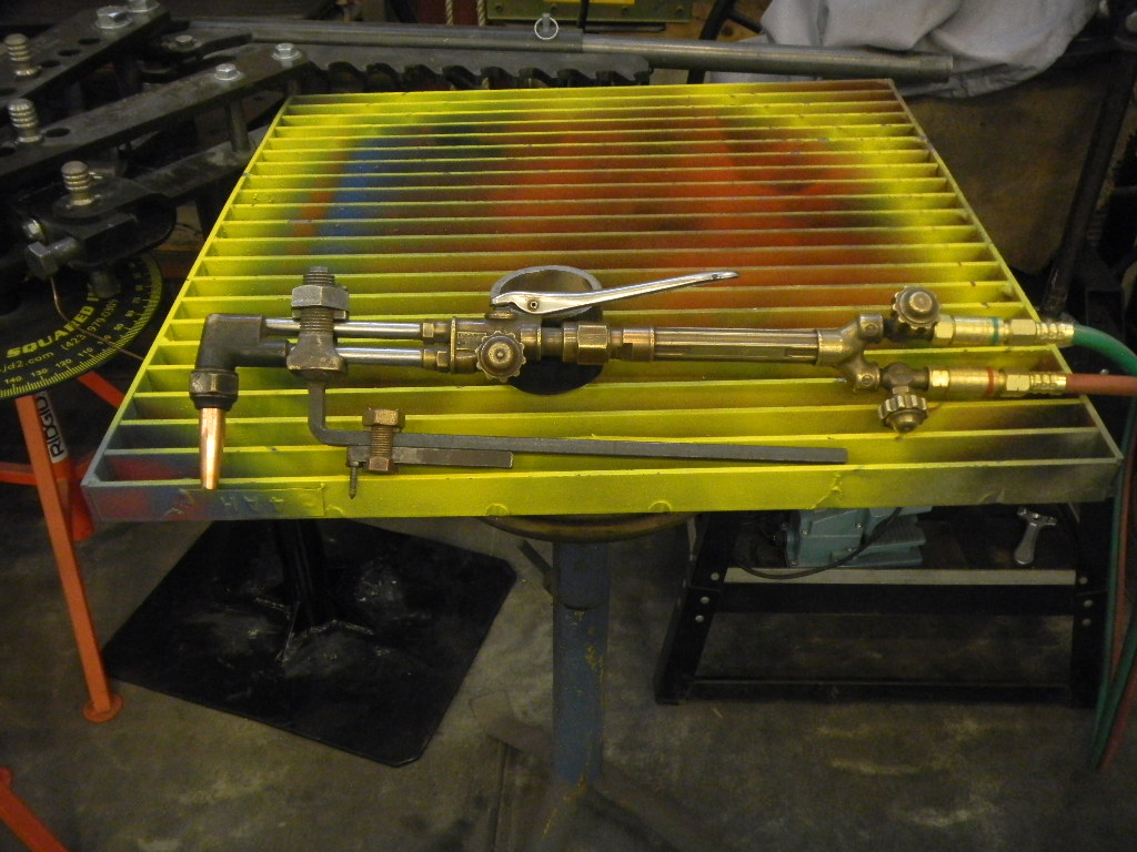

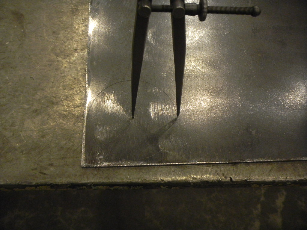

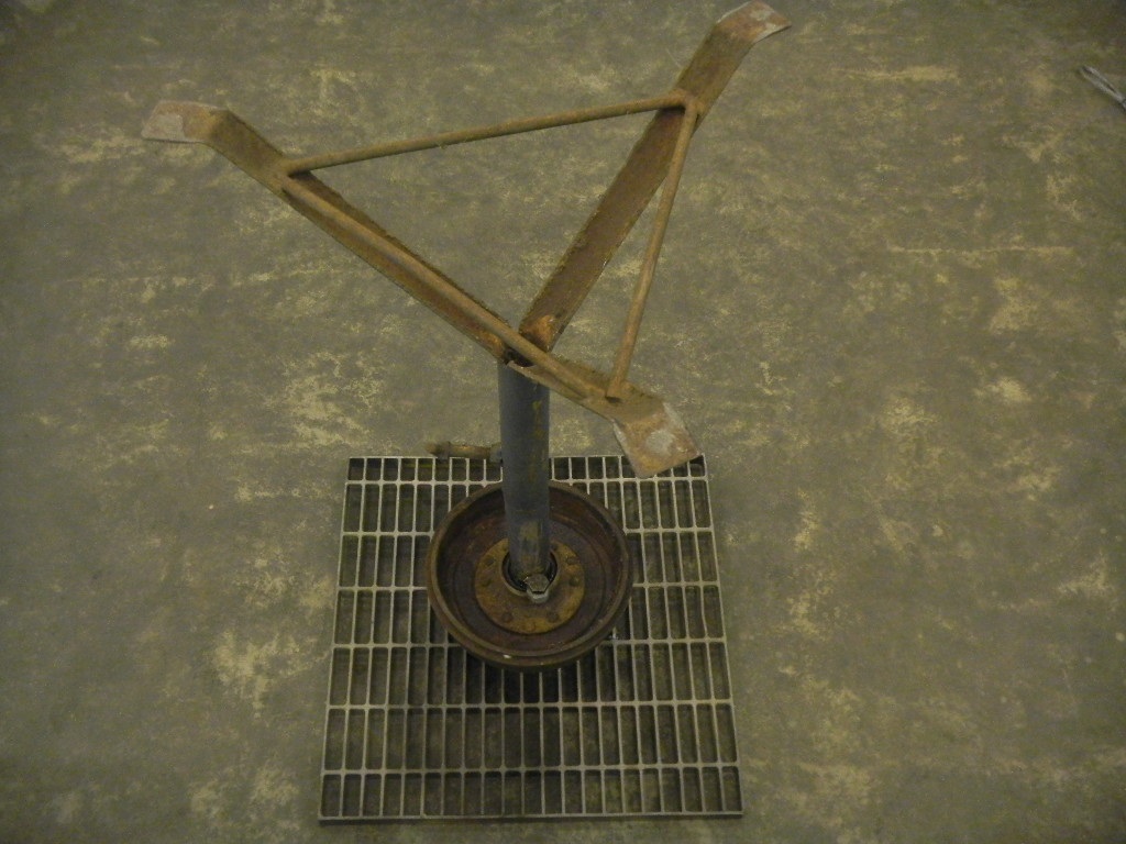

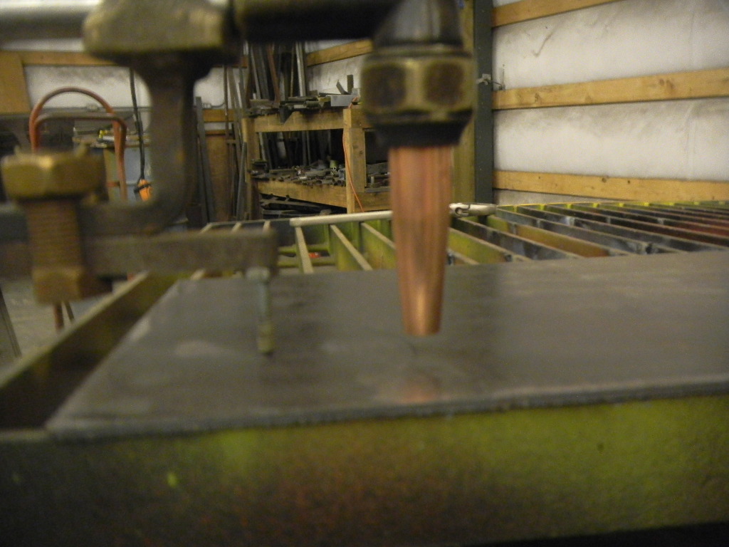

Jess if you are going to cut a lot of circles. Maybe think about building a rotating table, and circle burner. Take an old hub, and some grating for the rotating table. You can buy, or build the circle attachment that goes on the torch.
   / Building a Hay Spear
I've been needing to build or by one for a while now. I just haven't broke down and got one yet. Thanks!

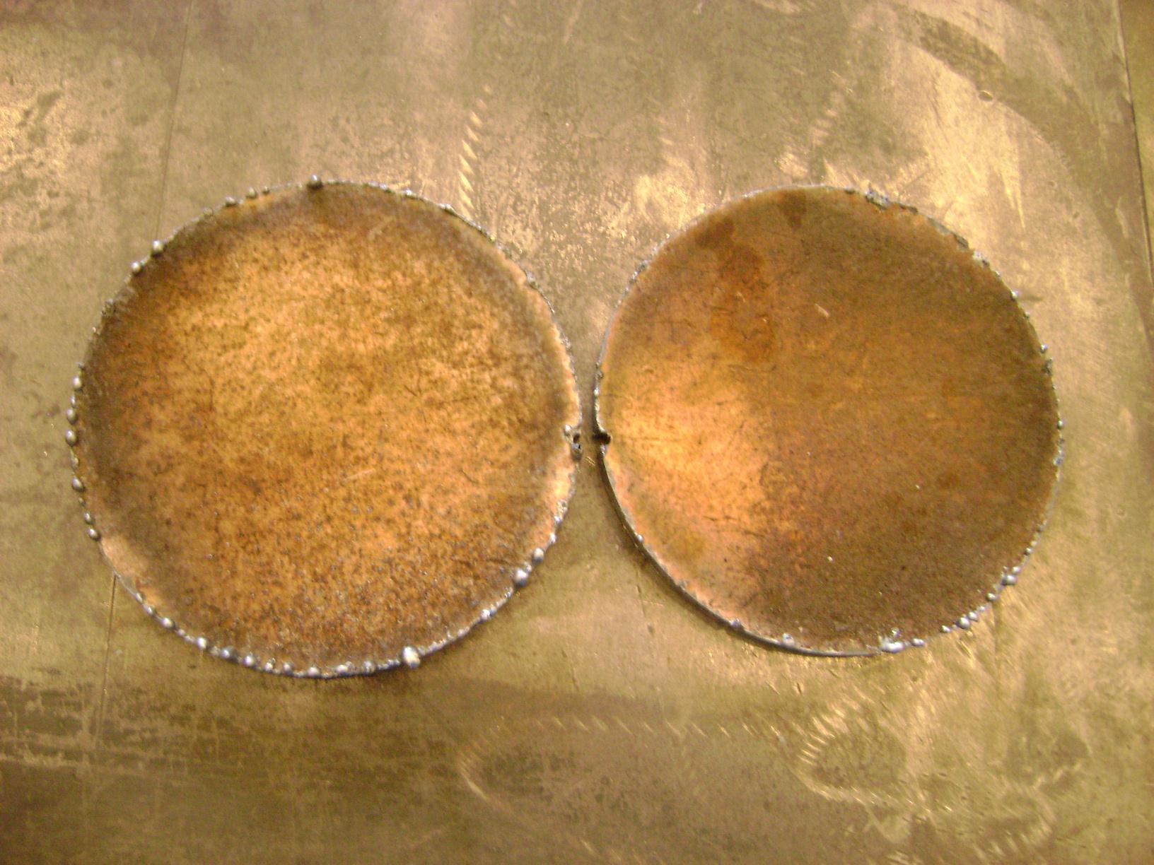

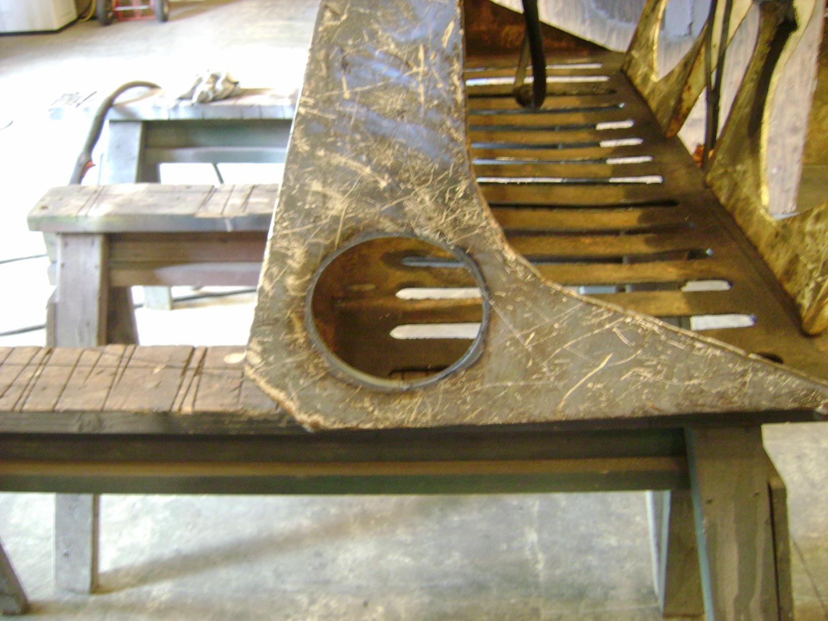

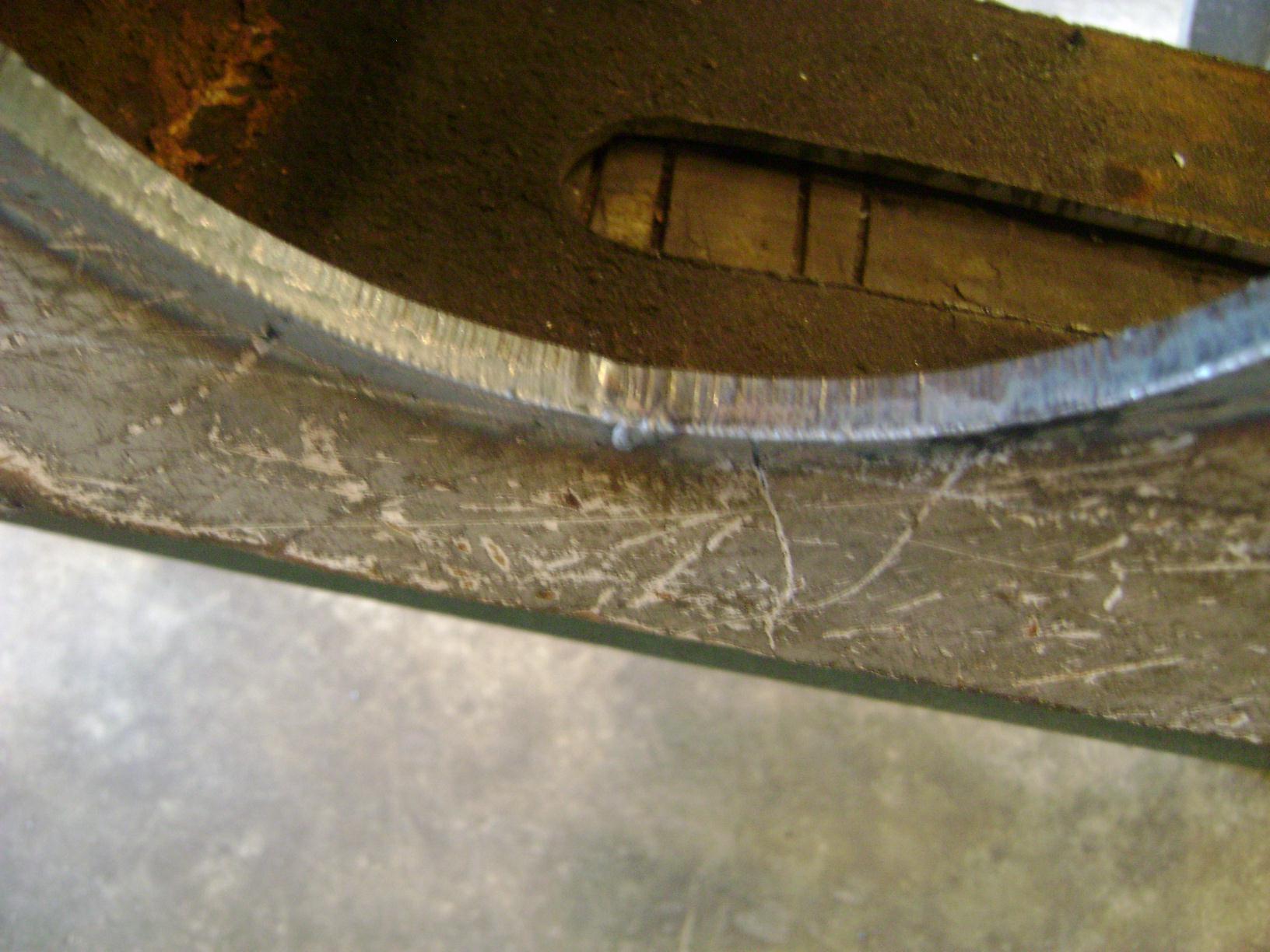

They do make it easy to cut nice circles. :thumbsup:
